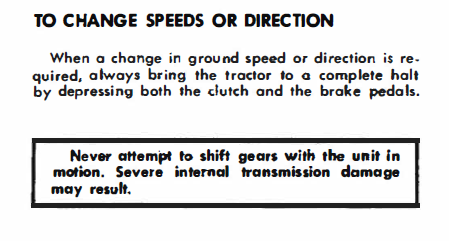

rmaynard 16,290 #10 Posted February 19, 2021 44 minutes ago, Playchess said: If that's the case, then when going down a hill I will have to push both pedals down to change gears? This is a little weird. Gears should never be changed while the tractor is in motion. Here is a cut from my 8-speed owners manual 2 2 Share this post Link to post Share on other sites

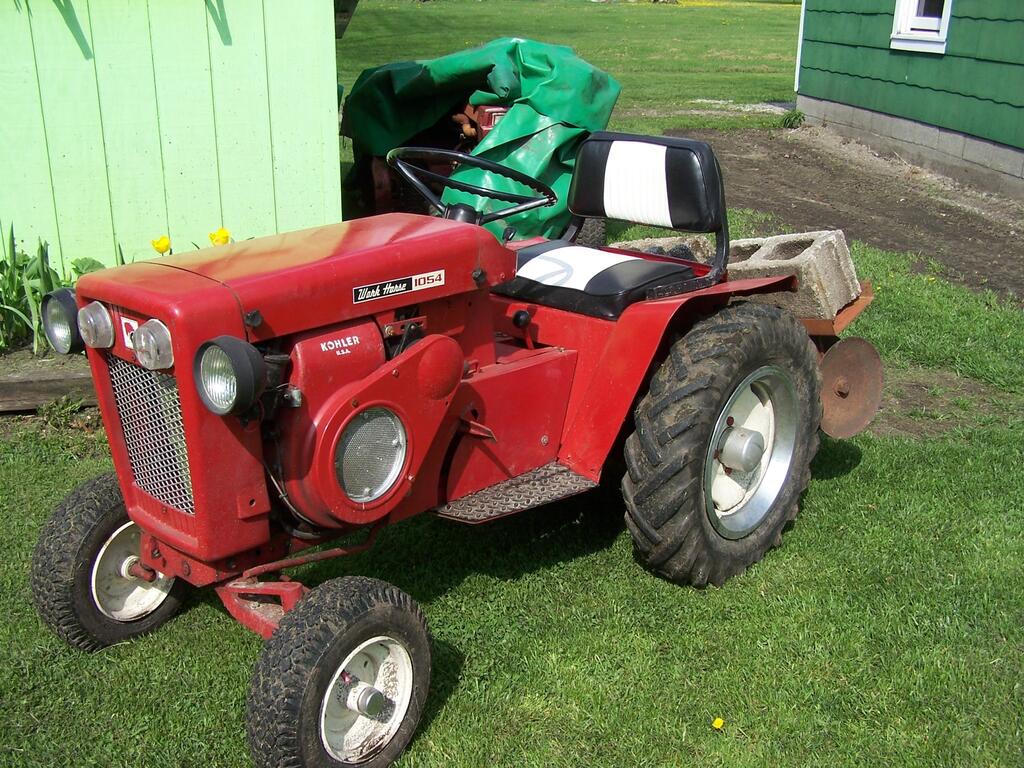

Lane Ranger 11,394 #12 Posted February 19, 2021 22 hours ago, Playchess said: Hi Folks, I have a 5053 transmission with old style rails. I took it apart. Have the original spring, detent, and balls. They came out of it but....... during the rebuild the ball keeps flying around the shop every time I try to press it into its passageway. My cat is blind now. I saw someone here, years ago, recommended chopsticks, and another said use a 7/32 (? I think) T handle allen wrench. Does any of this really work?? This task seems impossible. Any tricks? The chopsticks idea was my mother’s which we used on a 1054 Wheel Horse transmission rebuilt! It worked great! You can put a dab of peanut butter on the end of chopstick and push it in detention hole. Then push down the shift rail. Breaking the chopstick is no problem! 5 Share this post Link to post Share on other sites
