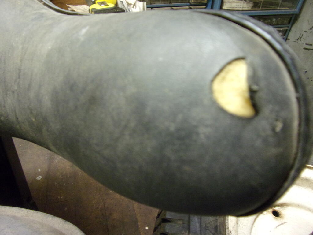

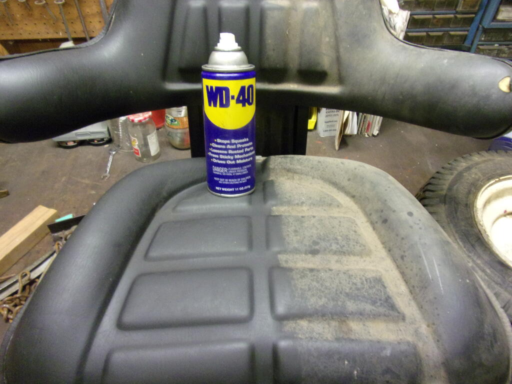

Ed Kennell 47,119 #1 Posted February 17, 2021 I picked up this TSC suspension seat for cheap. Looks like it will clean up, but has one small tear. Any ideas for repairing the hole? 1 2 Share this post Link to post Share on other sites

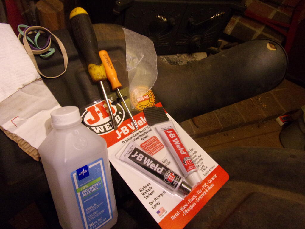

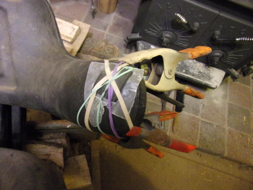

Ed Kennell 47,119 #7 Posted February 18, 2021 I'm thinking of mixing some black JB Weld , working it under the edges and covering the hole. Thoughts? 1 Share this post Link to post Share on other sites
DennisThornton 4,773 #8 Posted February 18, 2021 Vinyl repairs can work on good vinyl that is still flexible and only tore because of something out of the ordinary or was cut. Won't work on old brittle vinyl that is falling apart. It's best to glue in some support behind the repair. If you were to 2 step this with a backup and let dry, then glue down the tear, if that is a lip of the vinyl I'm seeing, and if you can tolerate seeing just the torn edge, you might have a long lasting repair. If the edges still bother you then you could try one of the vinyl repair kits. Glue and heat kits, your mileage will vary with your skill set. 2 1 Share this post Link to post Share on other sites

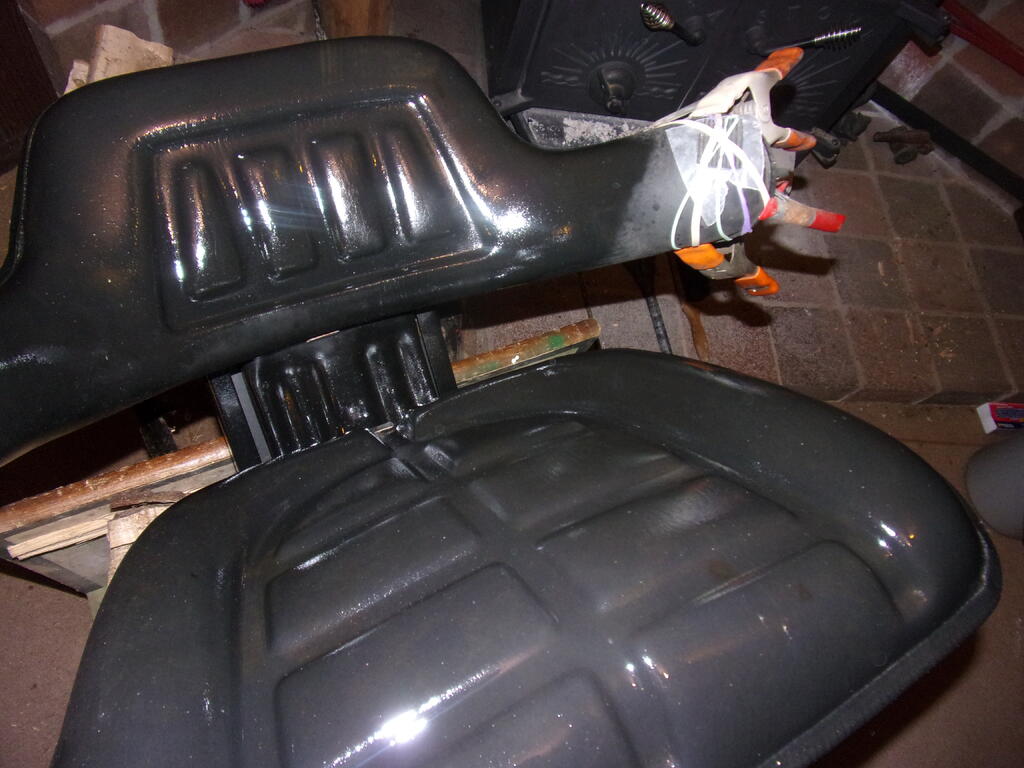

Ed Kennell 47,119 #12 Posted February 18, 2021 I just bough it yesterday Dennis. It was dirty, but the vinyl seems pretty pliable. I just finished the JB repair. I'll see what I have tomorrow after it cures. 1 Share this post Link to post Share on other sites
DennisThornton 4,773 #13 Posted February 18, 2021 5 minutes ago, Ed Kennell said: I just bough it yesterday Dennis. It was dirty, but the vinyl seems pretty pliable. I just finished the JB repair. I'll see what I have tomorrow after it cures. Oh man! I thought you meant the JB Vinyl repair! Share this post Link to post Share on other sites
WVHillbilly520H 10,379 #14 Posted February 18, 2021 1 minute ago, DennisThornton said: Oh man! I thought you meant the JB Vinyl repair! @Ed Kennell, that may be a bit to brittle for that application but I trust your engineering knowledge to pull this off. 1 Share this post Link to post Share on other sites
Ed Kennell 47,119 #15 Posted February 18, 2021 Brittle was a concern Jeff, but this is what I had in stock and the repaired hole is very small and there should be no flexing in this area. We shall see. 2 Share this post Link to post Share on other sites
