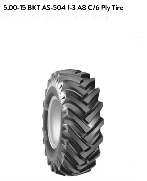

Oldskool 6,678 #101 Posted February 22, 2021 I've been looking at these. At the moment I'm thinking duals with a 2in spacing. They are about 26in tall. Any thoughts?? 1 Share this post Link to post Share on other sites
SylvanLakeWH 32,341 #102 Posted February 22, 2021 Should look great! 1 Share this post Link to post Share on other sites
DennisThornton 4,773 #103 Posted February 22, 2021 Why? Over the years I've gone from, "OMG! I have to have a set!" to "Why?". Share this post Link to post Share on other sites
Oldskool 6,678 #104 Posted February 22, 2021 37 minutes ago, DennisThornton said: Why? Over the years I've gone from, "OMG! I have to have a set!" to "Why?". As far as tire purchase goes I can buy 4 of those for a bit less then what I can buy 2 wider ones for. For use well I'm sure 4 work as well as 2 in cases and vise versa. Share this post Link to post Share on other sites
DennisThornton 4,773 #105 Posted February 22, 2021 16 minutes ago, Oldskool said: As far as tire purchase goes I can buy 4 of those for a bit less then what I can buy 2 wider ones for. For use well I'm sure 4 work as well as 2 in cases and vise versa. Wasn't fully processing... You showed a picture of narrow tires didn't you. Ok, so another interesting thought. Are narrow duals better than one wide tire? Tracks vs wide tires... Floatation vs digging in... Don't know... But now I like where you are going. Should look good AND I think work good, too! But darn! That just might put dual rears back on my list! 1 1 Share this post Link to post Share on other sites
Oldskool 6,678 #106 Posted February 22, 2021 52 minutes ago, DennisThornton said: Wasn't fully processing... You showed a picture of narrow tires didn't you. Ok, so another interesting thought. Are narrow duals better than one wide tire? Tracks vs wide tires... Floatation vs digging in... Don't know... But now I like where you are going. Should look good AND I think work good, too! But darn! That just might put dual rears back on my list! Yes they are narrow, 5in. I think it all comes down to use and conditions on the duals or wide question. For what I'm looking to do I think duals will be best. I know there is the old saying "Form follows function". With that being said i cant seem to find the exact front tire I'm looking for. Share this post Link to post Share on other sites

ebinmaine 80,485 #111 Posted February 22, 2021 As long as you remember to keep your outside set of duels at a lower air pressure you should do well with those. What size and type of fronts are we looking for? 1 Share this post Link to post Share on other sites
