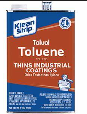

Zeek 2,286 #6 Posted February 14, 2021 I use a heat gun to get the vinyl off and then Toluene (Lowes) to take the adhesive off. Xylene works too. Quicker dry means less damage to under surface, if any. I use it to wipe stuff pre-paint so there is no orange peel. 2 1 Share this post Link to post Share on other sites
