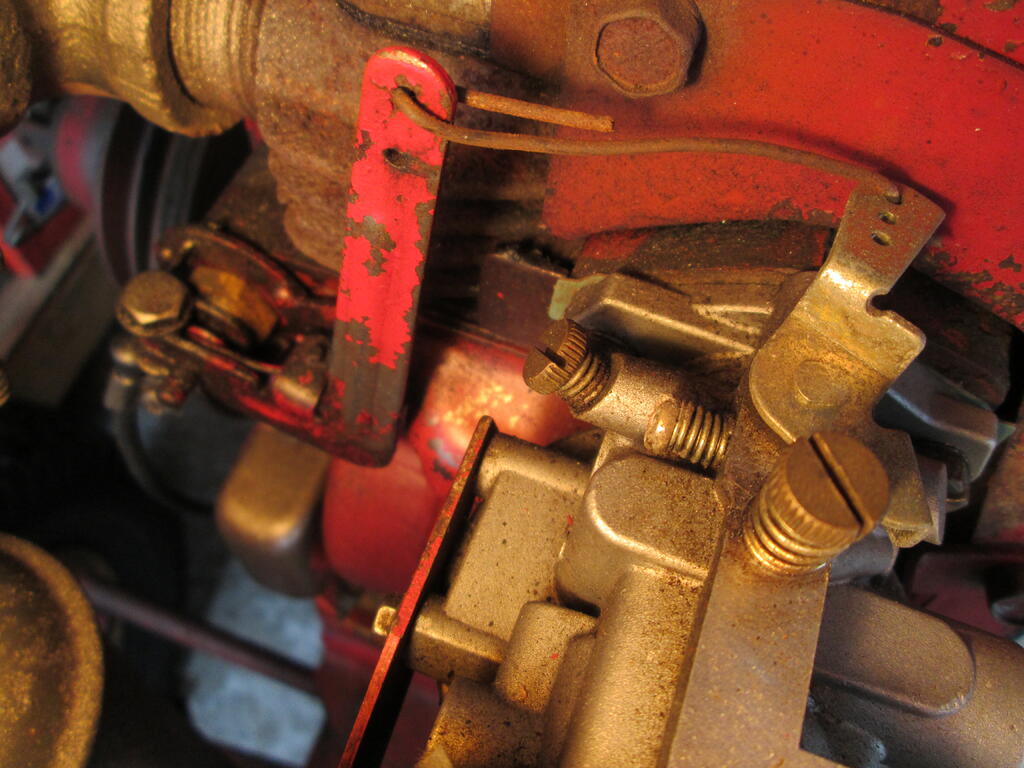

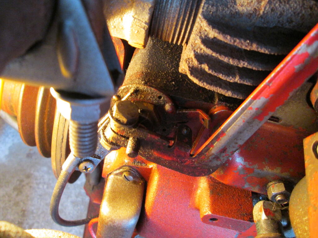

Retired Wrencher 7,041 #30 Posted February 13, 2021 22 hours ago, AHS said: Yup, mine pretty much looks the same as yours! @Retierd Wrencher mines an 8 speed. Hey take a picture of your gov. to throttle linkage. The only issue I have is a hi speed issue. Surging. The carb was off when I got it. It runs great until I have it full throttle. Will do. Mine surges a little. At a mid to high speed slow adjust the high speed jet for best results. 1 Share this post Link to post Share on other sites
Retired Wrencher 7,041 #31 Posted February 13, 2021 12 hours ago, AHS said: The carb was off when I got it. I rebuilt it and put on new carb gasket. I put on new coil, points, condenser, spark plug wire and spark plug. When I start it, it takes less than 5 seconds on the key switch, and it is started! I found cranking and sliding down and the choke it starts faster this way. I will get those picks out today. 1 Share this post Link to post Share on other sites
Retired Wrencher 7,041 #32 Posted February 13, 2021 On 2/12/2021 at 9:11 AM, AHS said: Yup, mine pretty much looks the same as yours! @Retierd Wrencher mines an 8 speed. Hey take a picture of your gov. to throttle linkage. The only issue I have is a hi speed issue. Surging. The carb was off when I got it. It runs great until I have it full throttle. AHS: This is what I have. Original except rod from gov arm to carb. Hope this helps. 1 Share this post Link to post Share on other sites
Handy Don 17,708 #33 Posted February 13, 2021 2 hours ago, Retierd Wrencher said: AHS: This is what I have. Original except rod from gov arm to carb. Hope this helps. I LOVE that highly engineered replacement linkage! 1 Share this post Link to post Share on other sites
