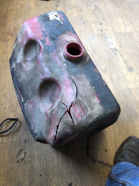

Sammy 89 #1 Posted February 11, 2021 Well fellas I’m making this listing I’m search of the best way to repair this gas tank other than plastic weld. It out of a 1969 gt14 and i can’t replace it so I need a way to fix it. Any ideas are welcome! Share this post Link to post Share on other sites
squonk 48,072 #2 Posted February 11, 2021 (edited) @19richie66 Richie makes Tanks! Edited February 11, 2021 by squonk 3 Share this post Link to post Share on other sites
Maxwell-8 4,371 #3 Posted February 11, 2021 38 minutes ago, Sammy said: Well fellas I’m making this listing I’m search of the best way to repair this gas tank other than plastic weld. It out of a 1969 gt14 and i can’t replace it so I need a way to fix it. Any ideas are welcome! In my opinion, to far gone to fix. 1 Share this post Link to post Share on other sites
Sammy 89 #4 Posted February 11, 2021 15 minutes ago, Maxwell-8 said: In my opinion, to far gone to fix. I think so too but it doesn’t hurt to try, they never come up for sale! 1 Share this post Link to post Share on other sites

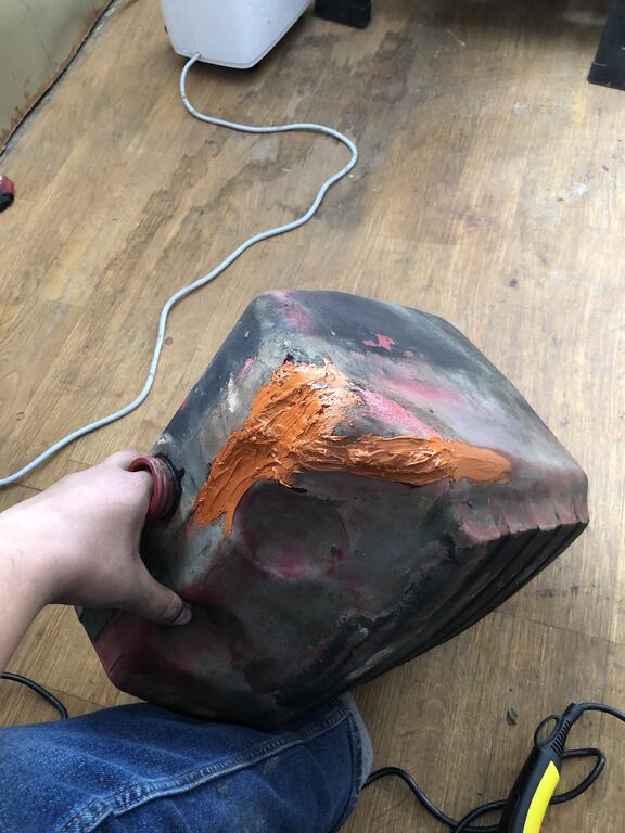

Sammy 89 #10 Posted February 11, 2021 Ok thank you and I just did, do you know his price for one or maybe an estimate? Also the pictures are from last night but after 1 coat of jb weld and 3 coats of permatex I think it’s going to hold for Hopefully a few months at least, when I plug the bottom and pressurize the top I can’t hear or feel any leaks and it inflates the tank rather than leaking so maybe just maybe it’ll work! Also I know it looks bad but it’s the best I could get. 1 Share this post Link to post Share on other sites

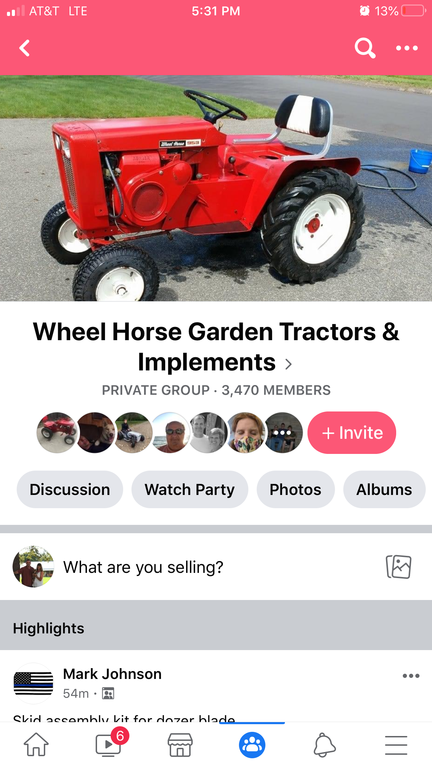

squonk 48,072 #24 Posted February 12, 2021 https://www.facebook.com/groups/229240414408139 Share this post Link to post Share on other sites
19richie66 17,932 #25 Posted February 12, 2021 This group on Facebook. He is in Kentucky. 1 Share this post Link to post Share on other sites
