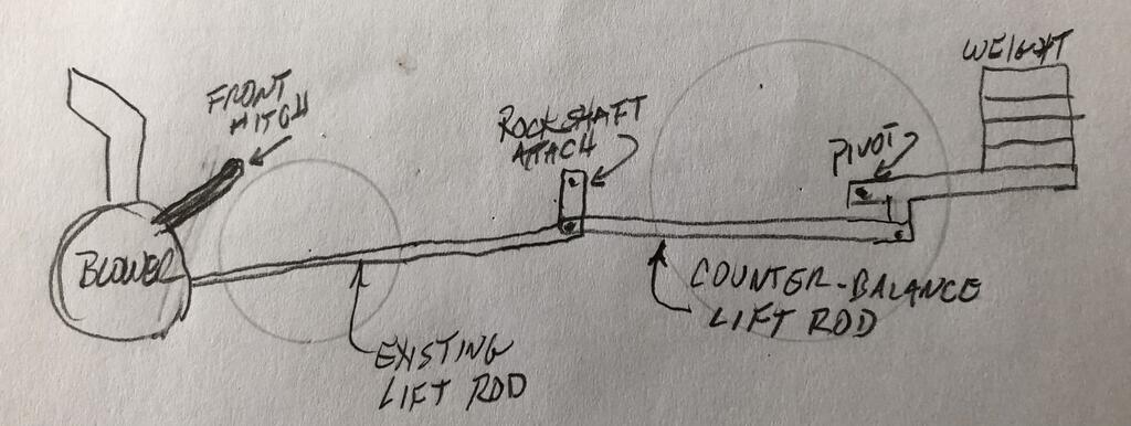

Handy Don 17,384 #1 Posted February 10, 2021 There have been a lot of threads that discuss ways to rear-mount weights to offset front loads or to help with traction. What I'm wondering is: Has anyone has ever put the rear weights on a pivot with a lever that pushes a shaft under the tractor to give a lift assist? One thought I had was a shaft similar to a snowblower lift but it would come from the rear and attach to the back side of the "flag" (the flag being attached to the rock shaft arm). The weight pressing down at the rear translates to upward lift force at the front. Depending on the leverage at the rear mount, 100 lbs of rear weight could get directly translated into 100 lbs or more of lift assist. In concept, not unlike a teeter-totter. The weight is still in the back doing its traction job but by allowing it to pivot up and down, it is also helping with a front-mounted heavy blower or a scoop bucket (or in my case, a flail mower). If this has been done, I'd sure appreciate the doer sharing pics of the design! 1 Share this post Link to post Share on other sites

lynnmor 9,026 #9 Posted February 11, 2021 With 100 pounds on the front and 100 pounds on the front, will put 200 vertical pounds on the pivot point, so keep that in mind if you build it. 1 Share this post Link to post Share on other sites
Handy Don 17,384 #10 Posted February 11, 2021 50 minutes ago, wallfish said: There was a post a while back where the guy did something similar. Had the weight in the back and it lift assisted his snow plow. Couldn't find the thread but will keep looking. Thanks, I hope you find it. I did a bunch of searches with words I thought made sense, but came up empty. 42 minutes ago, lynnmor said: With 100 pounds on the front and 100 pounds on the front, will put 200 vertical pounds on the pivot point, so keep that in mind if you build it. Yes. If the front load is 200 lbs against the lift mechanism and the assist from the back is 100, and the assist shaft and the front lift shaft are aligned, then the forces would be: -200 backward against the front of the flag -100 frontward against the back of the flag The extra 100 frontward to balance things out comes from the tractor lift through the rock shaft arm so its pin need only carry 100lbs. The only 200lb pin is at the place where the front load attaches to the lift shaft. The rear weight geometry would need care since it still has to safely support 100lbs and accommodate the leverage forces at the pivot from the lift assist action and any tractor movement. A simple inverted "L" bracket would have 100 down from the weight and 100 rearward as the resistance to the assist, so the pivot must handle those loads comfortably. This would permit removal of the lift shaft assist spring for single stage blowers or plows. If no new load is being added to the front, no changes needed. But a front support spring might still be needed to balance the lift forces against a tilting implement (I'm looking at you, right side balance spring on the 2-stage blower). Yep, a lot of variables. That's why I'm interested is seeing one that works and how it was done! Share this post Link to post Share on other sites

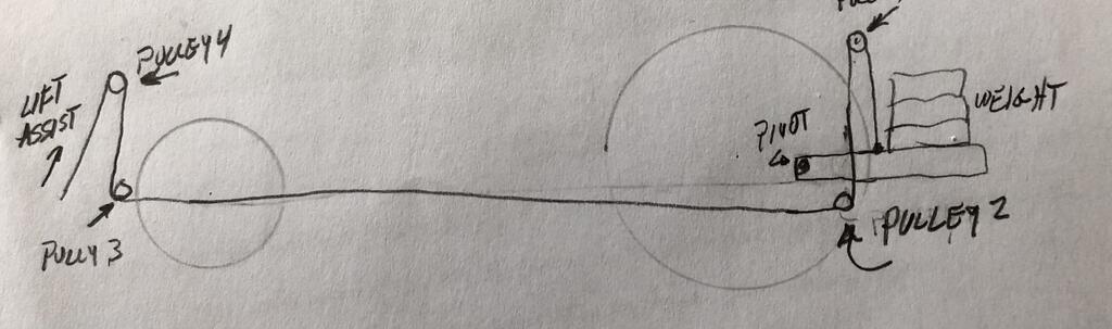

Lee1977 7,756 #11 Posted February 11, 2021 4 hours ago, wallfish said: There was a post a while back where the guy did something similar. Had the weight in the back and it lift assisted his snow plow. Couldn't find the thread but will keep looking. Extend the snow plow frame and add weight there to take weight off the plow, that would be easy. The blower is different it would take a cable a pulley up under the tractor to reverse the motion to lift the blower. Share this post Link to post Share on other sites

RandyLittrell 3,945 #23 Posted February 12, 2021 I see no point for a blade, but a counter balance for a blower would be nice. I think a better plan would be for the weight to be on its own frame and pivot point ahead of the rear wheels. This way it would support itself and just provide lift towards the front the blower subframe. No added stress to the original lift. Randy 1 Share this post Link to post Share on other sites
Handy Don 17,384 #24 Posted February 12, 2021 Man, take a day off from reviewing posts and it's like being back at work after vacation with your inbox stacked to the ceiling. Thanks for the commentary! On 2/11/2021 at 7:29 AM, squonk said: Putting weight here means putting pressure there. I can't help thinking of the late 60's and early 70's tractors that I've run across with the cracked hood stands from the pressure that the twisting force of the rockshaft puts on it. These tractors were designed for "so much" and adding weight or other mods to pull more or lift more than the original design will compromise something else. Agreed. Presumably there would be a solid rear frame already set up for weight, like some of the 2" receiver setups, and thought through to make sure all the forces are accounted for. The weight is all carried at that end down to the transaxle (if only weight were the only goal, then @ebinmaine's filled tires and wheel weights make more sense ). If the counterbalance is connected directly to the front via, say, the pushrod flag, then there is no extra force on the rockshaft or the hoodstand rails involved in the lifting. See the first sketch below. 23 hours ago, Lee1977 said: Using weight would be the same as using springs, would still take the same amount of force to lift the implement, just lessen the force require to pull the lift. Yes (and if that is less, then the forces on the rockshaft are also less). 3 hours ago, RandyLittrell said: I see no point for a blade, but a counter balance for a blower would be nice. I think a better plan would be for the weight to be on its own frame and pivot point ahead of the rear wheels. This way it would support itself and just provide lift towards the front the blower subframe. No added stress to the original lift. Randy Right, if the implement uses weight to do its job, reducing weight (downforce) makes no sense. Definitely more for blower, sweeper, front-mounted rotary mower, scoop bucket, or my fairly heavy flail mower. Can you explain how you see the pivot ahead of the rear wheels being better than a pivot behind the axle? Maybe just to make the counter-balance lift rod shorter? On 2/10/2021 at 11:50 PM, Lee1977 said: Extend the snow plow frame and add weight there to take weight off the plow, that would be easy. The blower is different it would take a cable a pulley up under the tractor to reverse the motion to lift the blower. One goal is to not have a plow frame. I keep thinking cable but as you surmise, getting the motion reversed is the trick! It'd take, I think, two pulleys in back and two pulleys in front. See second sketch below. Quick (and admittedly crude!) sketches of current thinking just to show where the general ideas. First is the via a counter-balance lift rod connected to the existing lift rod. Weight pivot/lever is a modified version of many existing rear weight support designs This is a rough idea of the cable routing method. I'm sure with some thinking it could be better! 1 Share this post Link to post Share on other sites
