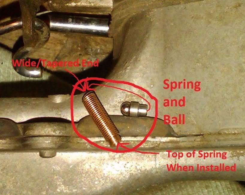

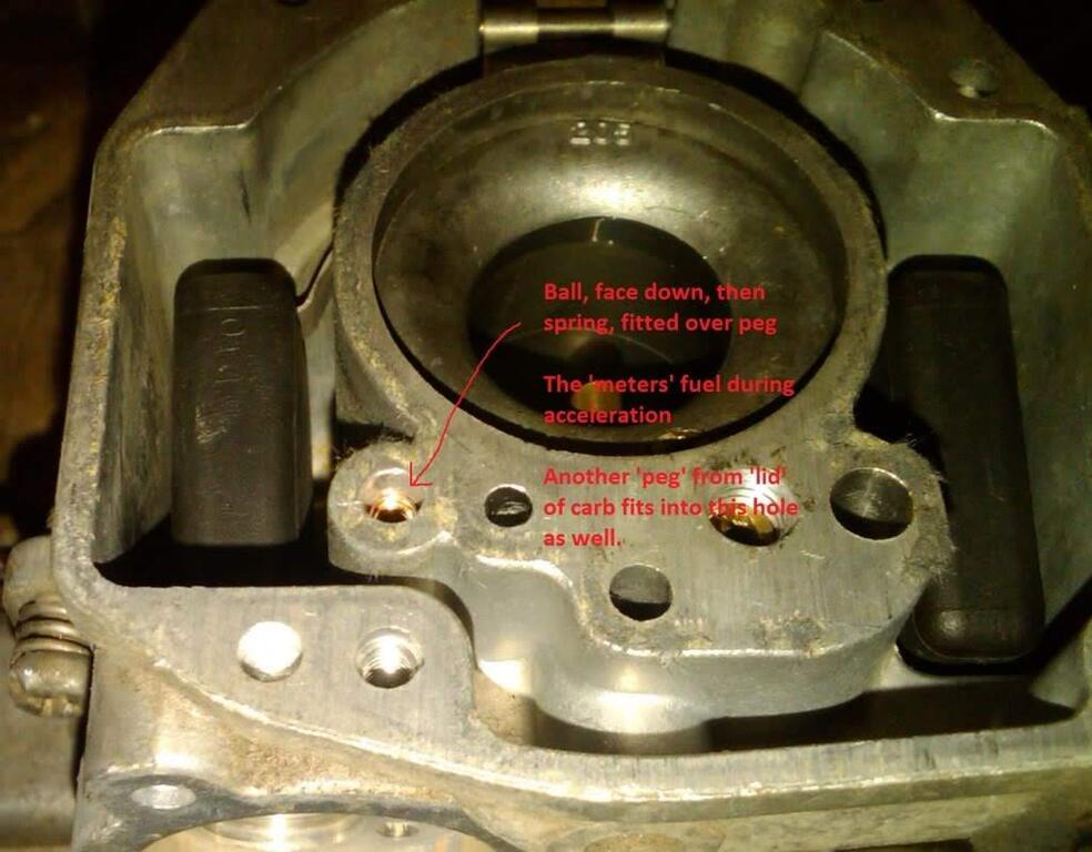

WVHillbilly520H 10,379 #12 Posted February 10, 2021 23 minutes ago, twodogs said: I think I'll throw an Onan pump on it, and another carb kit. Neither is too difficult but the carb access is just annoying enough that I'll want new parts in there instead of "just" cleaning. Adding....how does one know if they have a non-emissions carb? I should know the answer to that but have never looked into it. I've read numerous people talking about it but have never looked into it. Usually 94/95 and older non emission carb, my Anniversary model 520 (1996) definitely emissions has the "automatic accelerator pump" these pics from when I rebuilt the carb on it. 1 Share this post Link to post Share on other sites
twodogs 55 #13 Posted February 10, 2021 6 minutes ago, WVHillbilly520H said: Usually 94/95 and older non emission carb, my Anniversary model 520 (1996) definitely emissions has the "automatic accelerator pump" these pics from when I rebuilt the carb on it. Thanks for that info. I've got a '91 model so it would fall into the non-emission category. Good reminder on the intake gaskets. I can only get non-ethanol in 91 octane, so that's fueled my smaller engines for a while now. I'll give the Berryman's B-12 a try; I'm always on the hunt for a good elixir (perhaps even more important given that my 520 can sit for a month or two at times). 3 1 Share this post Link to post Share on other sites
