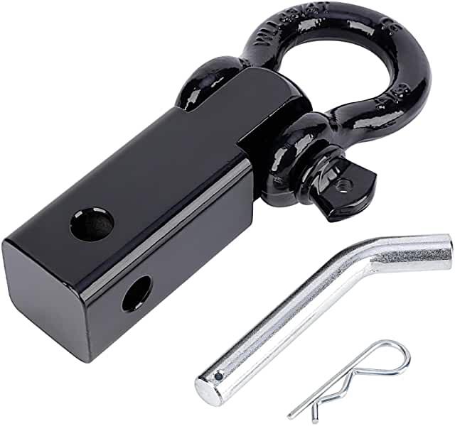

BeninCT 451 #9 Posted February 10, 2021 Quite a few crane hoist ideas online. I liked this shackle and a flag pole holder. 3 Share this post Link to post Share on other sites
DennisThornton 4,773 #10 Posted February 10, 2021 Yeah. Handy item to have behind you! 1 Share this post Link to post Share on other sites
ebinmaine 80,918 #11 Posted February 10, 2021 5 hours ago, BeninCT said: shackle That's one I wish I'd had a time or two but you can run the tow rope around the hitch as well. Shackle does make it nice and easy. Share this post Link to post Share on other sites

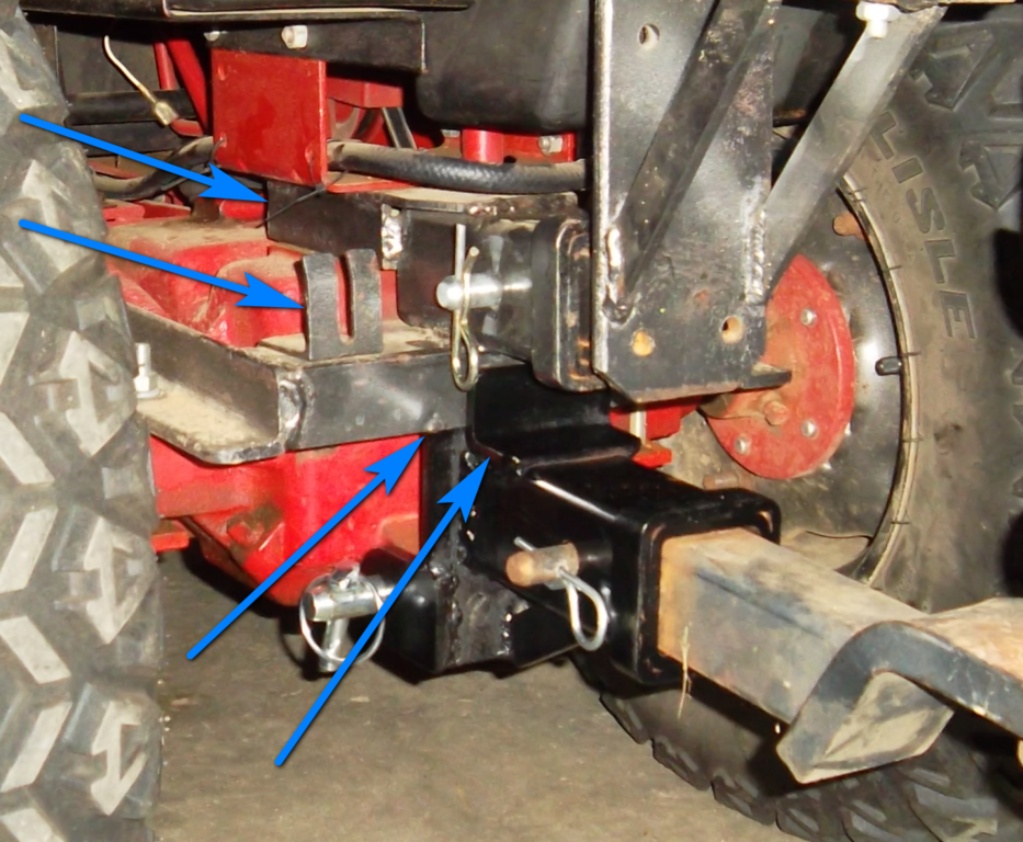

DennisThornton 4,773 #14 Posted February 11, 2021 7 hours ago, Lee1977 said: I use a 2" receiver to mount my vacuum on my C-120 also the winch on my 312-8. I thought I had seen just about every rear hitch there could be and decided that nothing could be better than what I've seen and then this comes along. LOTs going on here! Heavy Duty Xs 2! Which came first? And I take it that they are NOT welded to each other. 1 Share this post Link to post Share on other sites
Lee1977 7,805 #15 Posted February 11, 2021 1 hour ago, DennisThornton said: I thought I had seen just about every rear hitch there could be and decided that nothing could be better than what I've seen and then this comes along. LOTs going on here! Heavy Duty Xs 2! Which came first? And I take it that they are NOT welded to each other. . First arrow every thing is raised 1 3/4" because of the 25" tires. Second chain bracket for the rear hitch as the winch attachment is on the implement. Third and forth the lower hitch is removable it clips over the other hitch. 2 Share this post Link to post Share on other sites
DennisThornton 4,773 #16 Posted February 11, 2021 2 minutes ago, Lee1977 said: First arrow every thing is raised 1 3/4" because of the 25" tires. Second chain bracket for the rear hitch as the winch attachment is on the implement. Third and forth the lower hitch is removable it clips over the other hitch. Pretty neat! Guess my final design in my head isn't done yet! Thanks! Share this post Link to post Share on other sites
Lee1977 7,805 #17 Posted February 11, 2021 (edited) 4 hours ago, DennisThornton said: Pretty neat! Guess my final design in my head isn't done yet! Thanks! That won't work on a stock tractor, it needs the extra 1 3/4" of room. Here is a very similar hitch on my 520-H and the receiver hitch is cut in under the bracket as there isn't enough room on top. I intended to put it on top it wouldn't go. Quote The 312-8 hitch is braced on top of the transmission. I haven't finished the lower braces on the 520-H as my welder quit. Edited February 11, 2021 by Lee1977 Share this post Link to post Share on other sites

Lee1977 7,805 #20 Posted February 11, 2021 (edited) I made a few modifications to the hitch on my C-120/180. Everything got modified to make this work. The braces on the receiver hitch moved out, the WH tow hitch still works. The tubes cut off the lift hitch and the lift bracket moved to the out side with a spacer. The rocker bracket also got modified. Edited February 11, 2021 by Lee1977 3 Share this post Link to post Share on other sites
