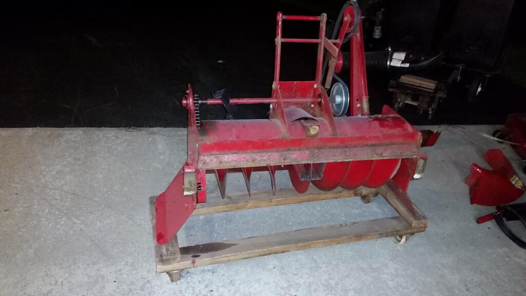

WHX?? 58,304 #28 Posted February 9, 2021 (edited) Lowell has those lift flags and the plastic covered cable. I also have a newer short chute that I am probably going to parts out if you need those wings and turner spool thingy Ed mentioned Jeff... guessing they might fit. Might even have that lift flag. Edited February 9, 2021 by WHX24 1 Share this post Link to post Share on other sites

Ed Kennell 47,598 #33 Posted February 9, 2021 1 hour ago, WHX24 said: Now Jim, I know you didn't put those wings on there backwards. But we don't want to lead Jeff astray. 1 Share this post Link to post Share on other sites

WHX?? 58,304 #38 Posted February 9, 2021 3 hours ago, Jeff-C175 said: why did this post 3X ? It happens! 13 hours ago, Ed Kennell said: I know you didn't put those wings on there backwards. No I did not that pic is from when I picked it up but rest assured I did flip them around! It's actually in way better shape now I went through it end to end, all stainless hardware, new bearings, sprocket & idlers. The only problem is the chute base is messed up & probably could be repaired but not by me. I'm tall chute & deuce blower heavy now. Plan was & still is to haul it out to the BS if someone wants it. 1 Share this post Link to post Share on other sites

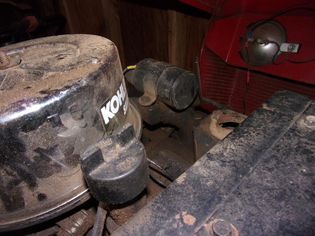

Ed Kennell 47,598 #39 Posted February 9, 2021 18 hours ago, Ed Kennell said: 18 hours ago, Ed Kennell said: think my KT17 has a winter or summer position for the air cleaner inlet. Yep it is the KT17. I use the summer position as this is a mower only. The air cleaner connects to this hole in the tins for winter use. Share this post Link to post Share on other sites
Jeff-C175 7,211 #40 Posted February 9, 2021 4 hours ago, Ed Kennell said: KT17 Series II I think? Not sure when they switched from the teardrop to the top hat air filter housing. Share this post Link to post Share on other sites
Jeff-C175 7,211 #41 Posted February 9, 2021 6 hours ago, WHX24 said: No I did not that pic is from when I picked it up but rest assured I did flip them around! I'm lookin' and lookin' at the pic and not sure how they are 'backward'? Is the 'bent' edge supposed to og on the housing? I don't see any bolt holes along the other edge... and I blew the pic way up! But, I'm blind in one eye and can't see outta the other ... so... Share this post Link to post Share on other sites
Ed Kennell 47,598 #42 Posted February 9, 2021 Jeff, the bend in the leading edge of wing should be parallel to the side of the blower housing, not sticking as in the pic. They can be flipped over of switched to opposite sides 1 Share this post Link to post Share on other sites
WHX?? 58,304 #43 Posted February 9, 2021 The front bent edge of the wing is supposed to be parallel with the blower. Acts as a drift cutter that way. Some guys put them on backwards thinkin they would grab more snow. Share this post Link to post Share on other sites

Jeff-C175 7,211 #46 Posted February 9, 2021 (edited) 10 minutes ago, WHX24 said: drift cutter OK, I see it now. So they're 'upside down' but not necessarily 'backwards' if you follow my logic. Yeah, makes no sense to put that extra load on the end of the wing. Should cut the snow for sure. Edited February 9, 2021 by Jeff-C175 Share this post Link to post Share on other sites
WHX?? 58,304 #47 Posted February 10, 2021 On backwards they can actually pull you over into the drifts & banks. Tom @Shynon built some nifty plates that went from the leading edge back to the housing. If he ain't slumped and passed out in his machineing corner maybe a pic Tom? Share this post Link to post Share on other sites
