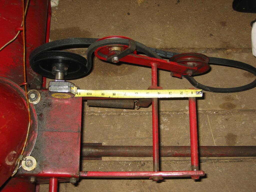

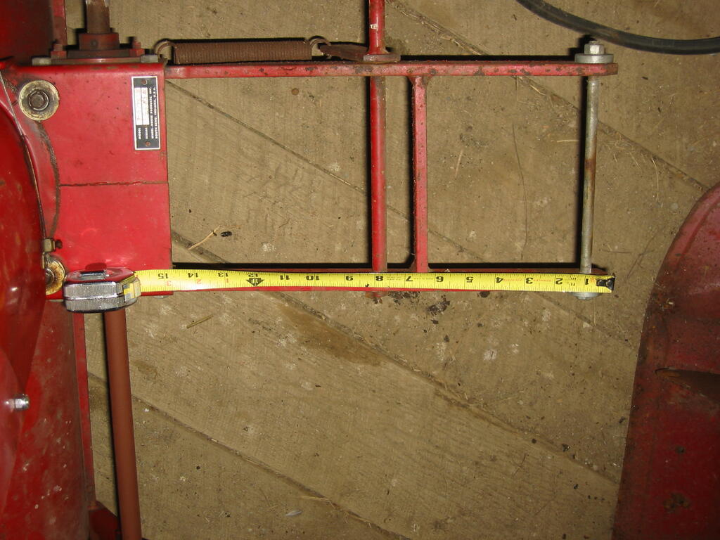

pfrederi 21,222 #6 Posted February 8, 2021 Ed is right on If you hook it to your tachmatic you will need a longer belt and lift rod. There is a significant difference in length. 2 Share this post Link to post Share on other sites

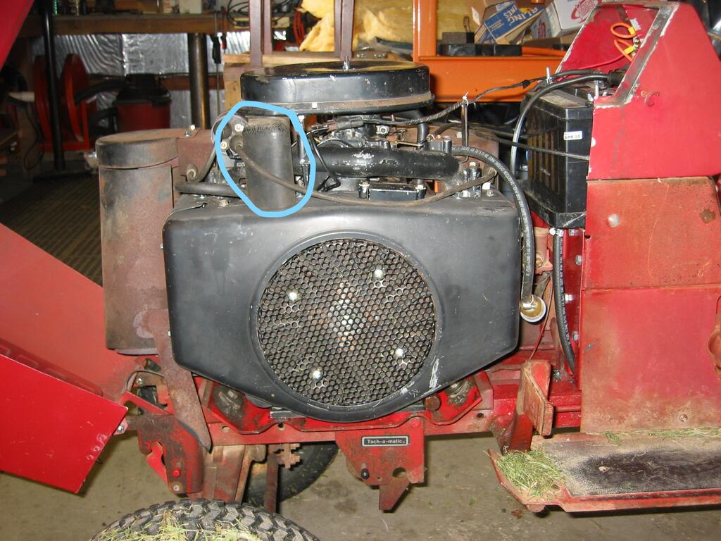

pfrederi 21,222 #19 Posted February 9, 2021 I would guess you have a rubber tube feeding you air cleaner from the air shroud (like this). The flywheel fan is flinging snow and cold air directly into the air cleaner. Maybe you could pull the tube out of the shroud and bend (and maybe extend it ) so it draws fro a warmer spot and cover the hole in the air shroud with duct tape. 1 Share this post Link to post Share on other sites

Jeff-C175 7,211 #22 Posted February 9, 2021 6 minutes ago, pfrederi said: you have a rubber tube feeding you air cleaner from the air shroud (like this) Hi Paul, yes, exactly like that. I thought about doing something with that but it may be just as easy, or even easier, to use that flex tubing to duct some warm air from the fins in a 'u turn' to under the carb / intake manifold. No finagling with the intake tube required. Just the exhaust tubing and a few metal zip ties. Then when summer rolls 'round just cut the ties and throw the gadget on the shelf so I have to search high and low next winter for where I stashed it. 1 Share this post Link to post Share on other sites

pfrederi 21,222 #24 Posted February 9, 2021 I think warmer dry intake air would be more efficient than just trying to warm the intake manifold. The M18 i have has the intake off the side in summer over a hole in the exhaust side tins i the winter.... Share this post Link to post Share on other sites
Jeff-C175 7,211 #25 Posted February 9, 2021 13 minutes ago, pfrederi said: warmer dry intake air would be more efficient than just trying to warm the intake manifold You could be right about that! I'm going to take a look tomorrow and see if perhaps I can figure out a way to put something 'professional' and 'permanent' in place with maybe a 'flapper' that I can flip for summer / winter. I'm not real sure why they are taking intake air from under the tins in the first place. Maybe hoping that the screen on the flywheel would stop some of the grass? It STILL gets in there! During the summer I have to clean the prefilter every time I mow. In fact, I bet taking inlet air from the side opposite the exhaust would result in LESS grass being airborne and entering the filter housing. Share this post Link to post Share on other sites
