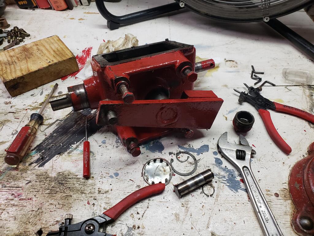

Thegearhead0324 1,857 #1 Posted February 8, 2021 As some may know, I tried selling my Sickle bar off my 1257. I must have opened and closed the post about 4 times. I can't part with it. My conscience won't let me. So, instead, before I took it all apart, lubed everything, cleaned and painted it. 4 years later (now), I'm going to take it all apart again, but this time replace bearings and seals and other things. Sharpen the knives again, etc. I have the parts diagram and numbers. If someone could point me in the right direction of the current part numbers for the bearings and seals. I have some written down already from other members on here who have done theirs. Looking forward to the round 2 of the teardown. Share this post Link to post Share on other sites

Thegearhead0324 1,857 #5 Posted February 10, 2021 Thanks Lane, I read all of your content and it helps. I ordered 2 seals on ebay, got a sealed bearing from parts store. I never really used it but just realized the little part on the wobble box that the handle catches on to lift it up is like half the size it should be. Basically it's worn down. Gonna have to figure that out while its apart. Everything else seems fine. 1 Share this post Link to post Share on other sites

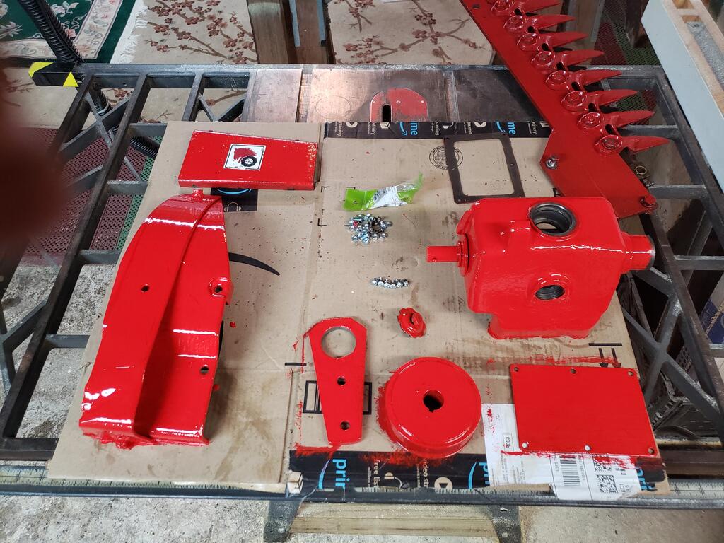

Thegearhead0324 1,857 #6 Posted February 11, 2021 Welp while waiting on parts, I cleaned up the pieces and painted what I messed with. I lugged it in the basement as 1 piece so it got all banged up. When it dries I have to blend it to match the pieces I painted 4 years ago (I have my ways). As for the wobble box, where the handle catches the tiny piece thats half gone, I made up a "makeshift" setup. I can't weld on the casting (wow that would be too easy). Instead I made a 90 degree bracket that goes from the bottom to the wobble box. Kind of hard to explain when its together I will post a pic. Hopefully its good enough for the weight of the beast. Doesn't have to be perfect, just want it to perform and look clean. 1 1 Share this post Link to post Share on other sites

Thegearhead0324 1,857 #8 Posted February 14, 2021 I just wish I could weld on the wobble box, it would be cake to make a thicker piece. Still waiting on the seals. Then I can start assembling. Little cold in the basement so paint takes forever to dry. I got the new jam nut, assortment of nuts and bolts, cotter pins, new tiny screws that go on the plate, and I just got a arm in the mail that holds the sickle bar up from a seller on ebay, I believe he had one in the classifieds here too, looks very nice. 1 Share this post Link to post Share on other sites

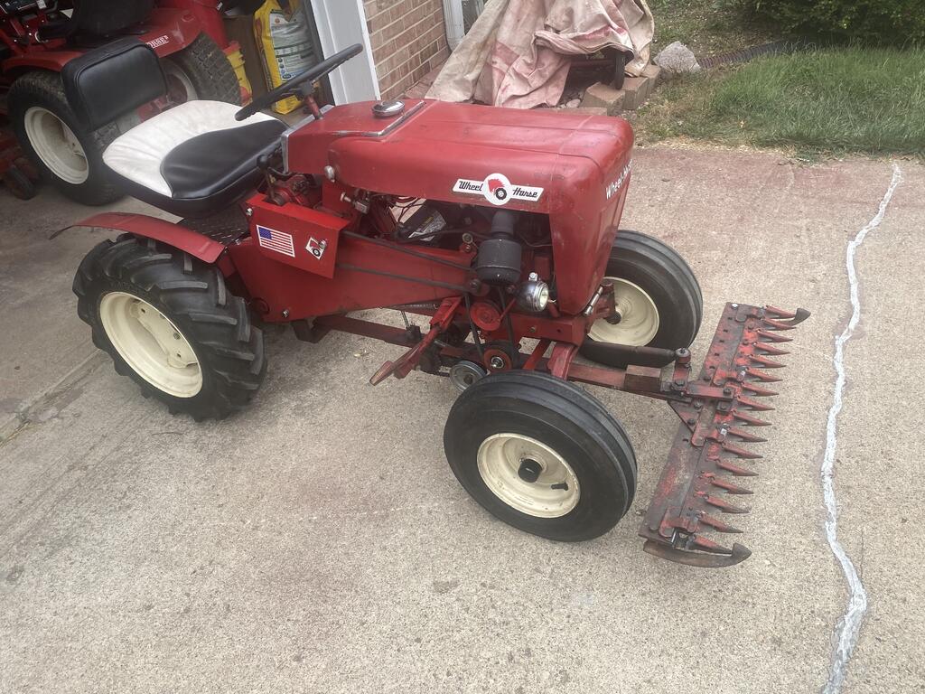

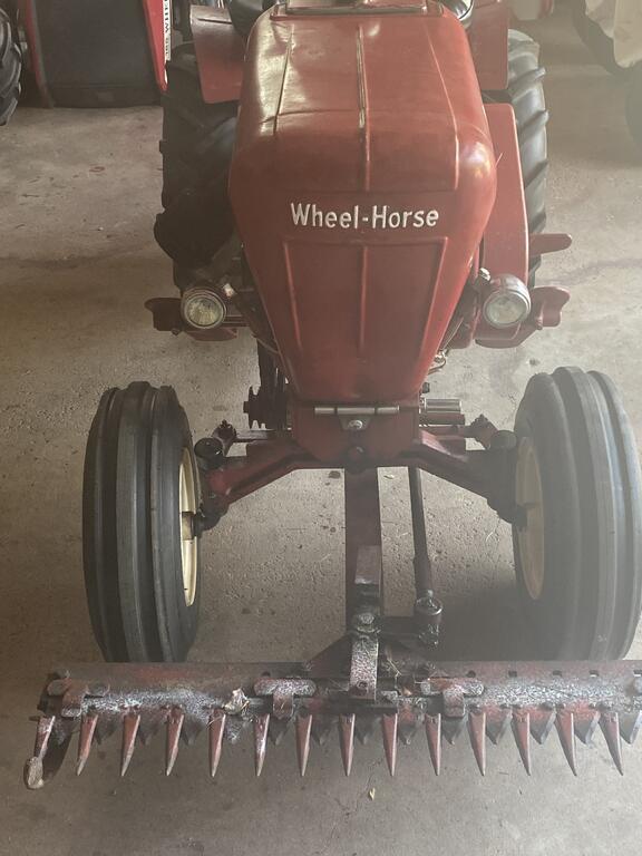

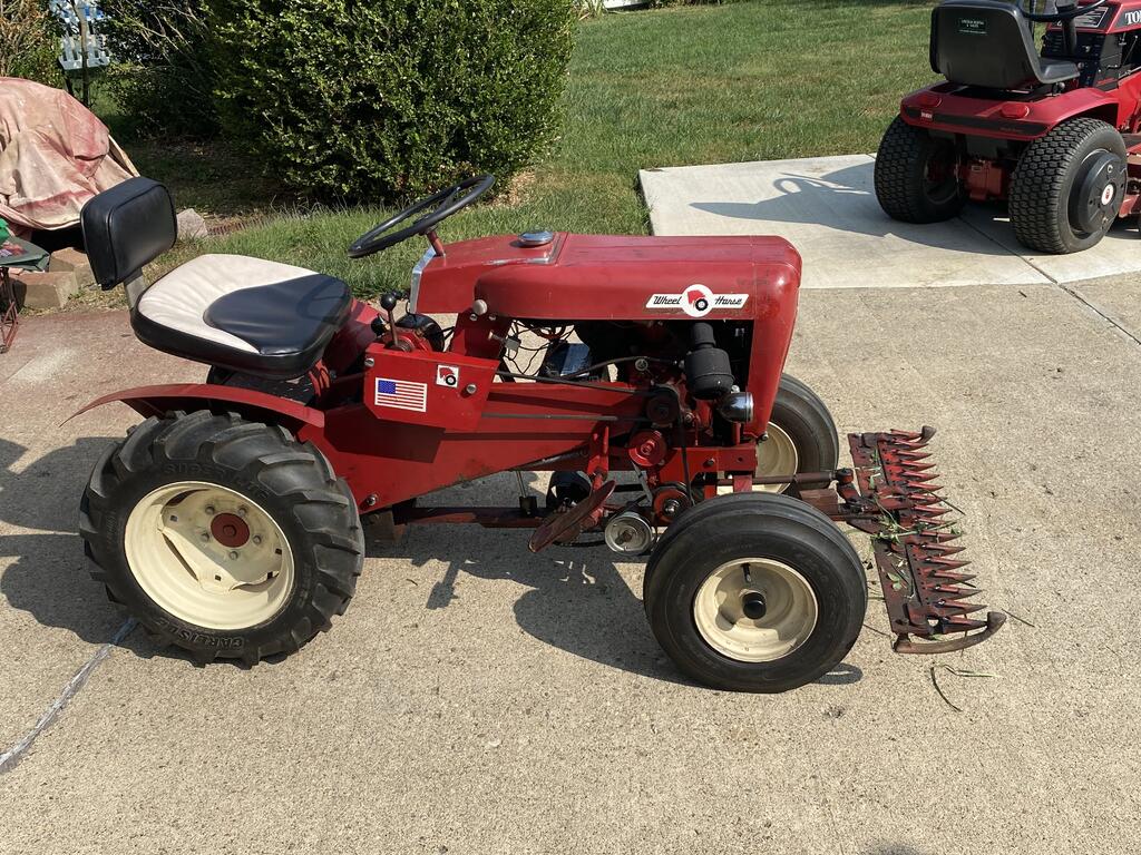

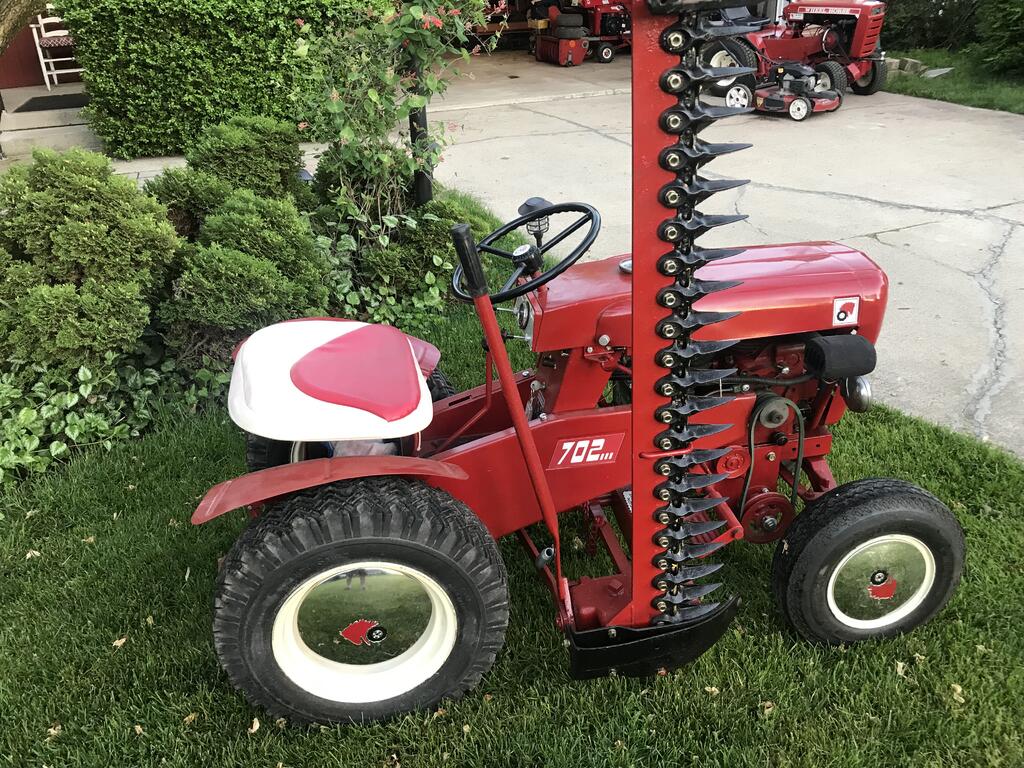

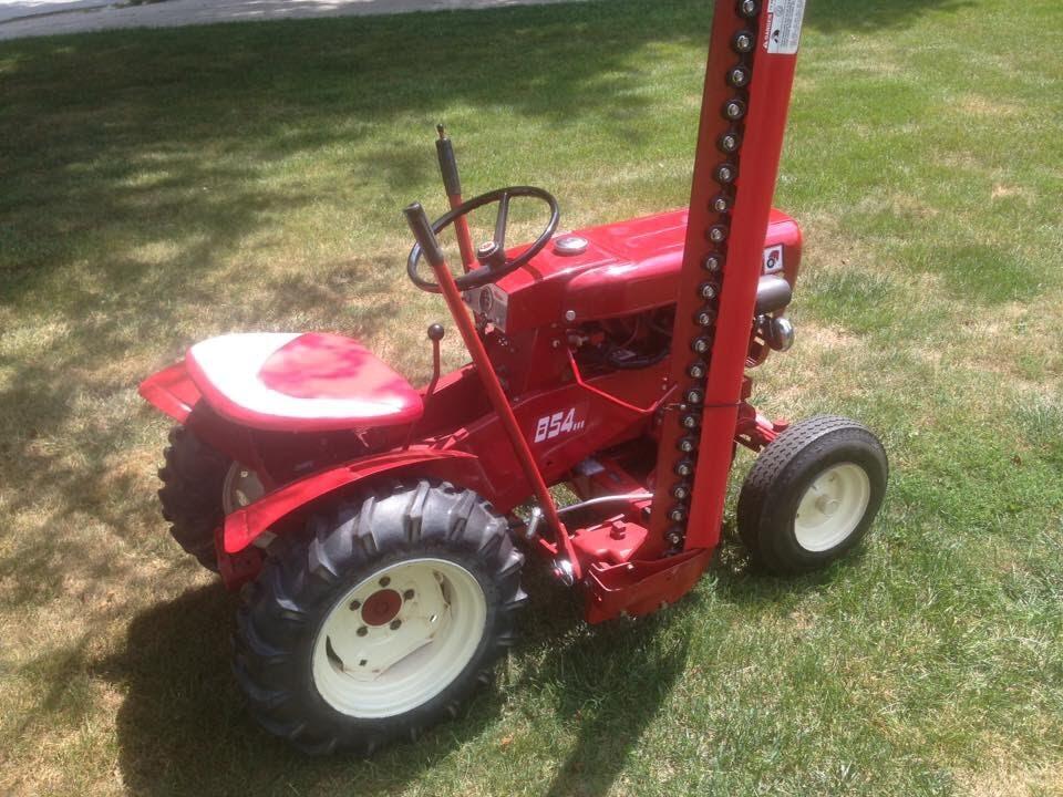

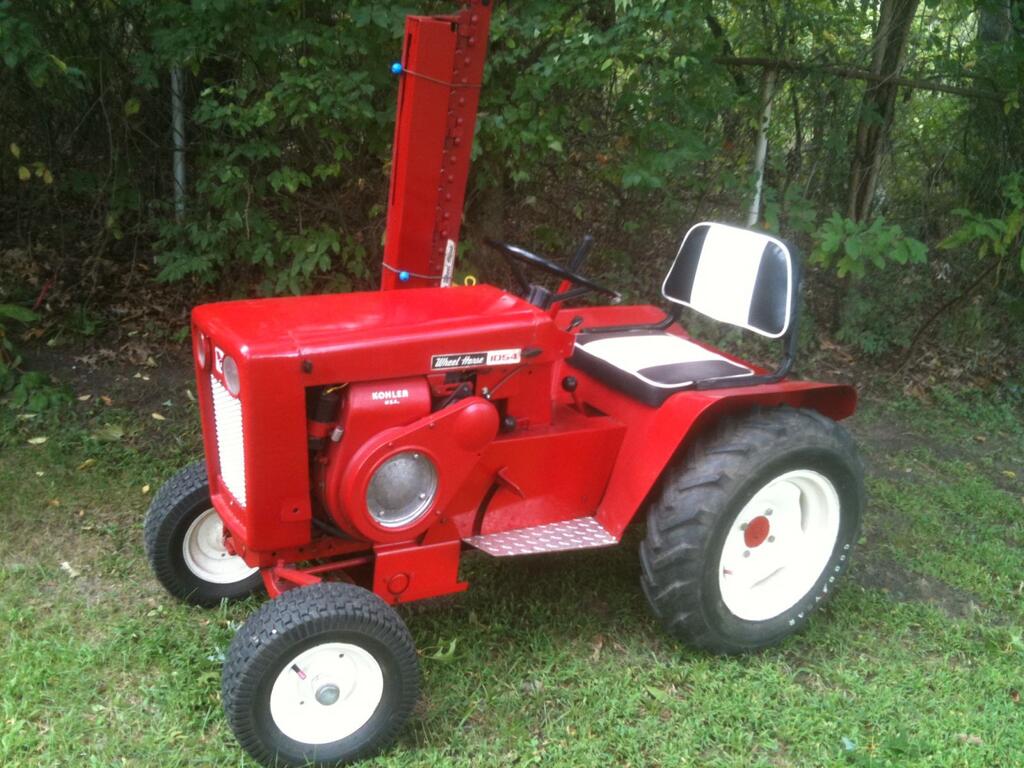

Lane Ranger 12,149 #9 Posted February 15, 2021 Yes both Lowell S (wheelhorsepartsand more.com ) and DJ Harrison are selling the sickle arm and plate that goes on the tractor to hold arm up when not in use. More pics of some of the sickles I have now. The 1054-A -1965 tractor with a 50 inch sickle made for the wider 1054 frame. My 701 with the rare CBR-327 32 inch chain drive front cutter bar. I redid the complete blade replacement last year on it. 854 with 50 inch sickle bar mower (I redid and sold this one) My CB-32 inch front sickle on one of my 1958 RJ's 1 1 Share this post Link to post Share on other sites

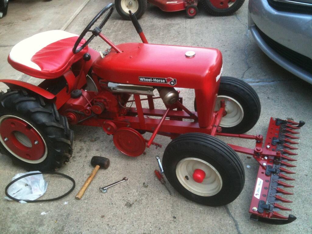

Thegearhead0324 1,857 #15 Posted February 26, 2021 Well I mounted it on the horse. What a chore i forgot what a pita it is. Took my plow off it and put the sickle bar on. I definitely gotta touch up the tractor and stuff again from using it past few winters. Only issue, the bracket I came up with isn't really good enough to lift the bar up and down. Anyone have any other suggestions or ideas I'd appreciate it. 1 Share this post Link to post Share on other sites
