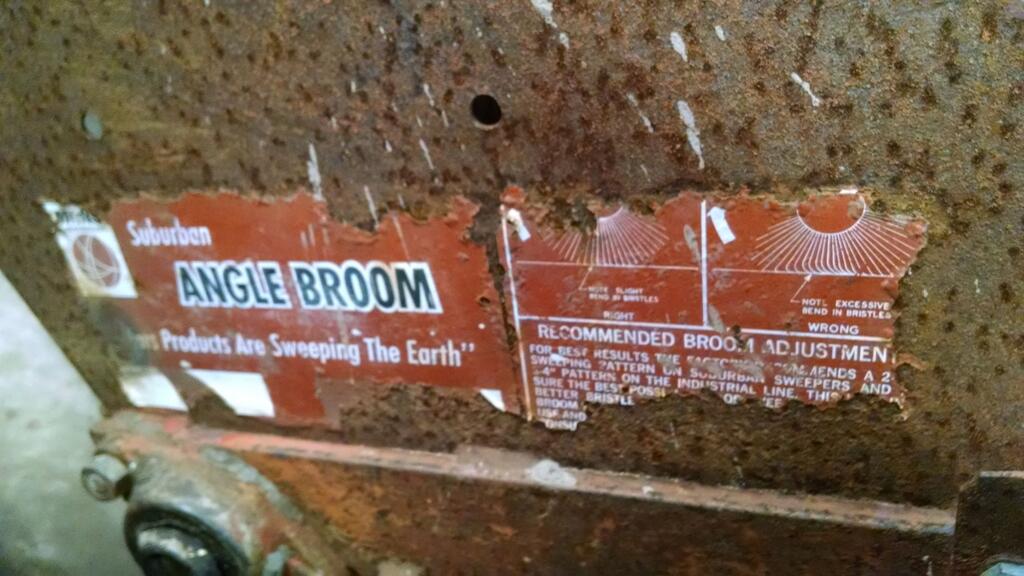

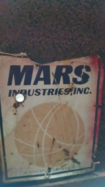

Achto 32,271 #1 Posted February 8, 2021 (edited) Well, I'm not quite ready to sweep the earth. A friend of mine (who is not into garden tractors at all but knows that I am) showed me a that was for sale on Face Book. I told him that I really didn't need another tractor but I did like sweeper that was on it. Next thing I know he was asking me if I wanted to buy the sweeper because he just bought the tractor. He also asked me if I could look the tractor over for him, which I was more than happy to do. The tractor is a 1267 that has been the unfortunate victim of PO's that were obviously "shoe men". But I've done more with less. Any way on to my gain from this acquisition, a Mars sweeper.Who ever owned this sweeper before sure loved the crap out it, as the broom is really warn down. I found some posts on the forum about the Mars sweeper but seems there was not a whole lot of info. The price was right on mine though so sooner or later this thing will end up on my "resto radar". Mean while I will do my research and see what I can do for replacement brooms. I will also be wanting to add some casters to it for height adjustment, I'm thinking caster with pneumatic tires so it can be used on softer surfaces if need be. I would gladly welcome more info on the Mars sweeper, if any one has some. Thanks. Edited February 8, 2021 by Achto 1 9 Share this post Link to post Share on other sites

WHX?? 57,650 #3 Posted February 8, 2021 Says Suburban on it ...that means it goes on a Suburban? ?? Only 'Burb you have is the Rat Rod.....never fit......I best just come and get it. Hope you don't mind if I wait 'till after you resto it tho. Sides I have plenty of '67s it would feel right at home on. You were right about that poor 1267 she was on ... pretty rough putting it mildly. Best you explain why it's next to a Simplecity tho! 4 Share this post Link to post Share on other sites

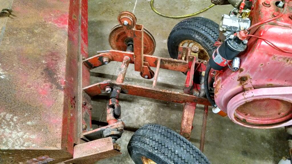

Handy Don 17,217 #21 Posted February 8, 2021 16 hours ago, Achto said: Not a lot of help, but it looks like that u-joint in the drive is crooked--broken at the main frame end? May be weldable but if hopeless, PM me with closeup pics--I might have a usable replacement. 1 Share this post Link to post Share on other sites
Achto 32,271 #22 Posted February 8, 2021 2 minutes ago, Handy Don said: but it looks like that u-joint in the drive is crooked--broken at the main frame end? Thanks, good eye on that. The u-joint is not on the shaft all of the way in the pic. I started tearing things apart and then remembered that I should get some pics. Share this post Link to post Share on other sites
Handy Don 17,217 #23 Posted February 8, 2021 9 minutes ago, Achto said: Thanks, good eye on that. The u-joint is not on the shaft all of the way in the pic. I started tearing things apart and then remembered that I should get some pics. YW. I've worked with single u-joint drive lines both with and without a spline. In the "without" case, it's critical to make sure the yoke pivots are precisely at the intersection of the axes of the two shafts before tightening the setscrews. A misalignment may be why the joint here disconnected from the jackshaft. Looks like a fun project! 1 Share this post Link to post Share on other sites
