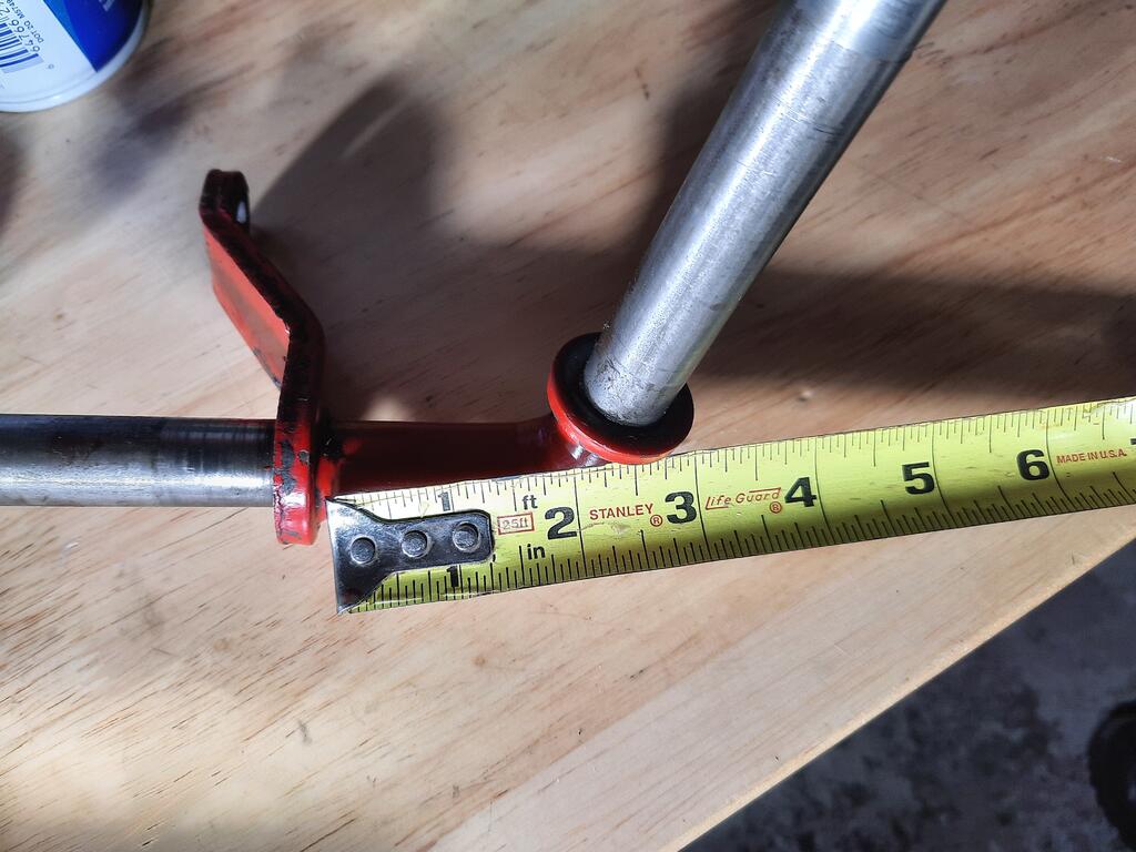

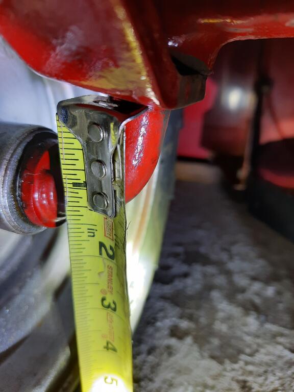

David414 323 #1 Posted February 7, 2021 I have a new to me, a 1991 312-h model 51-12KE01, that has 6" front wheels. The spindles need replacing. On Toro's parts list, front spindles have the following numbers for the RH as 113380 and 113379. The left side has 113382 and 113381. My 1989, 414-8, model 31-14K804 has the same part numbers for spindles but has 8" front wheels. The spindles are shorter, please see pictures. The 312-h axle hole for the spindle is very good, no play with a .750 rod inserted; all the wear is on the hub side of the spindles from bad bearings. What is the correct spindle part number for the 6" front wheels on the 312-h? What is the difference in the part numbers? Spindle length? What would happen to the 312-h if I use the 6" wheels with shorter spindles? Is this advisable? I would like to use the shorter spindles and upgrade the 6" wheels to 8". Are used 8" wheels available? My 414-8 came with a 37" SD deck, short spindles, 8" wheels, and the tires do not rub the deck. Thanks, David Share this post Link to post Share on other sites

JCM 11,415 #5 Posted February 7, 2021 It appears by the picture the 113381 and 82 are the short ones and more $ than the longer ones Share this post Link to post Share on other sites

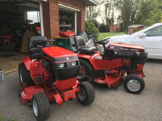

"Manic-Mechanic" 1,486 #9 Posted February 8, 2021 (edited) I just did exactly that, shorter spindles with eight inch wheels. Yes, A-Z has some in stock. I changed mine because the originals were sloppy and twisted. Plus I run a Snowthrower and little 6” wheels wouldn’t do so well......There are some differences tho’, hold the front wheel with clips, cotter pins or bolts? Mine use the bolts. Many Thanks to Eric Edited February 8, 2021 by oldman Additional info 1 1 1 Share this post Link to post Share on other sites
ebinmaine 80,512 #10 Posted February 8, 2021 5 hours ago, oldman said: I just did exactly that, shorter spindles with eight inch wheels. Yes, A-Z has some in stock. I changed mine because the originals were sloppy and twisted. Plus I run a Snowthrower and little 6” wheels wouldn’t do so well......There are some differences tho’, hold the front wheel with clips, cotter pins or bolts? Mine use the bolts. Many Thanks to Eric Nice looking rig. 1 Share this post Link to post Share on other sites

David414 323 #14 Posted February 8, 2021 17 hours ago, JCM said: It appears by the picture the 113381 and 82 are the short ones and more $ than the longer ones @JCM you are correct! 1 Share this post Link to post Share on other sites
