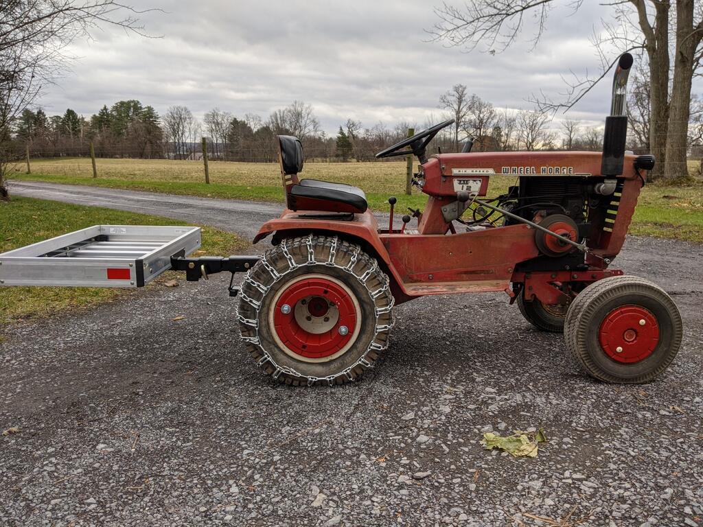

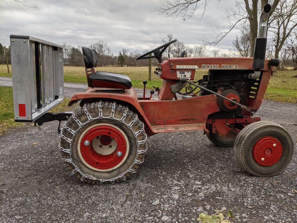

BeninCT 451 #29 Posted February 9, 2021 7 hours ago, ebinmaine said: Just due to the fact that you already know what you need to do tells me you'll figure it out. What are you using for a welder? Lincoln 220V mig setup with argon mix. I have made a few really nice beads so its coming. Finished this thing today and its so strong its totally ridiculous. I bet I could put a 2’ piece of square tube in there and put 1000lbs on the end and the front wheel sof the tractor would pop right off the ground. Total overkill. Zero flex in it with my 230 lbs on it bouncing up and down. Pretty happy with it aside from my welding haha. Makes me think I need a rear bumper/step to put in it, weight rack and weights, maybe a work box to have on in summer months, lawn roller, what else am I missing? 3 Share this post Link to post Share on other sites
DennisThornton 4,773 #30 Posted February 9, 2021 28 minutes ago, BeninCT said: Lincoln 220V mig setup with argon mix. I have made a few really nice beads so its coming. Finished this thing today and its so strong its totally ridiculous. I bet I could put a 2’ piece of square tube in there and put 1000lbs on the end and the front wheel sof the tractor would pop right off the ground. Total overkill. Zero flex in it with my 230 lbs on it bouncing up and down. Pretty happy with it aside from my welding haha. Makes me think I need a rear bumper/step to put in it, weight rack and weights, maybe a work box to have on in summer months, lawn roller, what else am I missing? Nice! And yes, probably overkill but it's one thing you won't have to worry about ever. As soon as I build mine this or similar is going on it. 1 Share this post Link to post Share on other sites
BeninCT 451 #31 Posted February 9, 2021 Thanks! I like that Dennis though might be too big for where I end up running this thing. Might want higher sids too and a solid floor to keep the stuff from bouncing out. Either way you have options 1 Share this post Link to post Share on other sites

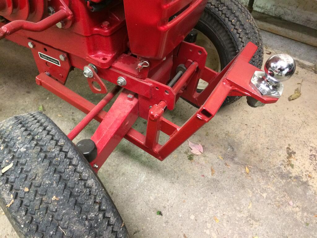

rjg854 13,455 #33 Posted February 9, 2021 30 minutes ago, DennisThornton said: Nice! And yes, probably overkill but it's one thing you won't have to worry about ever. As soon as I build mine this or similar is going on it. Something like this one 4 Share this post Link to post Share on other sites

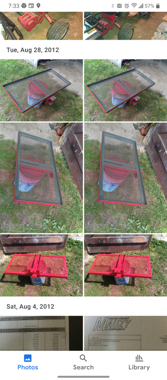

DennisThornton 4,773 #38 Posted February 9, 2021 Oh! I've always wanted and never took the time to build something like this: 3 Share this post Link to post Share on other sites

BeninCT 451 #46 Posted February 9, 2021 (edited) 3 hours ago, DennisThornton said: New painters fear running the paint. I recommend running the paint and then back off. Serious, the best paint job is where ALL of it is JUST about to slide off! Same with new welders. If you don't burn through from time to time your amperage isn't high enough. After practicing pushing the edge your paint won't run anymore and your welds won't go through. But in the beginning burn through something! Test piece perhaps? I just need patience is all. I’m busy so always in a rush sadly but like to get stuff done so I rush. Working on it lol. I understand the science and technique and I get good penetration. I see a lot worse with paint on it too so not worried. It’s a tractor! I can imagine myself as a better welder looking at old projects/welds though later in life and cringing. Haha Edited February 9, 2021 by BeninCT Share this post Link to post Share on other sites

rjg854 13,455 #49 Posted February 10, 2021 21 minutes ago, BeninCT said: You have #40 roller chains around your fronts? yes Put them on deflated and pump up until tight? yes Been thinking about that- plow pushes front sideways sometimes. It will help against that 21 minutes ago, BeninCT said: Slick setup you have there- looks like its way too far out but now that I have this hitch I know that it could handle that. Crazy strong It's a combination of things that make it do that. The 2" receiver goes into the slot hitch and then the deck goes into the receiver. It's made for an atv, but I cut it down to the width of the tractor. I use it to take my recycling bins down to the highway, trash on trash day, and retrieving packages that come in the mail, for now. It's rated for 500lbs. It's easier and quicker than having to hook up the tub trailer each time. I can leave it on the tractor and it doesn't take up much room. 2 Share this post Link to post Share on other sites
