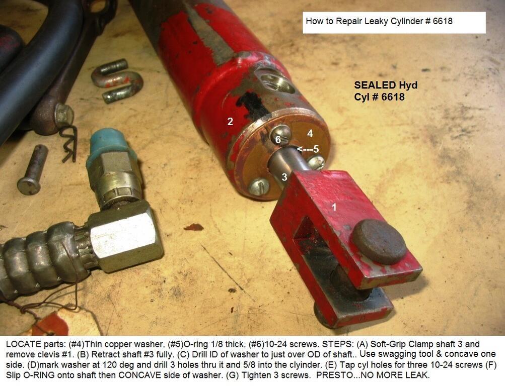

daveoman1966 3,884 #1 Posted February 7, 2021 (edited) This older Hydraulic Clyinder #6618...used 'til mid 70s...is notorious for developing a leak and making a mess. Here is my 'easy fix' to stop the drip drip drip... If it later on begins to leak again, just replace the O-ring under the Copper washer. This is the fix I used on both my Bronco 14 and the C-160 Auto a couple of years ago and neither one leaks today. Edited February 7, 2021 by daveoman1966 pic 2 8 Share this post Link to post Share on other sites

Bar Nuthin 3,292 #6 Posted April 10, 2025 (edited) On 2/7/2021 at 4:06 AM, daveoman1966 said: just replace the O-ring under the Copper washer. Where would a person look for such a copper washer? Edited April 10, 2025 by Bar Nuthin Share this post Link to post Share on other sites
peter lena 10,076 #7 Posted April 10, 2025 @daveoman1966 good info , what was the specific make up of the " 0 " ring ? https://www.google.com/search?q=o+ring+for+hyrraulic+cylinder&rlz=1C1CHBF_enUS866US866&oq=o+ring+for+hyrraulic+cylinder+&gs_lcrp=EgZjaHJvbWUyBggAEEUYOTIICAEQABgWGB4yCggCEAAYChgWGB4yDQgDEAAYhgMYgAQYigUyDQgEEAAYhgMYgAQYigUyDQgFEAAYhgMYgAQYigUyDQgGEAAYhgMYgAQYigUyCggHEAAYgAQYogQyBwgIEAAY7wXSAQkxODQ2MmoxajSoAgiwAgHxBVQXmPl8eJ9O8QVd2uobpsAVLA&sourceid=chrome&ie=UTF-8 maybe you just lucked out on your replacement , type / style / composition , back in the day , when I did those , we had a chart / graph specific to chemical effect / good / bad , oils / pressure etc , viton, teflon , etc that would let you get exactly what you need , most of our hydraulic anything anything was based on FOOD GRADE , capabilities , just about everything we made was , added into food , beer . also typically used a super lube , for installation ease , compatibility , pete Share this post Link to post Share on other sites
peter lena 10,076 #8 Posted April 10, 2025 @daveoman1966 just found it , ring specs , composition , NITRILE , BUNA - N OR VITON , rated for hydraulic cylinders , stay oily , pete Share this post Link to post Share on other sites
