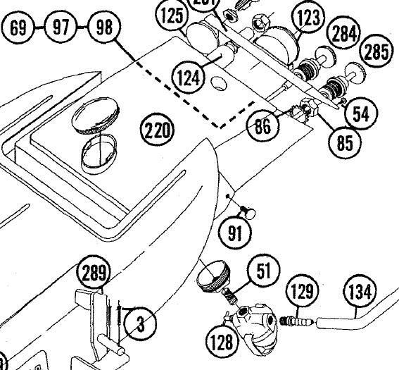

Chrishar 1,054 #1 Posted February 5, 2021 (edited) IHave a 702 gas tank the bottom of the tank leaks, need to know what kind of gasket goes there because it leaking there thanks for any help on this Edited February 5, 2021 by Chrishar Share this post Link to post Share on other sites
Achto 32,927 #2 Posted February 5, 2021 (edited) 32 minutes ago, Chrishar said: IHave a 702 gas tank the bottom of the leaks, need to know what kind of gasket goes there because it leaking there thanks for any help on this Lowell reproduces them. Sounds like some one may have put a newer tank on your tractor. https://wheelhorsepartsandmore.com/product/4452-dual-fuel-tank-gasket-wheel-horse-qty-1/ Edited February 5, 2021 by Achto Share this post Link to post Share on other sites
rmaynard 17,644 #3 Posted February 5, 2021 (edited) I could be wrong, but doesn't the 702 have a one piece tank, no gasket? If it's leaking at the plug, reseal it with a good gasoline resistant thread sealant such as Rectorseal. Edited February 5, 2021 by rmaynard 2 Share this post Link to post Share on other sites
gwest_ca-(File Mod) 12,535 #4 Posted February 6, 2021 The 4405 fuel tank for the 502, 552 and 702 was also used on the 1962 and 1963 Lawn Rangers. See no bushing listed on any of them but the 1961 model 701 shows the bushing but no part number or description. 1 Share this post Link to post Share on other sites
Lane Ranger 12,161 #5 Posted February 6, 2021 7 hours ago, Chrishar said: IHave a 702 gas tank the bottom of the tank leaks, need to know what kind of gasket goes there because it leaking there thanks for any help on this That’s a one piece tank with the big pipe bushing. It can be removed and sealed on threads with a sealer or permatex ( or the tru-blu sealer Bob Maynard posted). The lower threaded nipple should have threads sealed also. You can use a sediment bowl like original or just a simple shut off valve. On the gas line 1 Share this post Link to post Share on other sites

71_Bronco 1,073 #7 Posted February 8, 2021 Interesting. Wonder if it was a left over part. My '62 Lawn Ranger is a 2 piece with the bolt heads under the bottom of the tank. Mine has a little male threaded "nipple" that screws into the top of my aluminum & glass sediment bowl. Share this post Link to post Share on other sites
rmaynard 17,644 #8 Posted February 8, 2021 3 hours ago, Chrishar said: Thanks for the help on this y'all are very helpful and good people thanks again I'm still not totally clear what you were asking @Chrishar. The picture that you posted was obviously a one-piece tank without a gasket. I hope you got the info you needed. Share this post Link to post Share on other sites
