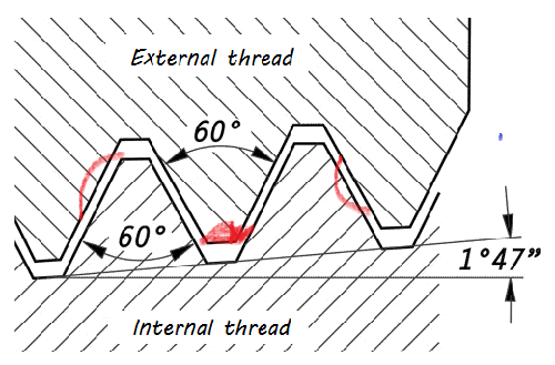

lynnmor 9,037 #15 Posted February 4, 2021 See those little flats at the tip of the external threads and the root of the internal threads? What do you think will fill those gaps? Yes, if tightened enough they might conform. 1 Share this post Link to post Share on other sites
