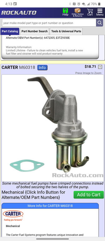

ebinmaine 76,372 #6 Posted February 1, 2021 56 minutes ago, JoeM said: Yeah they match up pretty good. Going from memory. Just wonder what is wrong with the FOMCO one? If the throttle shaft is good probably a rebuild?? That, I don't know. He has a good old school mechanic that has told him it should be replaced. 12 minutes ago, squonk said: fuel pump I'd had that same thought Mike. Could a bad diaphragm in a mechanical pump empty a carburetor? 1 Share this post Link to post Share on other sites
squonk 45,043 #7 Posted February 1, 2021 Is there a return line on the pump? It could siphon back to the tank. 1 Share this post Link to post Share on other sites

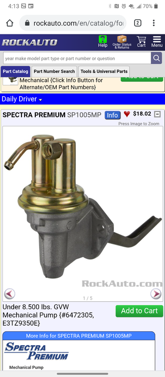

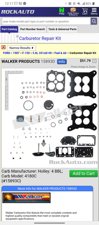

lynnmor 8,341 #9 Posted February 1, 2021 If it has the Holley carb, either one of the two parts with diaphragms is knackered, Just get a kit and rebuild it.' See photo on this site. 1 Share this post Link to post Share on other sites

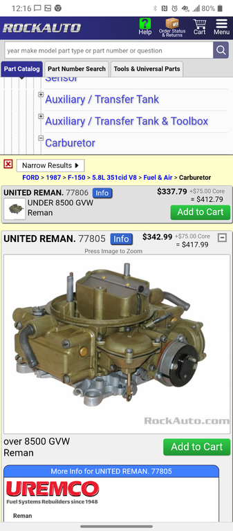

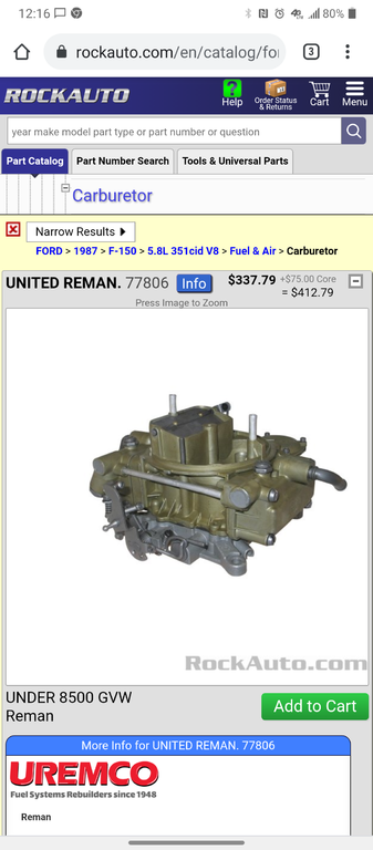

WVHillbilly520H 10,377 #12 Posted February 1, 2021 1 hour ago, ebinmaine said: I'll have to find out from him after the storm... It's an emissions vehicle so it makes sense that there would be a return line According to RockAuto, 86 and 87 same carb basically Holley style model 4180, each to their own, but you couldn't give me 2 Edelbrocks over a Holley style carb for ease of maintenance and tunability, yes they are easier to work on than a Q-Jet but nonetheless I would stick with the Holley style, those older castings and gasket materials as WE all know wasn't designed for Ethanol. Get a kit a rebuild just like those Carter's on the Kohlers. 1 Share this post Link to post Share on other sites

squonk 45,043 #17 Posted February 1, 2021 1 hour ago, lynnmor said: No, I don't know of a carburetor ever made that returned gasoline in the float bowl back to the tank. What I suspect is the carburetor in this thread is leaking down slowly and that gas is going into the engine and probably down into the oil. Not the carb itself but the pump with a return and a bad ck valve can have a siphon start up and suck the fuel back out of a carb. I know pretty far fetched but I had this happen on a motorhome with a Chysler 440 Share this post Link to post Share on other sites
ebinmaine 76,372 #18 Posted February 1, 2021 8 minutes ago, squonk said: Not the carb itself but the pump with a return and a bad ck valve can have a siphon start up and suck the fuel back out of a carb. I know pretty far fetched but I had this happen on a motorhome with a Chysler 440 I've seen it in 70s GM as well. Share this post Link to post Share on other sites
WVHillbilly520H 10,377 #19 Posted February 1, 2021 6 minutes ago, squonk said: Not the carb itself but the pump with a return and a bad ck valve can have a siphon start up and suck the fuel back out of a carb. I know pretty far fetched but I had this happen on a motorhome with a Chysler 440 Doesn't look to be a third fitting on the pump but I am not For guy. 1 Share this post Link to post Share on other sites

WVHillbilly520H 10,377 #25 Posted February 1, 2021 Another thing with that era vehicles and carburetors, a dozen too many vacuum lines and switches, as they harden and shrink cracking and pin holes or broken plastic hose fitting/barbs, just a myriad of possibilities, but I'm still gonna go with the 2 mechanical parts Carb rebuild and fuel pump, then the vacuum lines and maybe even a proper tune-up plugs wires cap and rotor button ect. Even using RockAuto you can buy O.E. Motorcraft replacements... Just trying to help you out, if you can master 1 cylinder the other 7 ain't that bad. 1 Share this post Link to post Share on other sites
