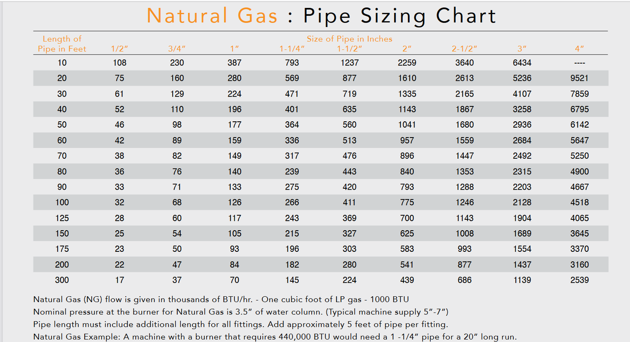

bc.gold 3,406 #2 Posted January 31, 2021 (edited) Builders code for Canada requires the pipe be painted yellow. https://fire-boulder.com/wp-content/uploads/2016/09/Gas-Line-Pipe-Sizing-Chart.pdf Edited January 31, 2021 by bcgold 1 Share this post Link to post Share on other sites

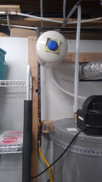

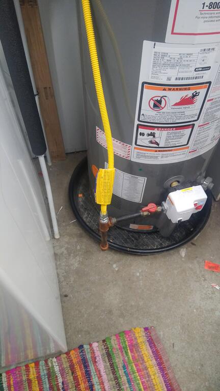

RandyLittrell 3,943 #22 Posted January 31, 2021 4 hours ago, squonk said: Do not use "close nipples" Do not use just any pipe dope. Use Blue Monster or Rector Seal 5. Pretty hard to find USA made black iron fittings around here anyway. Buy good pipe wrenches (Ridgid). I was supplied with a cheap pipe wrench (from Fastenal) at work. The guy I worked with threw it across the room! My Son and I got it all plumbed and happy to say we have no leaks and nothing blew up!!! @squonk I used Harvey brand pipe dope and bought the same brand gas leak check in a little spray bottle. No close nipples and I am glad you guys told me to really tighten them well, I might not have since I have been known to bust things. My Dad had a thing for pipe wrenches so I have at least 20 pipe wrenches from about a 2 1/2 footer to little bitty, all rigid. I even have a rigid pipe chain vise My pex line planning is not really what I wanted, I like things all neat and tidy, but all my pex was done at 2 different times so it is what it is. The good part is I did plan for the shower getting larger lines and being first in line. The better half already took a shower and I was able to flush the toilet and turn on the faucet without affecting the shower!! Share this post Link to post Share on other sites
squonk 45,138 #23 Posted January 31, 2021 Any particular reason you hung the expansion tank horizontal? 1 Share this post Link to post Share on other sites
RandyLittrell 3,943 #24 Posted January 31, 2021 Just now, squonk said: Any particular reason you hung the expansion tank horizontal? That was how it was illustrated in the manual and a couple of youtube videos I watched had it that way. I do need to go get some strapping yet to support it better. If I need to change it, I can. That is the great thing about pex. Randy Share this post Link to post Share on other sites
squonk 45,138 #25 Posted January 31, 2021 All the ones I have replaced have been vertical. Especially the ones you need a forklift to move. 1 1 Share this post Link to post Share on other sites
