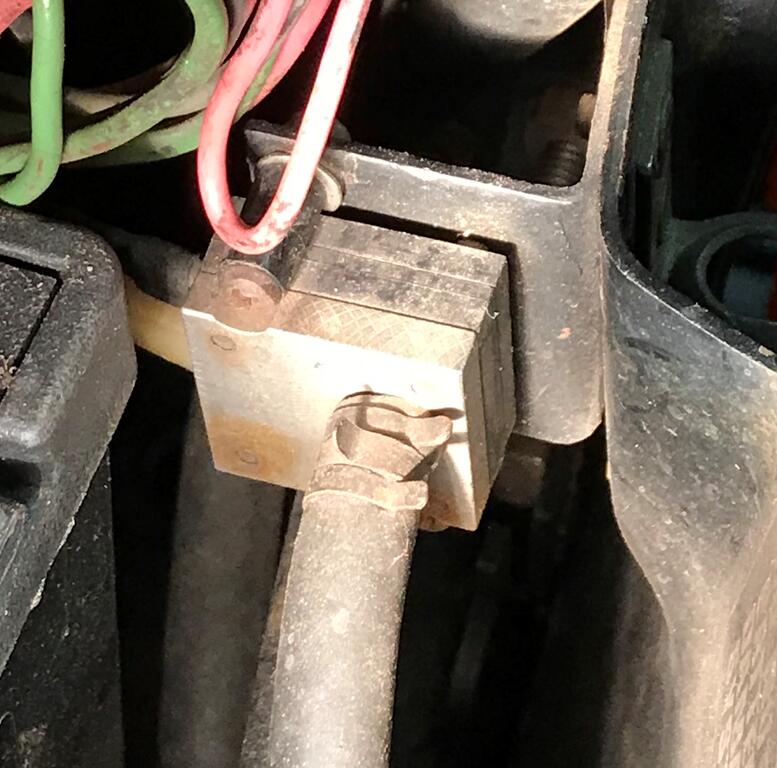

lynnmor 8,970 #9 Posted February 7, 2021 That vacuum hose goes to the inboard side of the air filter. When the filter becomes clogged a vacuum is formed sufficient to operate the switch you found. It is common for these expensive switches to break, I once had the original source where I could buy them at a fair price, but that is becoming difficult. Search for this part number, maybe you can find a source: psf101-8111-150. I have repaired the switches by dressing the nipple side flat and making an aluminum plate with a nipple that is sealed to the dressed surface. Since your switch has additional issues there may be no way to repair it. All the switch does is turn on the air filter warning lamp. If you had an electrical problem there it was just a poor contact where the wires connect to each other. Whatever you do, plug the vacuum hose if it is open to prevent dirt from being drawn into the engine. 1 Share this post Link to post Share on other sites
Handy Don 17,193 #10 Posted February 7, 2021 3 minutes ago, lynnmor said: dressing the nipple side flat and making an aluminum plate with a nipple that is sealed to the dressed surface Hey @lynnmor, if not too much trouble, can you share a pic of this? I've been trying to hack something like this but none have held up. (In between fails, I've been hooking the sensor end of the tube to the other side of the sensor, the pressure side, to keep it closed! So, if the air filter internal pressure rises above 20psi, it'll light up the indicator and I'll be in deep trouble. BTW, you might enjoy a bit of inventive wiring. Since I've merged the topside of a 518-H to the chassis of a 520-H, I discovered that I had a transmission temp sensor but no dashboard indicator light to wire it to. Not wanting to let a good sensor go to waste, I ganged it with the air filter sensor output! So now if I see that light it'll either be the tranny or (once the sensor gets a working nipple) the air filter. Share this post Link to post Share on other sites

lynnmor 8,970 #12 Posted February 8, 2021 1 hour ago, Handy Don said: Hey @lynnmor, if not too much trouble, can you share a pic of this? Here ya go: Share this post Link to post Share on other sites

Handy Don 17,193 #17 Posted February 8, 2021 14 hours ago, lynnmor said: Here ya go: Thanks. I see you went big and covered the entire face. My attempts didn't go as far out and failed. Lesson learned. What did you decide to use for sealing the plate to the face and for securing the ⅛" tubing in the metal plate to form the nipple? Share this post Link to post Share on other sites
lynnmor 8,970 #18 Posted February 8, 2021 I made the aluminum part from a solid, the nipple is incorporated in that. I put a groove in the block to hold a tiny o-ring. Share this post Link to post Share on other sites
Handy Don 17,193 #19 Posted February 8, 2021 24 minutes ago, lynnmor said: I made the aluminum part from a solid, the nipple is incorporated in that. I put a groove in the block to hold a tiny o-ring. Ok, I did ask and you were gracious to answer. Still, that is just plain superman stuff and way out of my realm of tooling and abilities! Last question: It looks like the sensor mounting screws are not holding the plate to the sensor body, so what keeps that o-ring in compression between them? Share this post Link to post Share on other sites
lynnmor 8,970 #20 Posted February 8, 2021 (edited) 1 hour ago, Handy Don said: Ok, I did ask and you were gracious to answer. Still, that is just plain superman stuff and way out of my realm of tooling and abilities! Last question: It looks like the sensor mounting screws are not holding the plate to the sensor body, so what keeps that o-ring in compression between them? There are small screws thru every thing where the rivets are, you can barely see the ends flush with the block. The washers behind the switch is to allow for the screw heads. Edited February 8, 2021 by lynnmor 1 Share this post Link to post Share on other sites
Handy Don 17,193 #21 Posted February 8, 2021 38 minutes ago, lynnmor said: There are small screws thru every thing where the rivets are, you can barely see the ends flush with the block. The washers behind the switch is to allow for the screw heads. Ah! Got it. So you took out the original rivets holding the sensor together and replaced with screws. Very surgical. I like it. Thanks for the insight. I've got a plate I can cut down, drill and tap. I'll send a pic of what I come up with once I get the nipple thing solved. Share this post Link to post Share on other sites
lynnmor 8,970 #22 Posted February 8, 2021 2 hours ago, Handy Don said: Ah! Got it. So you took out the original rivets holding the sensor together and replaced with screws. Very surgical. I like it. Thanks for the insight. I've got a plate I can cut down, drill and tap. I'll send a pic of what I come up with once I get the nipple thing solved. Its been a few years but I think that I used 2-56 screws that were small enough to go thru the holes in the rivets. 1 Share this post Link to post Share on other sites
