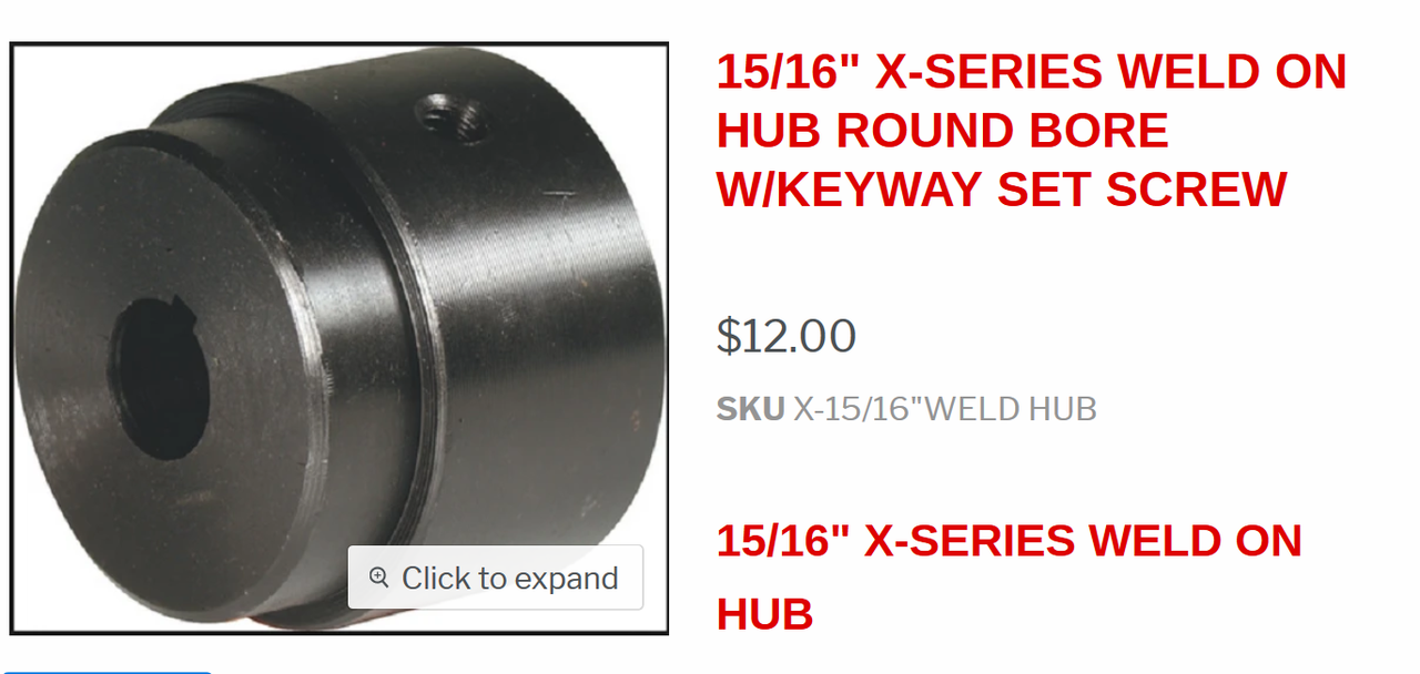

bc.gold 3,406 #12 Posted January 20, 2021 Looks like there's a promising market for reproduction hubs, these would be easy to cast but there is a another soloution. These hubs come in all sizes and have the set screw drilled and threaded with the key way cut in, generally used to weld on a gear but why not a wheel blank instead. As a bonus you could create any bolt pattern for a custom wheel fitment. A shop with a laser could cut the blanks with the holes etc in for threading, the shop that cut out the parts for my oil still did a fantastic job. 5 Share this post Link to post Share on other sites
Maxwell-8 4,367 #13 Posted January 20, 2021 (edited) 3 minutes ago, bcgold said: Looks like there's a promising market for reproduction hubs, these would be easy to cast but there is a another soloution. These hubs come in all sizes and have the set screw drilled and threaded with the key way cut in, generally used to weld on a gear but why not a wheel blank instead. As a bonus you could create any bolt pattern for a custom wheel fitment. A shop with a laser could cut the blanks with the holes etc in for threading, the shop that cut out the parts for my oil still did a fantastic job. I do know an old fab shop, what that old man can make whit those +100 year old machines is just insane. one of his oldest machines has a date stemp of 1870 Edited January 20, 2021 by Maxwell-8 Share this post Link to post Share on other sites

bc.gold 3,406 #15 Posted January 20, 2021 2 minutes ago, Maxwell-8 said: I do know an old fab shop, what that old man can make whit those +100 year old machines is just insane. one of his oldest machines has a date stemp of 1870 Not far from my home there are two shops using old equipment nothing wrong with the equipment but the owners still expect 2021 shop rates. 1 1 Share this post Link to post Share on other sites
ebinmaine 72,379 #16 Posted January 20, 2021 8 minutes ago, bcgold said: Looks like there's a promising market for reproduction hubs, these would be easy to cast but there is a another soloution. These hubs come in all sizes and have the set screw drilled and threaded with the key way cut in, generally used to weld on a gear but why not a wheel blank instead. As a bonus you could create any bolt pattern for a custom wheel fitment. A shop with a laser could cut the blanks with the holes etc in for threading, the shop that cut out the parts for my oil still did a fantastic job. @Greentored Scott has been tossing around the idea of making these. 2 Share this post Link to post Share on other sites
