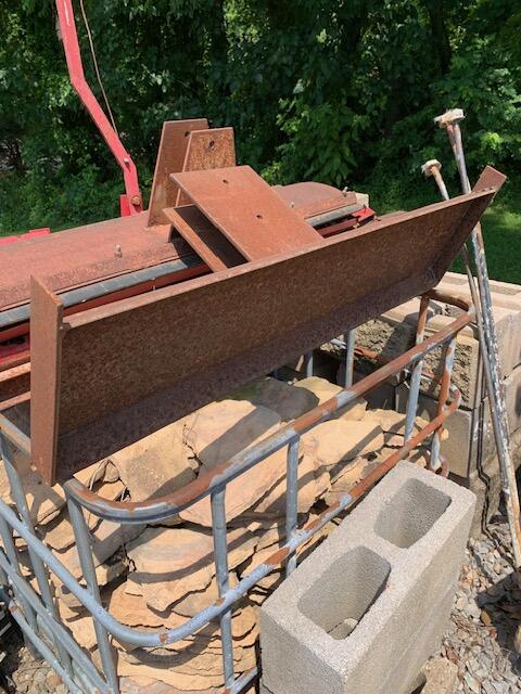

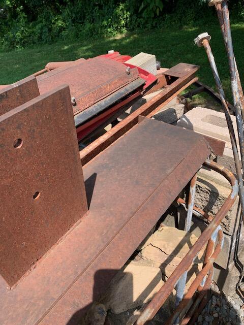

JoeM 10,066 #55 Posted July 12, 2023 5 hours ago, WHX?? said: Little bit of help with a Brinly back blade Okay on loose stuff. looking at the thread made me remember I have this heavy duty dozer blade I made up 25 years ago and used it on a B100 1/2 inch blade man u al turning. attached to a rear snow plow bracket. worked great. should have taken it to the show ands sold it, I also have a snow blade that goes on the frame in place of the heavy dozer blade. the frame is in the background of the second pic. 2 1 Share this post Link to post Share on other sites

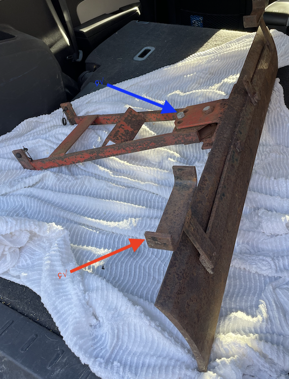

Handy Don 16,851 #56 Posted July 19, 2023 On 7/11/2023 at 9:21 PM, Rick3478 said: The tilt feature is your feet pushing one side down. Simplicity (Allis-Chalmers) had an optional stirrup bracket (red arrow) for their blade to make this easier. It’s on the one I picked up last year. (Just remember that transferring your weight to the blade takes weight off the rear wheels giving traction!) With the Big Show and a family vacation behind me, refurbishing it as a mid-mount blade for my 854 has finally has made it to the top of my projects list! I am trying to figure out a simple mechanism for unlocking/locking the rotation without having to get off the seat and reach under the tractor. Right now, the lock bolt (blue arrow) goes through top and bottom plates on both the plow bracket and the frame. The WH single-pin mechanisms don’t translate well to this blade’s setup which splits the forces onto both sides of the frame and bracket members. A single, sliding pin here would need a lot of travel and some sort of guide for alignment--together, they would probably not leave enough clearance to the underside of the tractor when lifting the blade. That said, I'm thinking short pins--one above and one below--actuated simultaneously by cable with spring returns--possibly internal to the frame. Another thought is notching the blade bracket and adding a retracting locking bar on the frame, again cable actuated. Considering the forces involved, the pins/bar will have to be quite sturdy. Any ideas out there? Last note: like @squonk, I plan to adapt this to the 854 while retaining it’s usability on a Simplicity or Allis. 2 Share this post Link to post Share on other sites
Rick3478 454 #57 Posted July 20, 2023 1 hour ago, Handy Don said: Simplicity (Allis-Chalmers) had an optional stirrup bracket (red arrow) for their blade to make this easier. It’s on the one I picked up last year. (Just remember that transferring your weight to the blade takes weight off the rear wheels giving traction!) With the Big Show and a family vacation behind me, refurbishing it as a mid-mount blade for my 854 has finally has made it to the top of my projects list! I am trying to figure out a simple mechanism for unlocking/locking the rotation without having to get off the seat and reach under the tractor. Right now, the lock bolt (blue arrow) goes through top and bottom plates on both the plow bracket and the frame. The WH single-pin mechanisms don’t translate well to this blade’s setup which splits the forces onto both sides of the frame and bracket members. A single, sliding pin here would need a lot of travel and some sort of guide for alignment--together, they would probably not leave enough clearance to the underside of the tractor when lifting the blade. That said, I'm thinking short pins--one above and one below--actuated simultaneously by cable with spring returns--possibly internal to the frame. Another thought is notching the blade bracket and adding a retracting locking bar on the frame, again cable actuated. Considering the forces involved, the pins/bar will have to be quite sturdy. Any ideas out there? Last note: like @squonk, I plan to adapt this to the 854 while retaining it’s usability on a Simplicity or Allis. Maybe coloring outside the lines a bit, but how about throwing the pin away and make it infinitely adjustable, maybe with a rack-and-pinion of some kind or even an electric jackscrew? Share this post Link to post Share on other sites
Handy Don 16,851 #58 Posted July 20, 2023 1 hour ago, Rick3478 said: Maybe coloring outside the lines a bit, but how about throwing the pin away and make it infinitely adjustable, maybe with a rack-and-pinion of some kind or even an electric jackscrew? What lines? Actually, there are lines--the forces involved. A couple hundred pounds of force out at one end of the blade translates into over thousand at that bolt just 3” out from the pivot pin. That, plus the potential for shock loads dictates the need for a very strong lock. If this were for the 518-H++ that I just upgraded to have remote hydraulics, I’d have a cylinder controlling the rotation in a heartbeat! Maybe I should be searching for an HY unit for the 854! Still, you have given me the idea that perhaps a lever extending the plow bracket would get the force down to a manageable number over the relatively small range of motion needed and make an actuator feasible. Hmmmm. Time for some math and research! Thanks! 1 1 Share this post Link to post Share on other sites

Rick3478 454 #60 Posted July 21, 2023 On 7/19/2023 at 10:00 PM, Handy Don said: What lines? Actually, there are lines--the forces involved. A couple hundred pounds of force out at one end of the blade translates into over thousand at that bolt just 3” out from the pivot pin. True, but if you abandon the position pin or bolt being that close to the pivot, you can pick a mounting point with better leverage and lower forces. Trade out force for distance until you find something workable. Share this post Link to post Share on other sites
Handy Don 16,851 #61 Posted July 21, 2023 (edited) 49 minutes ago, Rick3478 said: True, but if you abandon the position pin or bolt being that close to the pivot, you can pick a mounting point with better leverage and lower forces. Trade out force for distance until you find something workable. On 7/19/2023 at 10:00 PM, Handy Don said: Still, you have given me the idea that perhaps a lever extending the plow bracket would get the force down to a manageable number over the relatively small range of motion needed and make an actuator feasible. Hmmmm. Time for some math and research! Thanks! Yep, as I posted So far research on moderately priced electric actuators shows 600-900 N static force limits. 900 N x 0.22 lb/N ==> 198 lbs. To balance a 198 lb. force at the end of the blade it’d require a 21” lever, which would extend to around the front axle. At that length, I would need a 14” throw on the actuator (7” on either side of straight) to get the same 20º blade angles. Actuators move at about 0.4” per second so a full change of angle would take over 30 seconds. Not looking promising. Edited July 21, 2023 by Handy Don Share this post Link to post Share on other sites
