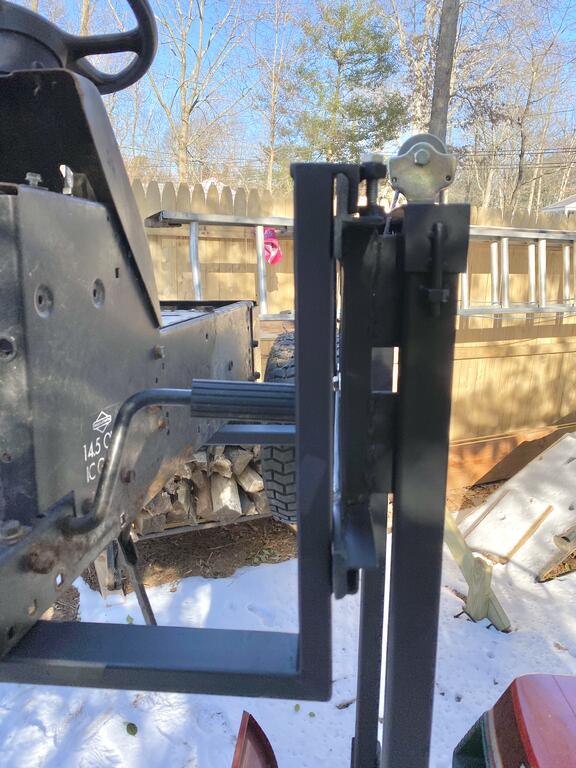

elcamino/wheelhorse 9,363 #26 Posted January 21, 2021 @BeninCT Some times I tend to over think things. I think as the unit is tilted out from the tractor , it will tend to push the front end down and stress where the frame and trans meet . A sub frame from the front all the way to the rear axle and beyond, will keep the rear end and your body flying up in the air. 2 Share this post Link to post Share on other sites
BeninCT 451 #27 Posted January 21, 2021 8 minutes ago, elcamino/wheelhorse said: @BeninCT Some times I tend to over think things. I think as the unit is tilted out from the tractor , it will tend to push the front end down and stress where the frame and trans meet . A sub frame from the front all the way to the rear axle and beyond, will keep the rear end and your body flying up in the air. Agreed- part of the reason I am building this instead of a true FEL is the keep the loads as close to the tractor as possible to reduce their leverage on the tractor (spindles/frame etc.) and I am definitely and over thinker! No experience adding to one of these so happy to explore all thoughts- my first would be to try to compare the weight of a front mount snow blower to this forklift to see how they compare (considering a load on the forks too). I am guessing they are well over 100 lbs so if the front attach a matic can hold that then I should be ok given the added attachment points but only time will tell. It’s admittedly light in its construction so will have to try to just use it for light loads like I said. Try at least 2 Share this post Link to post Share on other sites

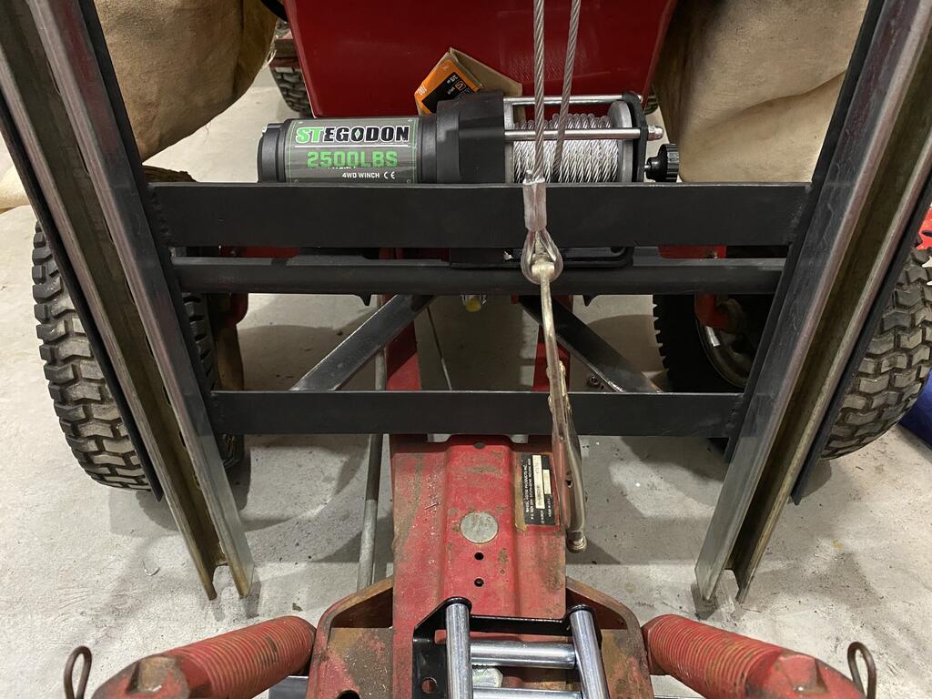

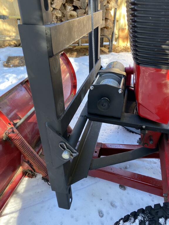

BeninCT 451 #28 Posted January 24, 2021 Took a few more bites today after getting some parts in the mail. Looks like I will have to make a new bumper to mount it all on. Was planning to put the winch under the tractor or under the bumper but its going to make more sense to mount it on the bumper mainly so I can leave it on the tractor when the forklift is off and not have to take all the wiring etc.. off. Not surprised that I have to make a piece again considering the level of complication for my first real act of fabrication. Overall I am pretty fired up about its future utility though. I feel like I am striking the perfect mix of strength and light weight so it will be as light as possible but I suspect be able to handle the occasional really heavy load. Maybe need to unload a heavy item from the truck so I could block up the axle and lift it and drive the truck out from under it and just set it down- no driving. But in general I think it will handle 200 lbs like nothing. Spindles be damned 😱 Keep having to remind myself that it will prob weigh 80-90lbs when finally assembled. Anyone think I should upgrade my spindles/wheels or can I get away with a welded brace on them? 2 Share this post Link to post Share on other sites

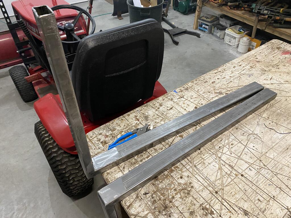

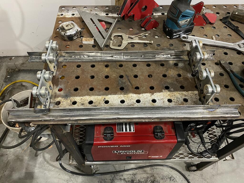

BeninCT 451 #39 Posted January 27, 2021 Few more steps today... its gonna weigh more than 100 lbs though now that I am getting to the end... 1x2 forks. Bought the steel on amazon of all places- winch on bumper/wired up unistrut dollies welded to the fork carriage. 3 Share this post Link to post Share on other sites

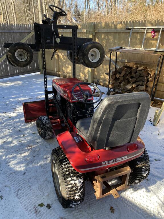

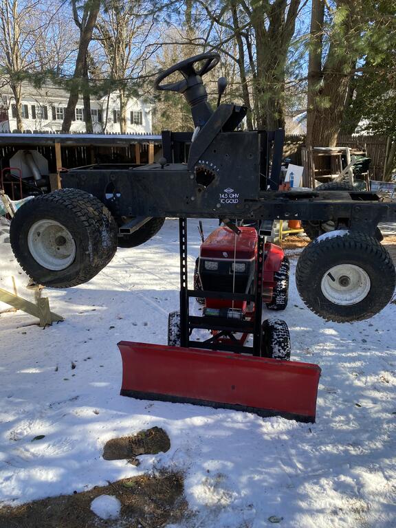

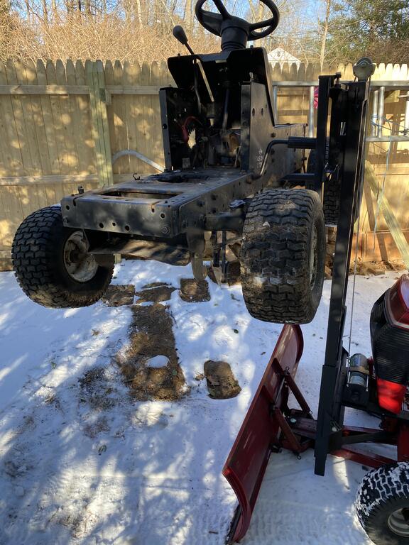

BeninCT 451 #40 Posted January 30, 2021 Been working at it here and there and its finally running! I am guessing the whole rig weighs about 110-120lbs which is more than I wanted but its tough to build something to lift like this and make it light. Check it out! Please offer comments and criticisms. Still a bunch to do but it easily lifts me at 230lbs sitting on a 2x10 on the forks. Think this tractor chassis was maybe 80-90? 2 Share this post Link to post Share on other sites
BeninCT 451 #41 Posted January 30, 2021 Couple more 2 Share this post Link to post Share on other sites
ebinmaine 80,935 #43 Posted January 30, 2021 EXCELLENT work Sir. Very nicely done. Looks quite solid. The only "suggestion" I'd have is to consider a counterweight at the rear equal to the lifted weight. Adds safety and also helps traction. If you have a YouTube channel I'd love to see a video of that in operation. 1 Share this post Link to post Share on other sites
elcamino/wheelhorse 9,363 #44 Posted January 30, 2021 Excellent ! Counter on rear as Eric suggested, you already have the hitch on the rear to start the counter weight. It would be nice to see how you picked up the tractor with the snow blade on the front. 2 Share this post Link to post Share on other sites
ebinmaine 80,935 #45 Posted January 30, 2021 9 minutes ago, elcamino/wheelhorse said: . It would be nice to see how you picked up the tractor with the snow blade on the front. Magic floating tractor method 1 Share this post Link to post Share on other sites

BeninCT 451 #49 Posted January 31, 2021 4 hours ago, ebinmaine said: EXCELLENT work Sir. Very nicely done. Looks quite solid. The only "suggestion" I'd have is to consider a counterweight at the rear equal to the lifted weight. Adds safety and also helps traction. If you have a YouTube channel I'd love to see a video of that in operation. Thanks lot of grinding on ugly waves of bad welding but getting better slowly. Think it will stay black to not highlight my welding “skills”. Counter weight is an interesting thought- I had my weight on the forks this morning and bounced a couple times pretty hard on it. The font tires compressed but I think the tractor could handle 3-4 times my weight before it the back wheels even considered leaving the ground. The front spindles I think are the weak point but something else would def give way before that much weight could be applied. I built these forks because I didnt like the leverage and weight that a FEL would put on this little tractor as stout as it is. Tractor also drove with that weight off the ground pretty easily. Are the larger spindles and 8” wheels that can be swapped into this model? Share this post Link to post Share on other sites
BeninCT 451 #50 Posted January 31, 2021 4 hours ago, elcamino/wheelhorse said: Excellent ! Counter on rear as Eric suggested, you already have the hitch on the rear to start the counter weight. It would be nice to see how you picked up the tractor with the snow blade on the front. I have the wheel weights on the rears and no sign of any lift out back when that tractor frame was on the forks so I think I am good. Will see though- Had to put it on there with my hands! Steel on steel so it slid right on but I am too lazy to take off the plow with snow coming Monday lol. 2 Share this post Link to post Share on other sites
