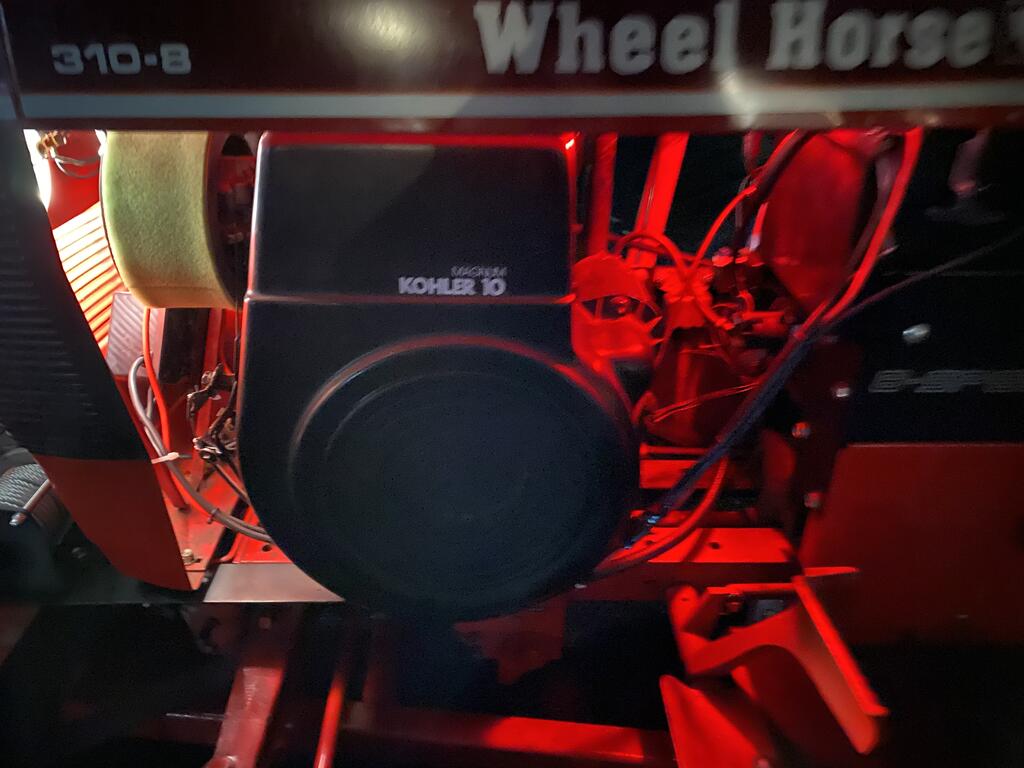

BeninCT 451 #32 Posted January 27, 2021 (edited) Finally had it out in the dark. 👹 Edited January 27, 2021 by BeninCT 1 1 Share this post Link to post Share on other sites
ebinmaine 80,765 #33 Posted January 27, 2021 Now that's just SNAZZY 1 Share this post Link to post Share on other sites

BeninCT 451 #36 Posted January 27, 2021 18 hours ago, ebinmaine said: Now that's just SNAZZY It looks killer at night- key is to keep it up so yo don’t see the source just the light in the engine bay. Thx 1 Share this post Link to post Share on other sites

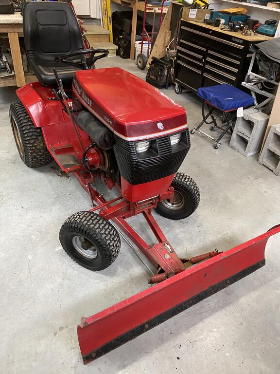

Jeff-C175 7,211 #38 Posted January 27, 2021 (edited) That's a real nice looking machine Ben! I wish my plow blade was that nice. The P.O. ran it to the ground. About an inch or so is ground off the bottom and more on one side. The frame is a little twisted, need to straighten that up. I've gotta get a piece welded back on and drilled for a new scraper bar. I also want to put 'mushrooms' on it so I don't dig the gravel drive and private road. I haven't yet looked at the thread about the FEL but I will now! The pic I would like to see is at night from a distance with the underhood LEDs lit up! @BeninCT Edited January 27, 2021 by Jeff-C175 Share this post Link to post Share on other sites

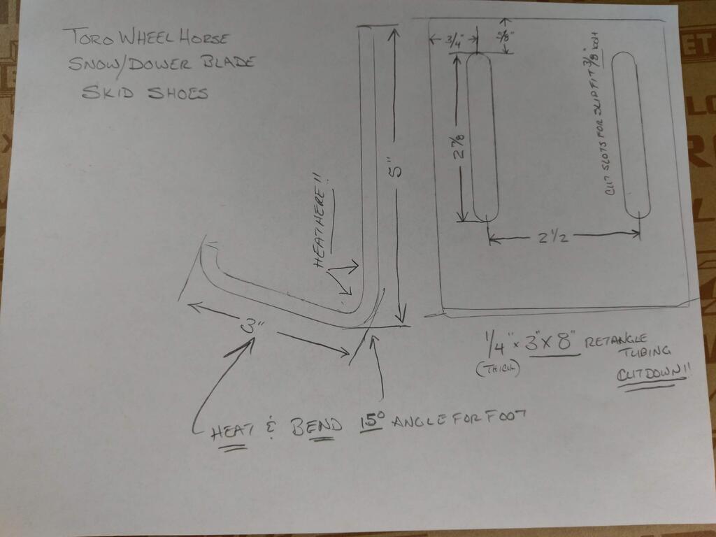

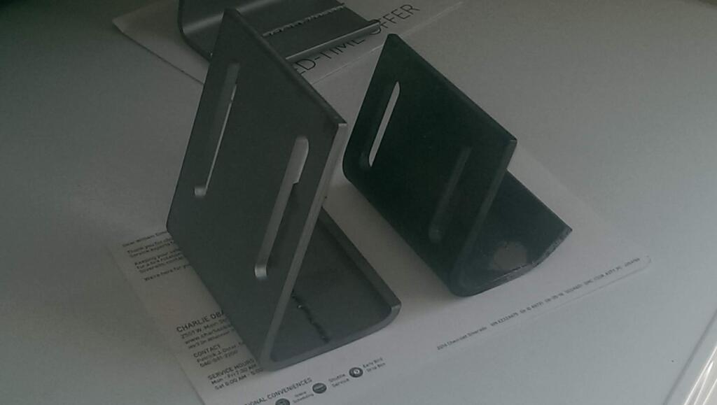

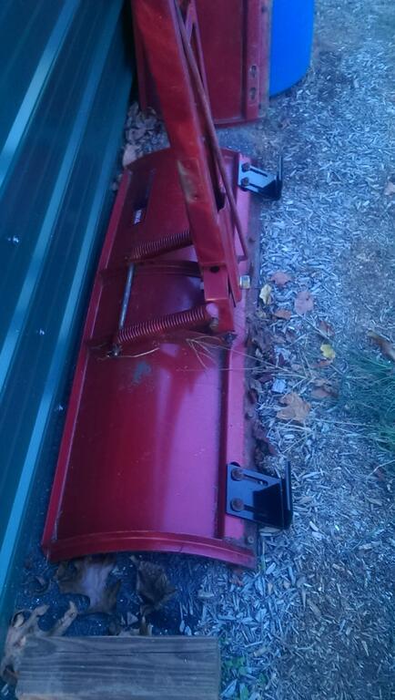

WVHillbilly520H 10,379 #41 Posted January 27, 2021 (edited) 36 minutes ago, Jeff-C175 said: Not to hijack the thread... but real quick... Sounds like what I did to my snowblower. A 'ski' of sorts. But on the plow wouldn't it 'drag' sideways if you had the plow angled? I use sections of 2" gray PVC pipe over the scraper bar and also have a piece of horse stall rubber sammiched in between the blade and scraper bar now that's working fairly well but the PVC pipe tends to slide off the end if I go with angled plow. Mebbe later I'll take some pics and start another thread... so Ben can get his thread back. They were offered from the factory in just re-engineered them for more adjustability... The lift one is mine the right one is factory. Blueprint as well but only if your blade has the factory carriageway bolt holes in the lower reinforcement. Edited January 27, 2021 by WVHillbilly520H 2 Share this post Link to post Share on other sites

BeninCT 451 #43 Posted January 28, 2021 @Jeff-C175 yak away man I enjoy it all. Got my plow from another forum member in CT for a fair price. I cheated a bit with some spray paint too.. guilty 1 1 Share this post Link to post Share on other sites
