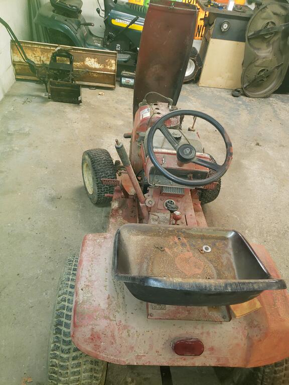

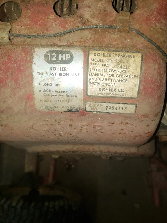

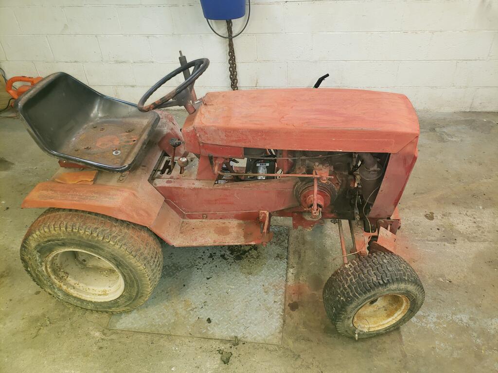

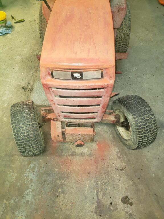

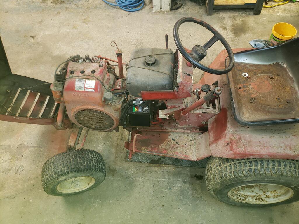

MoneyBagz 33 #1 Posted January 11, 2021 I just picked this up from my father in law. Buddy and I got it running the next day. But can't seem to find out what year it is. As someone did a crappy paint job on it. I see no tags. Only on the kohler engine. I will be restoring it and using it. I need to find out what plow attachment I can get. And its missing the air cleaner cover. I'm new to the wheel horse tractors. 3 1 Share this post Link to post Share on other sites
ebinmaine 80,115 #3 Posted January 11, 2021 Given the fact that you have a C120 with what appears to be no holes for hood ornament you have a 1976 or 1977. Absolutely wonderful tractor. There are plows available for those that will cover the years of 1967 all the way to some into the 2000s. A long frame plow. It has two parallel frame pieces. You've absolutely found the best possible resource for a Wheelhorse. 3 1 Share this post Link to post Share on other sites

Pullstart 71,016 #5 Posted January 11, 2021 look on the small area between the lift handle and the engine for a tag on the tractor. That’s where it should be, anyway. 3 Share this post Link to post Share on other sites

Maxwell-8 4,371 #8 Posted January 11, 2021 21 minutes ago, MoneyBagz said: onapart from the paint, i think it's solid. I don't think it's an OEM seat, rather an MTD seat i think. I would wanne replace that because it's hard on your bud when riding over bumps. You got a mowing deck for it? you do have the pulley for it up front. Share this post Link to post Share on other sites
ebinmaine 80,115 #10 Posted January 11, 2021 10 minutes ago, Maxwell-8 said: OEM seat It's possible that's the pan frame from the original seat that has had the upholstery and foam removed. Share this post Link to post Share on other sites
roadapples 6,987 #11 Posted January 11, 2021 14 minutes ago, ebinmaine said: It's possible that's the pan frame from the original seat that has had the upholstery and foam removed. better get a pillow. Those screw heads will hurt... 1 2 Share this post Link to post Share on other sites

MoneyBagz 33 #13 Posted January 11, 2021 1 hour ago, Maxwell-8 said: onapart from the paint, i think it's solid. I don't think it's an OEM seat, rather an MTD seat i think. I would wanne replace that because it's hard on your bud when riding over bumps. You got a mowing deck for it? you do have the pulley for it up front. Yea I got the mower deck. Just got to go back and pick it up from the father in law. The seat cushion I have but its in rough shape. 1 Share this post Link to post Share on other sites
gwest_ca-(File Mod) 12,421 #14 Posted January 11, 2021 With an early 1976 Kohler serial number there is a good chance the tractor is a 1976 model also. Click on the picture or fuzzy picture in each link for more info Garry 1 Share this post Link to post Share on other sites

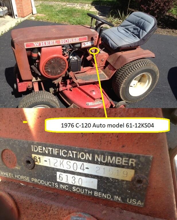

gwest_ca-(File Mod) 12,421 #15 Posted January 11, 2021 Here is where the ID plate should be in 1976 1 Share this post Link to post Share on other sites

MoneyBagz 33 #17 Posted January 12, 2021 2 hours ago, gwest_ca said: Here is where the ID plate should be in 1976 Yea mines missing Share this post Link to post Share on other sites

ebinmaine 80,115 #20 Posted January 12, 2021 1 hour ago, MoneyBagz said: Yea mines missing You could call it a 76 or 7. Either would be fine for parts lookup. 1 Share this post Link to post Share on other sites

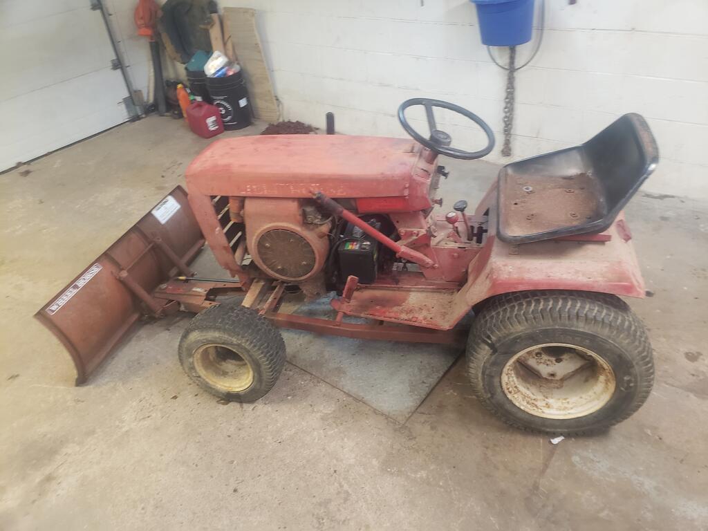

MoneyBagz 33 #25 Posted January 25, 2021 Update for the day. Wheelhorseguy hooked me up with a plow. After 4 hrs of road time to get it. Got it unloaded and put on the tractor. 9 Share this post Link to post Share on other sites
