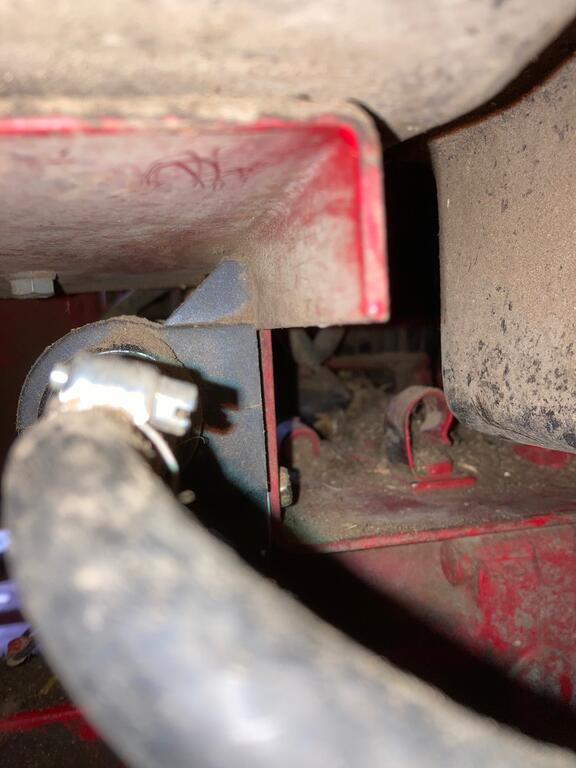

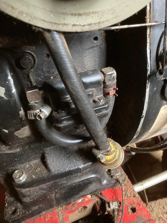

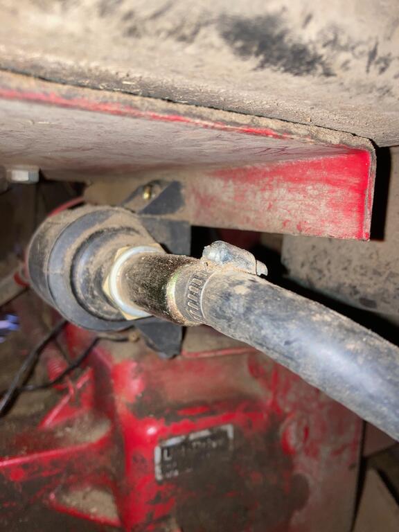

biged77 113 #20 Posted January 11, 2021 Here's another vote for electric. For my 414-8 I bought a Mr.Gasket 42S from O'Reilleys for $44 a few years ago and have had no problems. Mounted it under the seat (see photos). Had to drill one hole, the second one was already there. As a previous member suggested I installed tubing from the inlet to outlet of the existing pump to seal it off (see photo which also shows the fuel filter). Some folks remove the existing pump and install a blankoff plate. I have seen these for sale somewhere on line, don't remember where. To power the pump I ran wires from the lighting circuit and disconnected the lights. I planned on adding a separate switch but for now just use the light switch. The vendor says 2 amp draw max, I checked mine and it was quite a bit less so no problem for my 15 amp system. 4 Share this post Link to post Share on other sites
ebinmaine 74,515 #21 Posted January 11, 2021 9 minutes ago, biged77 said: Here's another vote for electric. For my 414-8 I bought a Mr.Gasket 42S from O'Reilleys for $44 a few years ago and have had no problems. Mounted it under the seat (see photos). Had to drill one hole, the second one was already there. As a previous member suggested I installed tubing from the inlet to outlet of the existing pump to seal it off (see photo which also shows the fuel filter). Some folks remove the existing pump and install a blankoff plate. I have seen these for sale somewhere on line, don't remember where. To power the pump I ran wires from the lighting circuit and disconnected the lights. I planned on adding a separate switch but for now just use the light switch. The vendor says 2 amp draw max, I checked mine and it was quite a bit less so no problem for my 15 amp system. Is that a vane style pump with only a slight whine? Not a hammering type? 1 Share this post Link to post Share on other sites

biged77 113 #23 Posted January 12, 2021 @ebinmaine - Yes it's a rotary pump, just a slight whine. I let it run about 5 seconds before starting. 2 Share this post Link to post Share on other sites
