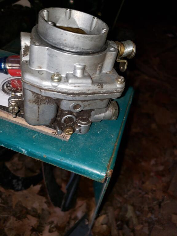

Tom kite 3 #15 Posted January 11, 2021 15 hours ago, Handy Don said: Thanks for adding more information. When you were cleaning, did you use carburetor cleaning fluid? The best ones are under pressure and have a "straw" that you can use to squirt the fluid directly with pressure into the carb openings (be very careful to use eye protection when you do this!) Were you able to let the fluid soak in the carb for several hours? The fuel pump you mention, is that the one attached to the engine and the filter the one between the pump and the carb? Is the filter transparent and, if yes, can you see fuel flowing through it when the engine is running (the filter will not "fill up", and the pump normally produces small "spurts" of fuel into the filter)? I think the carb you are using has only one needle screw, and that is for the idle mixture. (The "set screw" on the side covers a fixed main high speed jet.) On the original carb, that needle screw should be gently screwed inward until you feel resistance and then turned outward 1 ¼ turns as an initial setting. There should be a small round disk set into the body of the carb directly above the needle screw. Is that in place, or is there a hole in the side of the carb in that spot? Can you take a close-up and clear picture of the side of the carb with the needle valve screw and post it here, please? 13 hours ago, richmondred01 said: Did they send you the correct carb? lots of the knock offs fit but they are the same for the p216, p216 and p220. However, each one is jetted differently. im just saying you may have bought a p220 carb but in reality it’s a p216 carb. Something to consider. j Share this post Link to post Share on other sites

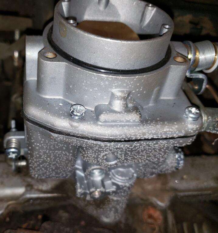

Tom kite 3 #16 Posted January 11, 2021 thats the new one Share this post Link to post Share on other sites
Tom kite 3 #17 Posted January 11, 2021 15 hours ago, Handy Don said: Thanks for adding more information. When you were cleaning, did you use carburetor cleaning fluid? The best ones are under pressure and have a "straw" that you can use to squirt the fluid directly with pressure into the carb openings (be very careful to use eye protection when you do this!) Were you able to let the fluid soak in the carb for several hours? The fuel pump you mention, is that the one attached to the engine and the filter the one between the pump and the carb? Is the filter transparent and, if yes, can you see fuel flowing through it when the engine is running (the filter will not "fill up", and the pump normally produces small "spurts" of fuel into the filter)? I think the carb you are using has only one needle screw, and that is for the idle mixture. (The "set screw" on the side covers a fixed main high speed jet.) On the original carb, that needle screw should be gently screwed inward until you feel resistance and then turned outward 1 ¼ turns as an initial setting. There should be a small round disk set into the body of the carb directly above the needle screw. Is that in place, or is there a hole in the side of the carb in that spot? Can you take a close-up and clear picture of the side of the carb with the needle valve screw and post it here, please? Share this post Link to post Share on other sites

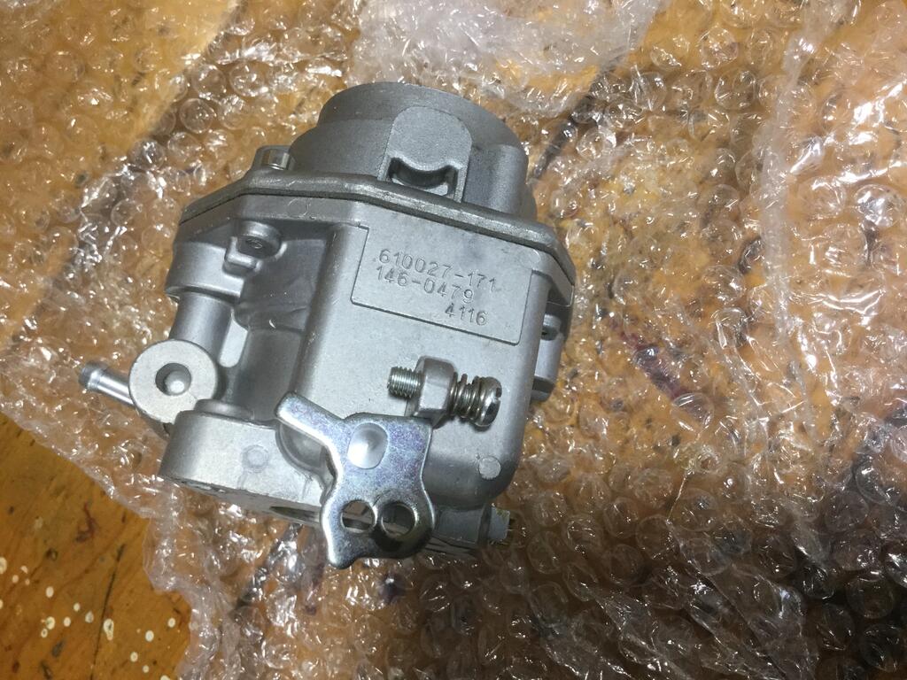

richmondred01 2,393 #18 Posted January 11, 2021 Is it a Nikki carb? If so it should have it stamped into the carb along with part number. Share this post Link to post Share on other sites

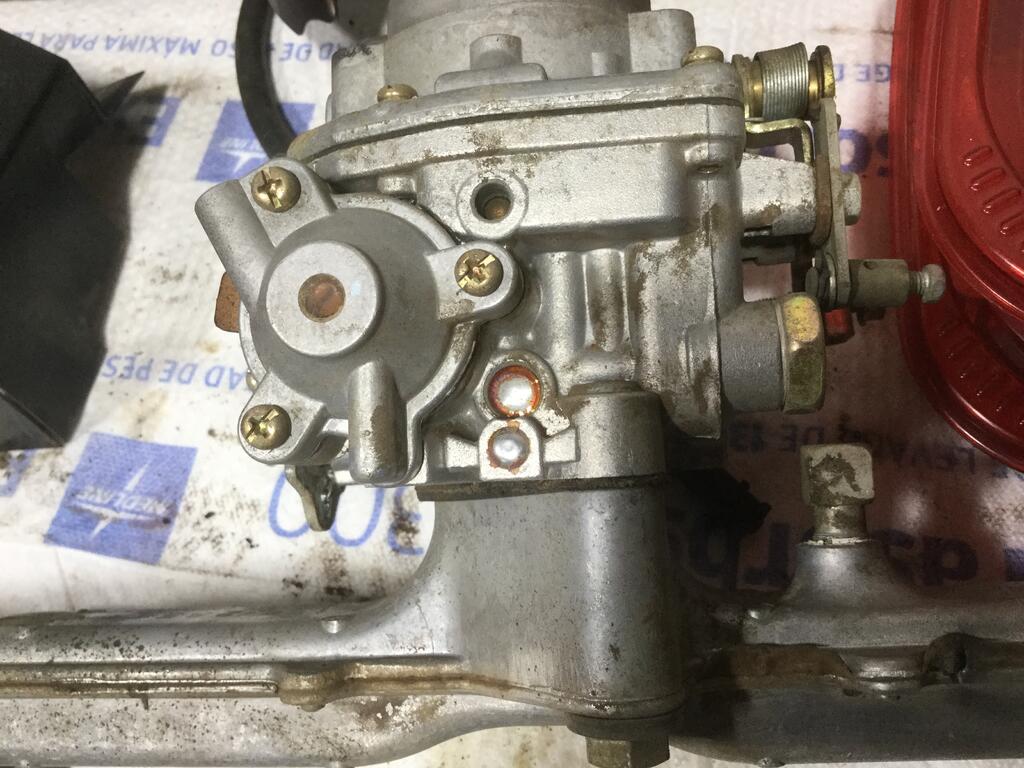

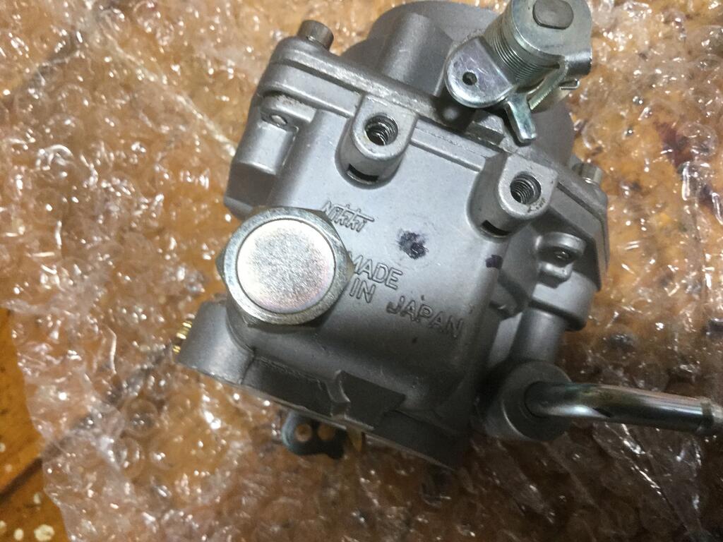

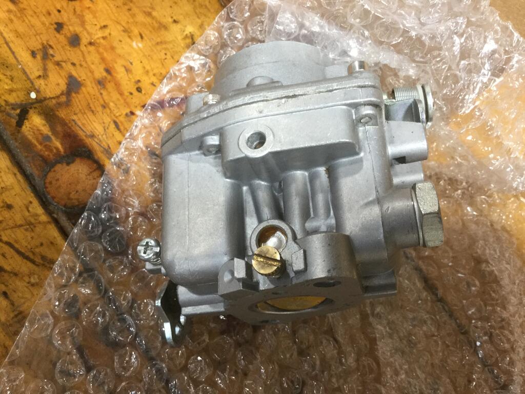

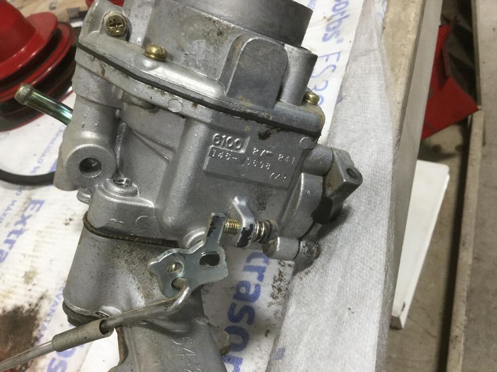

Handy Don 17,670 #19 Posted January 11, 2021 1 hour ago, Tom kite said: thats the new one Hello. Also interested in @richmondred01's question about whether either or both carbs are Nikkis. At the same time, please look carefully at both your old and new carbs where I've pointed with the red arrow and compare them to the same place on a working carb (mine!) in the next image. From the image of your new one, it looks like there is hole into the body of the carb and on mine there is a plug of metal covering that hole. That is a Welch Plug and it seals off that hole for both air and fuel. Without it, the carb cannot function correctly and the engine will never run without choke (nor will it idle or run at full throttle correctly). Let us know what you find. Share this post Link to post Share on other sites
richmondred01 2,393 #21 Posted January 11, 2021 What markings are on the new carb? Share this post Link to post Share on other sites
Tom kite 3 #22 Posted January 11, 2021 49 minutes ago, Handy Don said: Hello. Also interested in @richmondred01's question about whether either or both carbs are Nikkis. At the same time, please look carefully at both your old and new carbs where I've pointed with the red arrow and compare them to the same place on a working carb (mine!) in the next image. From the image of your new one, it looks like there is hole into the body of the carb and on mine there is a plug of metal covering that hole. That is a Welch Plug and it seals off that hole for both air and fuel. Without it, the carb cannot function correctly and the engine will never run without choke (nor will it idle or run at full throttle correctly). Let us know what you find. Share this post Link to post Share on other sites

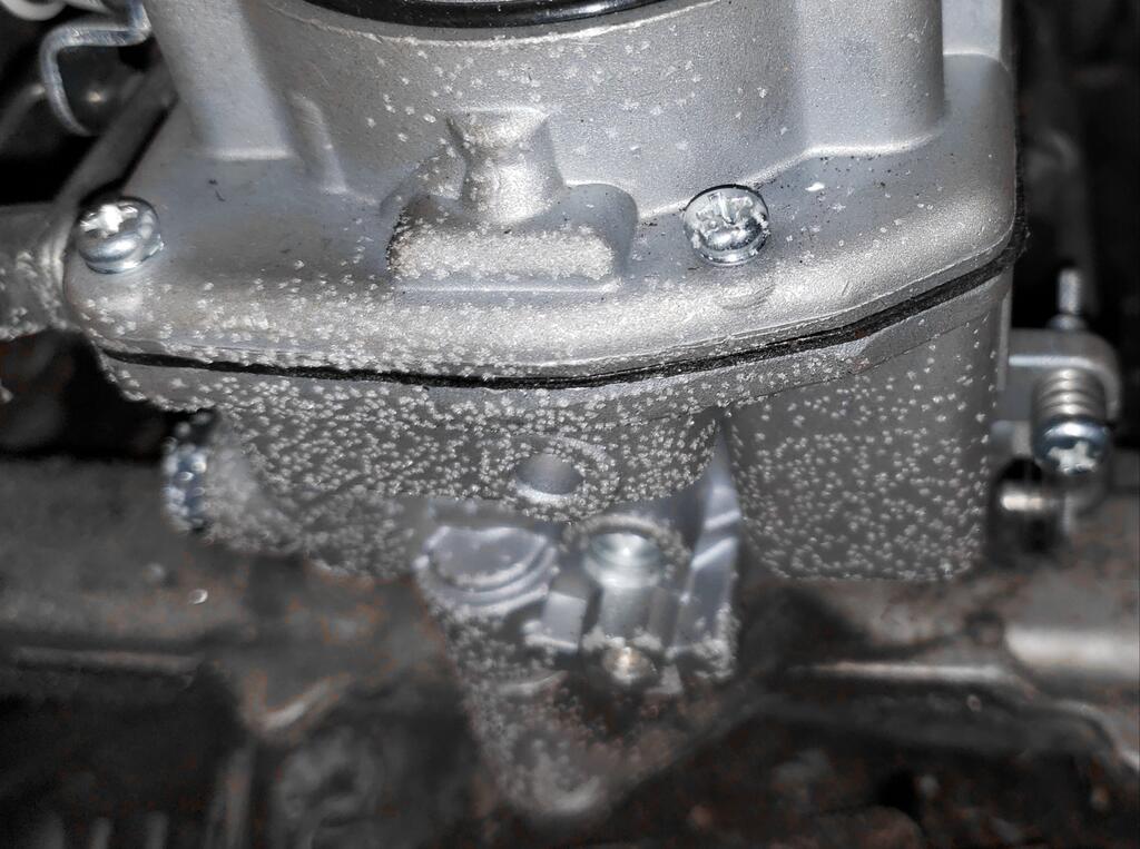

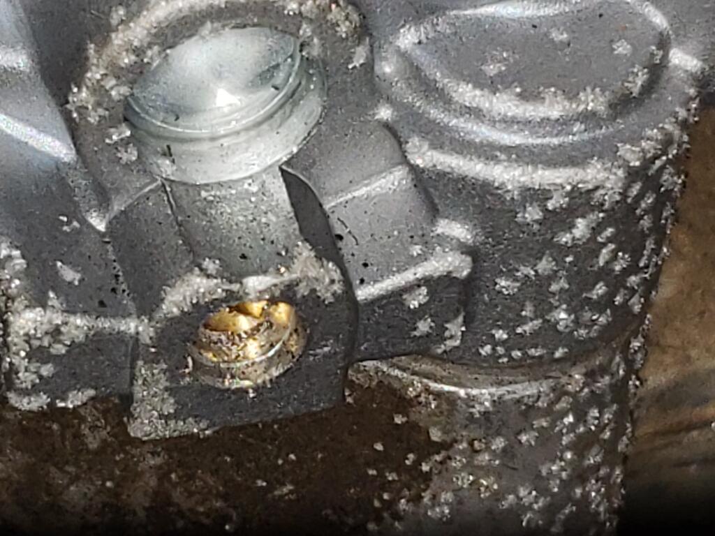

Handy Don 17,670 #25 Posted January 11, 2021 It looks like a pre-emissions carb (no external accelerator pump) and that the welch plug is in place (red arrow). But I'm wondering what's going on where the idle jet screw is supposed to be (blue arrow). The image isn't clear but it looks like corrosion and an exposed jet seat or a broken off needle screw. 1 Share this post Link to post Share on other sites
