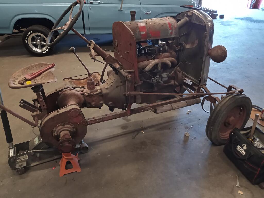

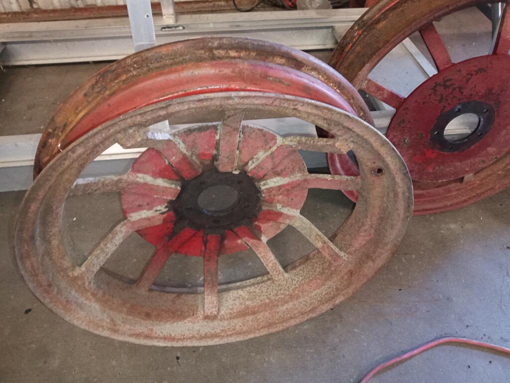

Danny101 26 #1 Posted January 8, 2021 Hello All, new guy here hoping that someone can help me with the rear tire size needed for this Speedex / Pond FG that I am beginning to restore. The rear tires had completely disintegrated and were unreadable when I acquired this old girl. I'm hoping that someone here will know the correct tire size needed. I believe these are the original rims. Any help is much appreciated! This is my first tractor to attempt to restore so please go easy on me, lol. 3 8 1 Share this post Link to post Share on other sites

Lee1977 7,807 #3 Posted January 8, 2021 Old tractor tire sizes are the tire width x the rim diameter. The tire can be wider then the rim. 1 Share this post Link to post Share on other sites

elcamino/wheelhorse 9,363 #5 Posted January 8, 2021 We need more pictures of the entire tractor. What a find. 2 Share this post Link to post Share on other sites

oliver2-44 11,791 #7 Posted January 9, 2021 from another Texas. There a few of us Texans on here @ZXT May we ask where you found that. Please start a thread here on your restoration so we can follow along. You will also find lots of helpful advice here along with the friendliest people 9 and a little good natured ribbing one you've been around awhile. So does that have a Model T Radiator, Engine, Clutch, Transmission, Steering and just a Speedex/Pond rear end? I see Odem is near Corpus Christi, I was just down there right before Thanksgiving, and may be going again next week. 3 Share this post Link to post Share on other sites

oldiron613 590 #9 Posted January 9, 2021 Wow, an FG Lowboy! That's a super cool find. The rear tires are tough to find and expensive being 22". Firestone 7.50x22 Firestone tires through ME Miller tire (when they have them) will be your best and possibly only bet. Congrats again, and good luck! Rob 4 Share this post Link to post Share on other sites

ZXT 2,402 #11 Posted January 9, 2021 (edited) 59 minutes ago, oliver2-44 said: So does that have a Model T Radiator, Engine, Clutch, Transmission, Steering and just a Speedex/Pond rear end? Jim, the engine/trans are Model A. Rear end looks to be T. Edited January 9, 2021 by ZXT 1 Share this post Link to post Share on other sites
Stepney 2,356 #12 Posted January 9, 2021 (edited) Never seen that one.. what a machine too. I had a much larger Worthington with a Model A engine. Whole lot of power for a little rig like that, when the Gibson and early PK tractors were still sporting a Briggs 7.25, or a Wisconsin 8.. Love the truck too! Looks like my old girl.. Does it have any sort of PTO to actually put the 40 horse engine to work? Edited January 9, 2021 by Stepney 3 Share this post Link to post Share on other sites

Pullstart 71,482 #17 Posted January 9, 2021 and cool tractor! What are the rollers on the frame next to the engine? @Jennifer had some rear tires, I don’t recall the size but they wouldn’t work for my needs. 1 Share this post Link to post Share on other sites
Oldskool 6,678 #18 Posted January 9, 2021 58 minutes ago, pullstart said: and cool tractor! What are the rollers on the frame next to the engine? @Jennifer had some rear tires, I don’t recall the size but they wouldn’t work for my needs. I was wondering about the rollers as well Share this post Link to post Share on other sites
Danny101 26 #19 Posted January 10, 2021 (edited) On 1/9/2021 at 10:18 AM, pullstart said: and cool tractor! What are the rollers on the frame next to the engine? @Jennifer had some rear tires, I don’t recall the size but they wouldn’t work for my needs. I believe that the rollers are there to assist with tight turns and to keep the tires off of the frame. There are 3 wooden rollers on the right side but only one on the left side. The rollers on the right are on a metal bar and as one was used up, the next one could be slid up to the front. I guess they didn't turn to the left very much back then. Edited January 10, 2021 by Danny101 clarify 2 1 1 Share this post Link to post Share on other sites

Danny101 26 #23 Posted January 10, 2021 On 1/8/2021 at 7:53 PM, ZXT said: Jim, the engine/trans are Model A. Rear end looks to be T. I was told that it was Model A engine & transmission and Model T rear 1 Share this post Link to post Share on other sites
Danny101 26 #24 Posted January 10, 2021 On 1/8/2021 at 7:12 PM, oldiron613 said: Wow, an FG Lowboy! That's a super cool find. The rear tires are tough to find and expensive being 22". Firestone 7.50x22 Firestone tires through ME Miller tire (when they have them) will be your best and possibly only bet. Congrats again, and good luck! Rob I am going to get my local tire shop to try those Share this post Link to post Share on other sites
Danny101 26 #25 Posted January 10, 2021 On 1/8/2021 at 7:02 PM, oliver2-44 said: from another Texas. There a few of us Texans on here @ZXT May we ask where you found that. Please start a thread here on your restoration so we can follow along. You will also find lots of helpful advice here along with the friendliest people 9 and a little good natured ribbing one you've been around awhile. So does that have a Model T Radiator, Engine, Clutch, Transmission, Steering and just a Speedex/Pond rear end? I see Odem is near Corpus Christi, I was just down there right before Thanksgiving, and may be going again next week. It came in to my auction barn in this condition several months ago and I am just now getting around to it. It is Model A radiator & shroud, engine and trans with Model T rear end Share this post Link to post Share on other sites
