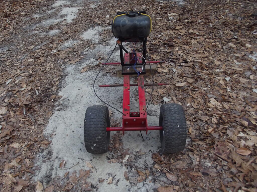

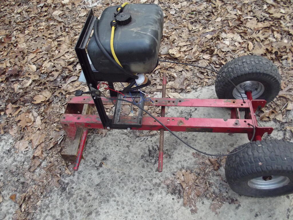

JAinVA 4,636 #3 Posted January 6, 2021 (edited) I have a couple Kohler rebuilds to test and I had several used engines to test as well. I wanted to test the used engines without dealing with nasty fuel systems and sketchy wiring. This stand uses mostly all Wheel Horse parts. An overturned 35 gallon plastic trash can protects the fuel tank,battery and control panel if this is left out in the weather. Edited January 6, 2021 by JAinVA 1 13 Share this post Link to post Share on other sites

JAinVA 4,636 #5 Posted January 6, 2021 (edited) If you are dealing with WHs only this stand should handle any air cooled engine ever used in a WH if you have all the adapter pieces. The rocker plate engines and and Onans need the specific mounting hardware. At least you have a use for spare frames and surplus 6" wheels. Edited January 6, 2021 by JAinVA 4 Share this post Link to post Share on other sites

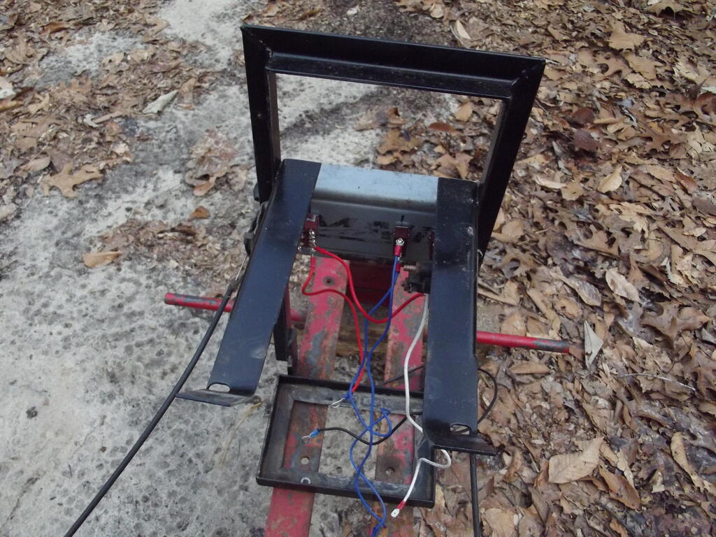

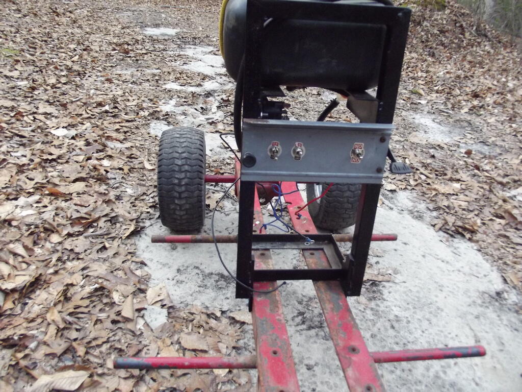

oliver2-44 10,661 #7 Posted January 7, 2021 3 hours ago, JAinVA said: I have a couple Kohler rebuilds to test and I had several used engines to test as well. I wanted to test the used engines without dealing with nasty fuel systems and sketchy wiring. This stand uses mostly all Wheel Horse parts. An overturned 35 gallon plastic trash can protects the fuel tank,battery and control panel if this is left out in the weather. @JAinVA I'm guessing your using those 3 switches in place of a key switch. How/What are they used for? Share this post Link to post Share on other sites
JAinVA 4,636 #8 Posted January 7, 2021 (edited) Looking at the panel from the operators station the switch on the right is a 30 amp momentary on switch for the starter solenoid. The switch on the left is an on of switch to turn the engine on or off and is wired depending on the type of ignition, K vs M. The middle switch is for connection to the R and R or charging circuit. You don' need a switch but it was easier to deal with than a terminal strip. There are some that say you shouldn't run the engine with the R and R not connected but I have had no issues long term with the switch on or off. I used these switches because I need to test engines with different ignition systems,points vs modules. Obviously you have a limited ability to test an engine under load with this rig but at least you know it runs and whether it makes any funny noises. If you need any other info about this just ask. Edited January 7, 2021 by JAinVA 6 Share this post Link to post Share on other sites

oliver2-44 10,661 #19 Posted January 7, 2021 17 hours ago, JAinVA said: The middle switch is for connection to the R and R or charging circuit. You don' need a switch but it was easier to deal with than a terminal strip. There are some that say you shouldn't run the engine with the R and R not connected but I have had no issues long term with the switch on or off. @JAinVA so do I understand correctly the 2 wires from the stator are wired to this switc. Then if the switch is closed those 2 stator leads are shorted together?this switch Thanks everyone, keep the ideas coming Share this post Link to post Share on other sites
JAinVA 4,636 #20 Posted January 7, 2021 (edited) There are two wires from the stator to the R and R .The R and R has a 3 wire plug. Two of the connectors are connected to the stator and the 3rd contact goes to the + battery terminal. The switch has one terminal connected to the R and R and the other to the positive battery terminal. The switch just makes it easier to make this connection and really isn't needed.. The K series have been in service long enough long that the 3 connector plug may have been eliminated. Just to be clear do not take the stator leads and connect them to each other, ever. You will burn something up with the engine running. What I was referring to about the Rand R being disconnected from battery with the engine running is that some people say it will kill the unit. I have not seen this to be true. Edited January 7, 2021 by JAinVA 2 Share this post Link to post Share on other sites
