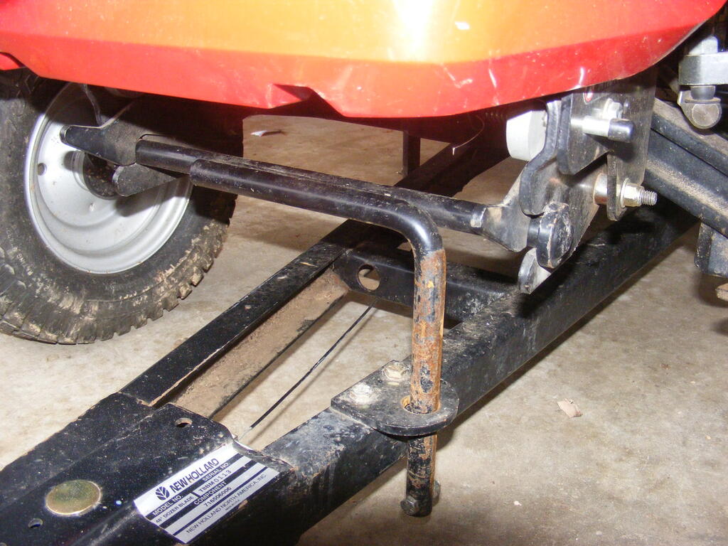

WVHillbilly520H 10,378 #15 Posted January 5, 2021 1 hour ago, DennisThornton said: I only have a mid-mount blade and a 2 stage for my XIs. Are you saying the XI snow/dozer blade doesn't have 5 manual angles like the others? I sort of picture both of mine with cabs and one with blade the other with blower. No (stupid fat fingers of mine) meant to write "isn't manual Lift" not angle... I corrected that above. Yes the xi is 5 position but the old ones were only 3. Plus they have the front anti-sway bar to keep the frame from wiggling in the rear attach-a-matic. 1 Share this post Link to post Share on other sites
DennisThornton 4,773 #16 Posted January 5, 2021 2 minutes ago, WVHillbilly520H said: No (stupid fat fingers of mine) meant to write "isn't manual Lift" not angle... I corrected that above. Yes the xi is 5 position but the old ones were only 3. Plus they have the front anti-sway bar to keep the frame from wiggling in the rear attach-a-matic. Ahh! That's better! Don't have the XI dozer/snow blade yet but I'd like to. Then I'd need another XI though, blower, dozer and grader. Funny thing though. I think I'll miss my manual lift and down pressure for the dozer/snow blade! So precise! I can push snow off of unfrozen gravel driveway. You know! I'm guessing that lots of folks with blacktop don't know what I mean. When we first got the TC35 I was pretty new to hydraulics and FELs. Gal thought we should buy a snowblower for it but I said let's wait a bit. First snowfall I put about half of the driveway in the yard! Tractor didn't care if the drive wasn't frozen yet! Then we ordered the snowblower! But even it can make a mess out of a soft driveway! Then I got the Wheel Horse blade and learned how to lift up the blade a bit and can now tell the difference between soft snow and soft driveway! I don't ever want to give that up! Not until the driveway freezes solid! Share this post Link to post Share on other sites
