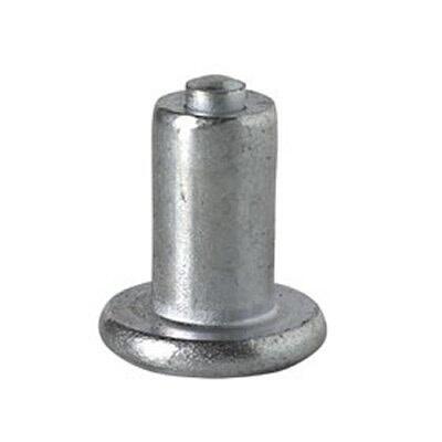

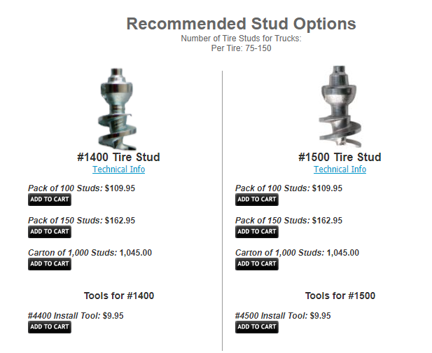

DennisThornton 4,773 #1 Posted January 4, 2021 The hardware I worked for had a forklift that was WORTHLESS in light snow or ice so I ordered these and what a difference! I've ordered some for home but yet to install them. www.gripstuds.com 1 Share this post Link to post Share on other sites
ebinmaine 80,772 #2 Posted January 4, 2021 I've looked at those in the past as well because I've thought about putting a row of them on each ag bar of the tread but the cost was just way too much Share this post Link to post Share on other sites
DennisThornton 4,773 #3 Posted January 4, 2021 14 minutes ago, ebinmaine said: I've looked at those in the past as well because I've thought about putting a row of them on each ag bar of the tread but the cost was just way too much They are a bit pricey and while there are much less expensive options there are also made cheaper. Look for carbide! But I will tell you they worked well! I mean it made the difference between basically not being able to use the forklift at all to working well. 1 Share this post Link to post Share on other sites
Maxwell-8 4,371 #4 Posted January 4, 2021 And screwing in regularly thick screws from the inside an the cut them to length? Share this post Link to post Share on other sites
DennisThornton 4,773 #5 Posted January 4, 2021 14 minutes ago, Maxwell-8 said: And screwing in regularly thick screws from the inside an the cut them to length? I've seen that but not done that. And of course these screw in from the outside where the overly large and shallow threads make them hold much better than regular screws. None of these came loose on the forklift after a couple winters and lots of use. These studs have carbide centers but I'm curious if grade 8 or hard screws would work well enough. Perhaps then a tube liner and a tube? Seems promising to me. But I'd still prefer the carbide centers. 1 Share this post Link to post Share on other sites

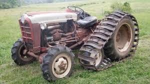

DennisThornton 4,773 #19 Posted January 5, 2021 7 minutes ago, slim67 said: I think those may have been made by Bombardier. The electric company used to use them on newer Ford tractors to brush hog the high tension lines by me. Id like to see a mini set for our size tractors. Bombardier and ARPS. I forget which is mine but I think ARPS. They really look neat but I wonder about steering and if perhaps that's why I heard about them throwing tracks. Maybe sharp turns aren't wise... Oh! Not my tractor or tracks! 3 1 Share this post Link to post Share on other sites
slim67 2,825 #20 Posted January 5, 2021 28 minutes ago, DennisThornton said: Bombardier and ARPS. I forget which is mine but I think ARPS. They really look neat but I wonder about steering and if perhaps that's why I heard about them throwing tracks. Maybe sharp turns aren't wise... Oh! Not my tractor or tracks! I think it would help to use the brakes when steering like a bulldozer. Are you ever going to use yours? I don't see anything on your list that would but maybe its time for another tractor! Share this post Link to post Share on other sites

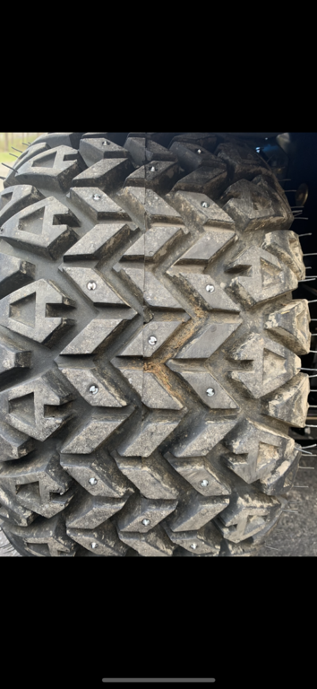

Diesel_Brad 34 #25 Posted January 5, 2021 I actually have the grip rites in my all trails. Not nearly as aggressive as chains but far superior than nothing on ice. I actually just got a set for my muck boots as well 1 1 Share this post Link to post Share on other sites
