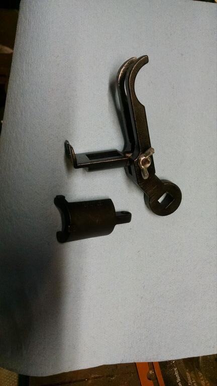

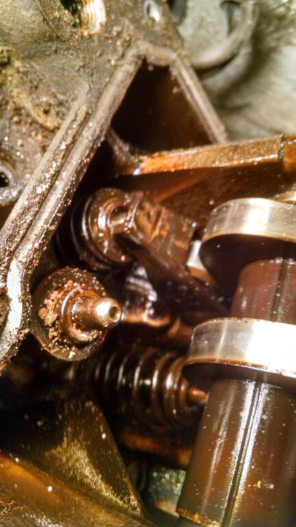

Achto 32,865 #17 Posted January 5, 2021 (edited) 12 hours ago, JoeM said: Bought a new lifter and made a tool to collapse the OHC valve spring. Replaced the lifter and it ran good and had 150k when I replaced it The tool to remove the rocker arms was the only tool that I had to add to my arsenal. This tool hooks under the cam shaft & allows you to push the valve down so that you can remove the rocker arm. This tool can also be used on Ford engines if you install the other foot that came with it. I watched a few You Tube videos to get some tips and determine what special tools may be needed. I saw that there was a tool to hold the timing chains to the idle gear for installation. https://www.amazon.com/OTC-522902-Timing-Chain-Holder/dp/B007TMYD82/ref=asc_df_B007TMYD82/?tag=hyprod-20&linkCode=df0&hvadid=312192385809&hvpos=&hvnetw=g&hvrand=7858178172464351646&hvpone=&hvptwo=&hvqmt=&hvdev=c&hvdvcmdl=&hvlocint=&hvlocphy=901 Yet another video showed me how to accomplish the exact same job with two rubber bands. Costing less than 10cents. Edited January 5, 2021 by Achto Share this post Link to post Share on other sites
