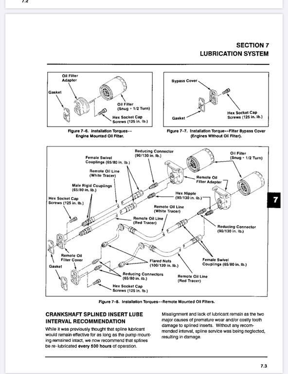

19richie66 17,950 #5 Posted January 3, 2021 6 hours ago, 953 nut said: @19richie66 has posted that information on here, perhaps he will chime in. Pictures from magnum manual. Bought my stuff of the E auction site. Search “kohler filter adapter”. Engine plate/gasket and filter mount are what you really need. You can make hoses. 1 1 Share this post Link to post Share on other sites

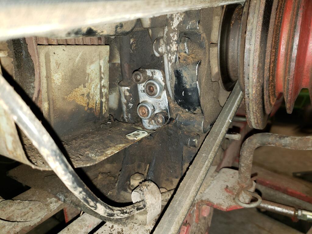

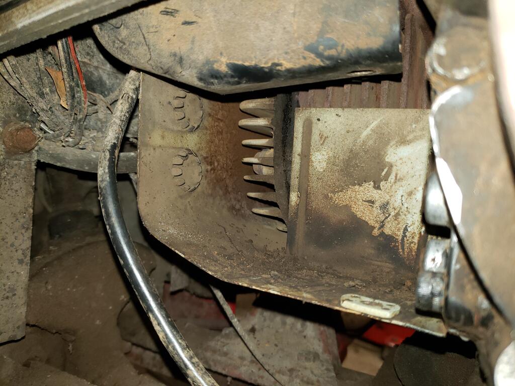

417Horse 40 #6 Posted January 3, 2021 Thanks, bds, for the part # and link. Fortunately, it looks like mine has the plate (crud removed for clarity) with A and B port plugs that could be removed. In the second pic, there are 2 hole fillers in the sheet metal that, in my opinion, could be used to extend the supply and return to the filter if it was mounted remotely. I guess that's what those holes are for? If I add the filter, I will probably mount it remotely - just would have to decide where to mount the filter and bracket. 1 Share this post Link to post Share on other sites
19richie66 17,950 #7 Posted January 3, 2021 Those holes are for the oil lines. 👍 1 Share this post Link to post Share on other sites
