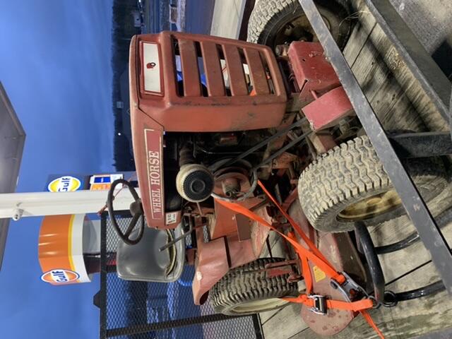

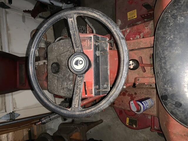

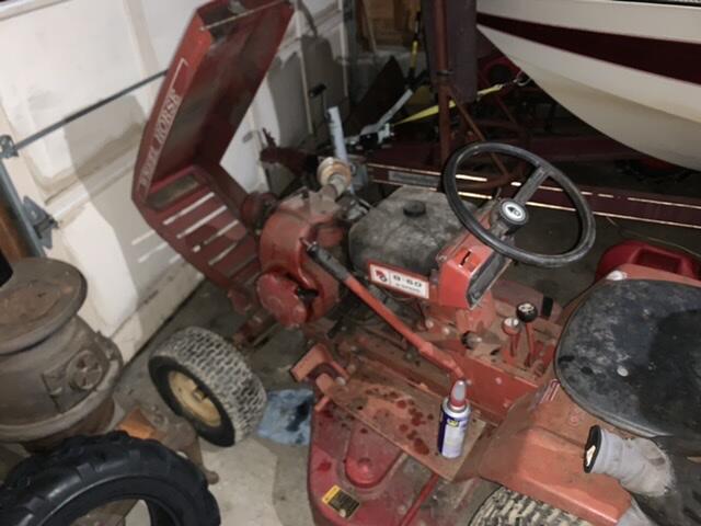

Crmaverick 91 #1 Posted January 3, 2021 (edited) I picked up this B60 and want to swap in the 8 speed to my 753 that’s starting to pop out of third. I have a spare 3 speed I could put in it to, but I could use the 8 speed for plowing, dozing, and garden plowing in my 753. The motor would be a good spare for my 704. Is there a write up on this swap? Any thoughts? I feel kind of guilty parting out this nice B60. One owner it’s whole life until two years ago and all original, minus a quicky paint job at some point, and a seat. Edited January 3, 2021 by Crmaverick 1 Share this post Link to post Share on other sites
