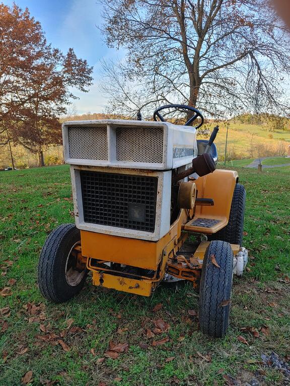

littleredrider 409 #35 Posted January 21, 2021 I have the tri ribs on my 520-8, and during the summer there great. But winter brings a new level of suck. Even with a the weight of the snow blower in the up position, it will just push, won't steer hardly at all. I've been wanting to do the chain since I had them, but never on my mind when at the store. I put the steering reduction on it, and with these tires, I can crank it around faster than if it had power steering. And it's effortless. They do look good tho!!! No pics on laptop or I'd post some pics.... 1 Share this post Link to post Share on other sites
WVHillbilly520H 10,378 #36 Posted January 21, 2021 8 minutes ago, littleredrider said: I have the tri ribs on my 520-8, and during the summer there great. But winter brings a new level of suck. Even with a the weight of the snow blower in the up position, it will just push, won't steer hardly at all. I've been wanting to do the chain since I had them, but never on my mind when at the store. I put the steering reduction on it, and with these tires, I can crank it around faster than if it had power steering. And it's effortless. They do look good tho!!! No pics on laptop or I'd post some pics.... Mine wouldn't be for grass or snow, maybe a Brinly 10" plow, but for my CC126 K301(3rd lowest priduction) after I restore it, I have a CC86 K181 (5th lowest production) with the factory narrow rims but has high-speed trailer tires on it. 1 Share this post Link to post Share on other sites
