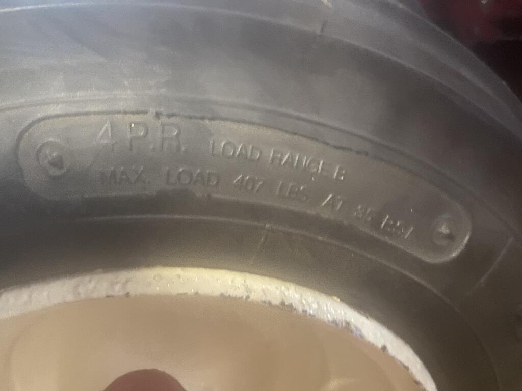

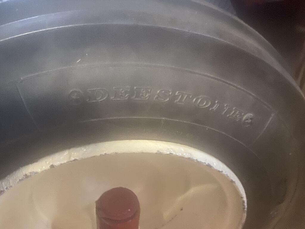

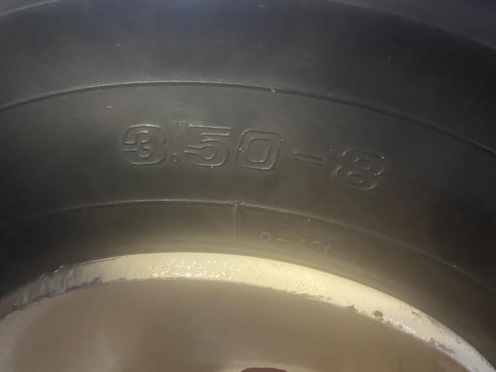

Achto 32,891 #3 Posted January 2, 2021 12 hours ago, haydendavid380 said: Which ones of the older models came with them? My 1076 has 4.00/4.80-8 Dee Stone's mounted on the stock rims. The original tires were 16-5.50x8's 6 2 Share this post Link to post Share on other sites

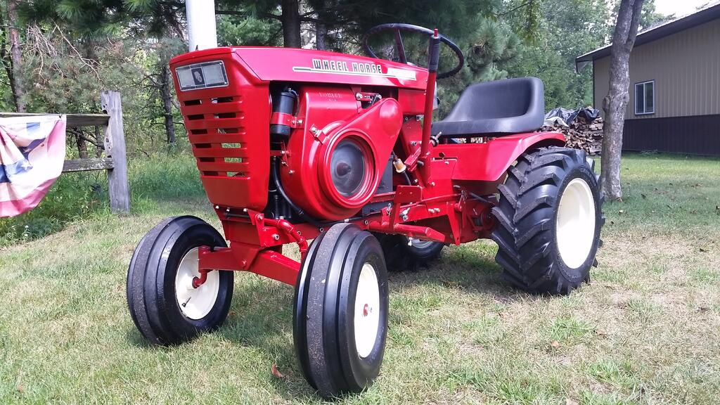

WHX?? 58,324 #4 Posted January 2, 2021 (edited) Dan and I were just talking about this the other day on the price of the Dee tri ribs in 4/8 and how they make a nice tire for the money. Both my plow mules have them on stock rims and they perform well. A pair can be had for 50 -60 bucks. In the little more pricey category the Firestones (last pic) are real nice if you can get over the cost. 70-80 clams a piece. Definitely a beefy tire and better suited to heavier tractors. They have a very pronounced center rib and that's all that hits the ground unless soft dirt. They steer like a dream because of this. This tractor is my first love so no expense spared on her shoes. If I won the lottery all my tractors and a bunch of other fellas tractors here would be sporting these. I think these measure in at 16.5/8 Edited January 2, 2021 by WHX24 4 3 Share this post Link to post Share on other sites

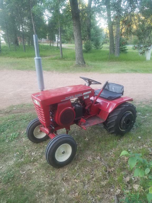

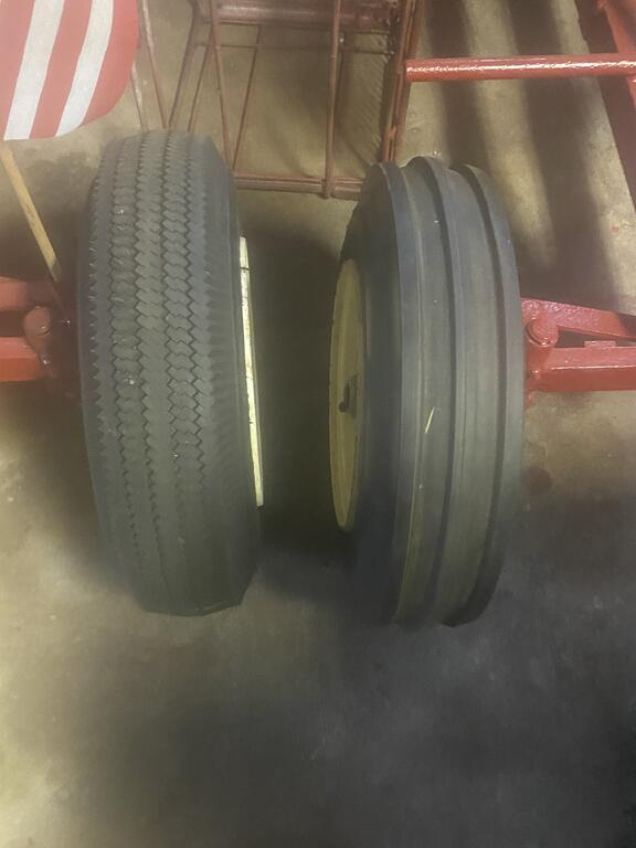

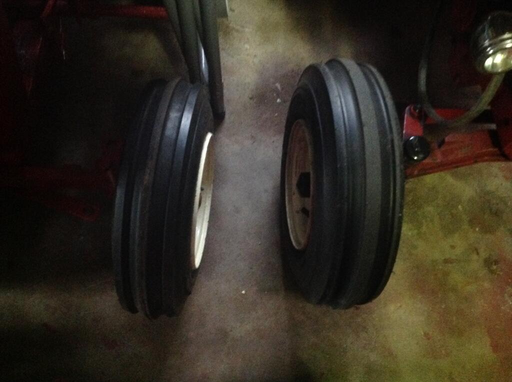

Lane Ranger 12,159 #5 Posted January 2, 2021 (edited) Another alternative is skinnier tires! I put these 3.50x8 Deestone on an RJ. I wanted to see how well they would look. I think they are good looking! yes a smaller profile than the 4 x 8 tires. last pic has 4x8 tritium next to 3.50x8 tritium! Edited January 2, 2021 by Lane Ranger Added pic 5 Share this post Link to post Share on other sites

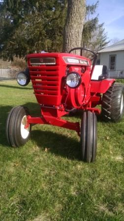

RandyLittrell 3,946 #6 Posted January 2, 2021 (edited) 2 hours ago, WHX24 said: If I won the lottery all my tractors and a bunch of other fellas tractors here would be sporting these. Front and rear, nothing better looking than Firestones! They perform well too!! For example @prondzy Randy Edited January 2, 2021 by RandyLittrell 4 1 Share this post Link to post Share on other sites

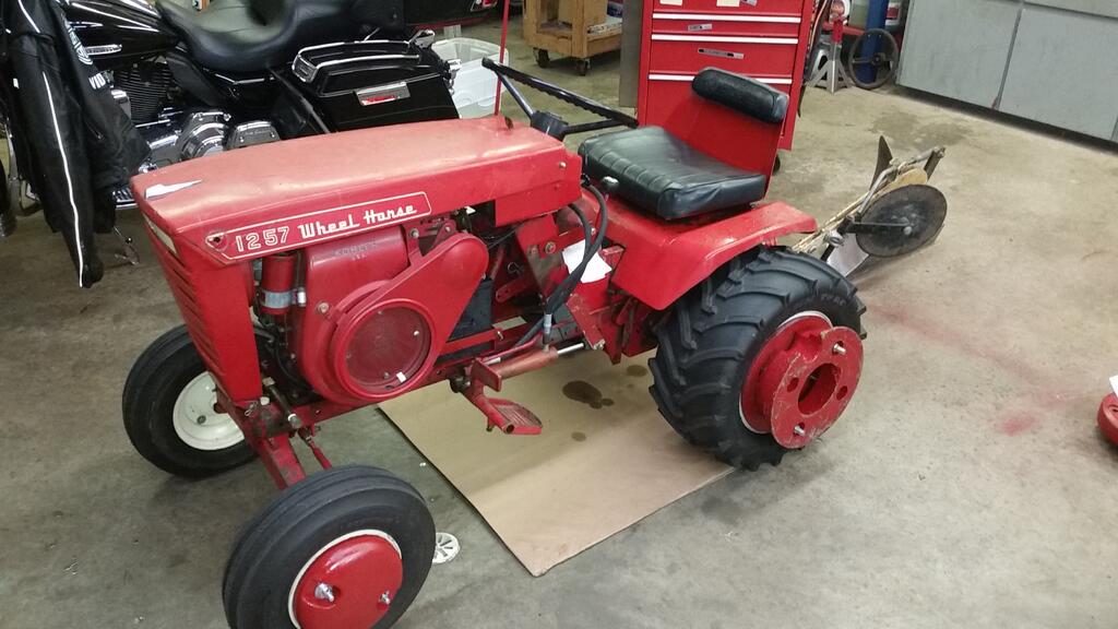

haydendavid380 759 #7 Posted January 3, 2021 Those Firestones are nice. I had been looking at the Dee's. As long as there is an actual performance difference, I don't mind the price. These are what is on it now. Planning on stripping down the wheels and giving them a nice new coat of ivory. 1 Share this post Link to post Share on other sites

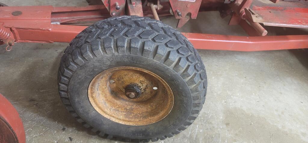

haydendavid380 759 #13 Posted January 3, 2021 B-80 and a 312. The B-80 is my plow tractor and I'm thinking a thinner rib might help with turning. The 312 I just want to get rid of the hideous 6" wheels. 1 Share this post Link to post Share on other sites
WHX?? 58,324 #14 Posted January 3, 2021 9 minutes ago, haydendavid380 said: B-80 and a 312. The B-80 is my plow tractor and I'm thinking a thinner rib might help with turning. The 312 I just want to get rid of the hideous 6" wheels. By plow do you mean front blade or furrow? Hear ya on the six fronts tho. Lots of guys her ditched those to go to 8's but not sure what tire size they went to keep the tractor somewhat level? Share this post Link to post Share on other sites

RandyLittrell 3,946 #20 Posted January 3, 2021 12 minutes ago, WHX24 said: Hear ya on the six fronts tho. Lots of guys her ditched those to go to 8's but not sure what tire size they went to keep the tractor somewhat level? The stock size on the 310 and 312's were 15x6.50-6. You can go to 8" wheels and use these tires to keep the same height. https://smile.amazon.com/MaxAuto-15x6-50-8-15x6-50x8-Tractor-Riding/dp/B08FFH3DVX/ref=sr_1_1_sspa?crid=1DOJUA0U2EHAM&dchild=1&keywords=15x6.50-8+lawn+mower+tires&qid=1609636491&sprefix=15x6.50%2Caps%2C202&sr=8-1-spons&psc=1&spLa=ZW5jcnlwdGVkUXVhbGlmaWVyPUEyVjVLQjJYNElVTklMJmVuY3J5cHRlZElkPUEwNjU4NjUwMk1RM1VEWkdETVFLMyZlbmNyeXB0ZWRBZElkPUEwMTU5NzYxSVpDMDNTVzQ2S01DJndpZGdldE5hbWU9c3BfYXRmJmFjdGlvbj1jbGlja1JlZGlyZWN0JmRvTm90TG9nQ2xpY2s9dHJ1ZQ== Randy Share this post Link to post Share on other sites
haydendavid380 759 #21 Posted January 3, 2021 1 minute ago, RandyLittrell said: The stock size on the 310 and 312's were 15x6.50-6. You can go to 8" wheels and use these tires to keep the same height. https://smile.amazon.com/MaxAuto-15x6-50-8-15x6-50x8-Tractor-Riding/dp/B08FFH3DVX/ref=sr_1_1_sspa?crid=1DOJUA0U2EHAM&dchild=1&keywords=15x6.50-8+lawn+mower+tires&qid=1609636491&sprefix=15x6.50%2Caps%2C202&sr=8-1-spons&psc=1&spLa=ZW5jcnlwdGVkUXVhbGlmaWVyPUEyVjVLQjJYNElVTklMJmVuY3J5cHRlZElkPUEwNjU4NjUwMk1RM1VEWkdETVFLMyZlbmNyeXB0ZWRBZElkPUEwMTU5NzYxSVpDMDNTVzQ2S01DJndpZGdldE5hbWU9c3BfYXRmJmFjdGlvbj1jbGlja1JlZGlyZWN0JmRvTm90TG9nQ2xpY2s9dHJ1ZQ== Randy I'm already running bigger tires on the rear. I figured the 8's would level it out. 1 Share this post Link to post Share on other sites
RandyLittrell 3,946 #22 Posted January 3, 2021 1 minute ago, haydendavid380 said: I'm already running bigger tires on the rear. I figured the 8's would level it out. It might, the height is dependent on tire size not strictly wheel size. Rear tires vary greatly on advertised size to actual size, best to put a tape measure to them to know for sure. Deestones tires are notoriously small versus size printed on the tire. Even mowing, I don't think it will make a big difference other than I hear some decks won't clear the 8" combo put on the bigger tractors. Randy Share this post Link to post Share on other sites
