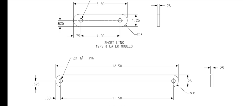

Ed Kennell 45,041 #3 Posted January 1, 2021 You could use a solid lift bar. Then you could apply down pressure as needed by pushing the lift lever. 2 Share this post Link to post Share on other sites
ebinmaine 77,542 #4 Posted January 1, 2021 6 minutes ago, Ed Kennell said: You could use a solid lift bar. Then you could apply down pressure as needed by pushing the lift lever. I'll second that. That what Trina and I do. Works AWESOME. @WVHillbilly520H has mounted weights on his plow. 2 Share this post Link to post Share on other sites

WVHillbilly520H 10,378 #6 Posted January 1, 2021 2 minutes ago, ebinmaine said: I'll second that. That what Trina and I do. Works AWESOME. @WVHillbilly520H has mounted weights on his plow. I kinda haphazardly hung 84# on top of the moldboard which still allowed the trip action to work on some of the more solid high spots. All because I couldn't find (and still can't) the solid lift link in made last spring, but I can find my copy of the blueprints. 3 Share this post Link to post Share on other sites

WVHillbilly520H 10,378 #8 Posted January 1, 2021 3 minutes ago, seven said: Are they hard too install What, the lift link or the weights? Those weights the cut outs just barely fit over the the top edge of the blade and honestly just "hung" them on there just to cut the ice/slush that afternoon. Share this post Link to post Share on other sites
SylvanLakeWH 30,649 #9 Posted January 1, 2021 15 minutes ago, seven said: Are they hard too install No. Just replaces the lift chain with a solid link... 1 Share this post Link to post Share on other sites

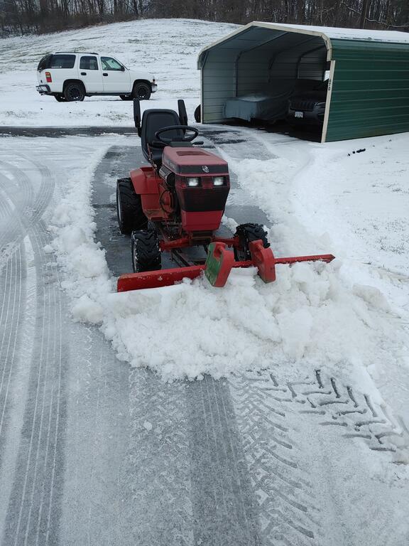

WVHillbilly520H 10,378 #17 Posted January 1, 2021 18 minutes ago, Row Cropper said: to stop that inevitable bow that occurs in these wider blades. My older 42" modded to 50" and then an older 54" I found later, actually never bowwed, but that 56" pictured above was slightly bowwed before I brought it home and I did tweak that lighter gauge steel hanging those weights, but still cheaper than a broken bone on icy pavement. 4 Share this post Link to post Share on other sites
