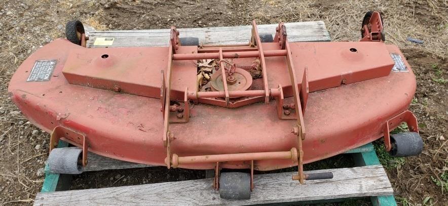

haydendavid380 759 #1 Posted December 31, 2020 I just bought a deck from an online auction. Was listed as a 48" Is this a D series deck? If so (assuming everything is solid) what would ballpark value be on it? Are they harder to come by than the B/C decks? Share this post Link to post Share on other sites
roadapples 6,987 #2 Posted December 31, 2020 48 But I don't think D series... Share this post Link to post Share on other sites
Ed Kennell 46,596 #3 Posted December 31, 2020 The deck looks like a standard 48" shell that would fit a C, 3,4, 0r 500 series, but I have never seen that type of carriage mount. Can you ID Garry @gwest_ca ? 1 Share this post Link to post Share on other sites
gwest_ca-(File Mod) 12,357 #4 Posted December 31, 2020 I don't know the decks well but the handle on the hitch bar caught my eye. You can see it here - item #43 https://www.partstree.com/models/5-1220-toro-48-side-discharge-mower-deck-1973/parts-list-for-48-18-hp-automatic-0/ Here is a list of all the D-Series decks. I do not know if they all have the handle. DNA of 48in side discharge decks for the 18hp Auto, D-160 Auto, D-180 Auto and D-200 Auto 1973-1974 model 5-1220 1975 model 5-1221 1976 model 65-48XS01 1977 model 75-48XS01 - Blades up to here have a 5/8" x 3/4" double-D center hole - 3 blade set #100202 no longer available The following decks use blades with 3/4" round center hole - 3-blade set #106637 1977 model 75-48XS02 1978 model 85-48XS01 1979 model 95-48XS00 1979 model 95-48XS01 1980 model 05-48XS01 1981-1982 model 05-48XS02 Garry Share this post Link to post Share on other sites
haydendavid380 759 #5 Posted December 31, 2020 I hadn't seen that handle before either Share this post Link to post Share on other sites
pacer 3,180 #6 Posted December 31, 2020 Havent had my D200 deck off in a while but ..... IIRC that is the same deck - and yes it does have that handle. Share this post Link to post Share on other sites

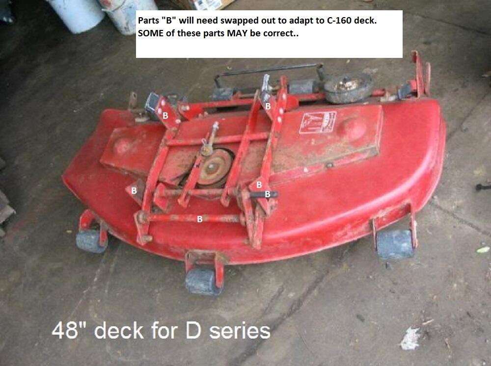

daveoman1966 3,884 #7 Posted December 31, 2020 That is 'D' series deck...48" for sure. Just swap out the lift brackets and it will fit almost any B or C series tractors. 2 Share this post Link to post Share on other sites
haydendavid380 759 #8 Posted December 31, 2020 I bought it on the off chance that the belt covers might fit my 42" on my 312 that's missing them. The only tractor I have that's missing a deck is my B-80, and there's no way it's going to run that thing if I swap the brackets. I would think someone would trade a 36" for it. 1 Share this post Link to post Share on other sites
