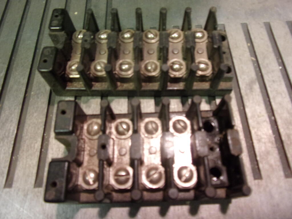

Zeek 2,299 #5 Posted December 30, 2020 (edited) You could also use a terminal block if you wanted to run individual ground wires. That way it's neat and you don't have a bunch of wires connected to your battery - terminal. One ground from battery to terminal block and everything gets grounded there. Edited December 31, 2020 by Zeek 8 Share this post Link to post Share on other sites

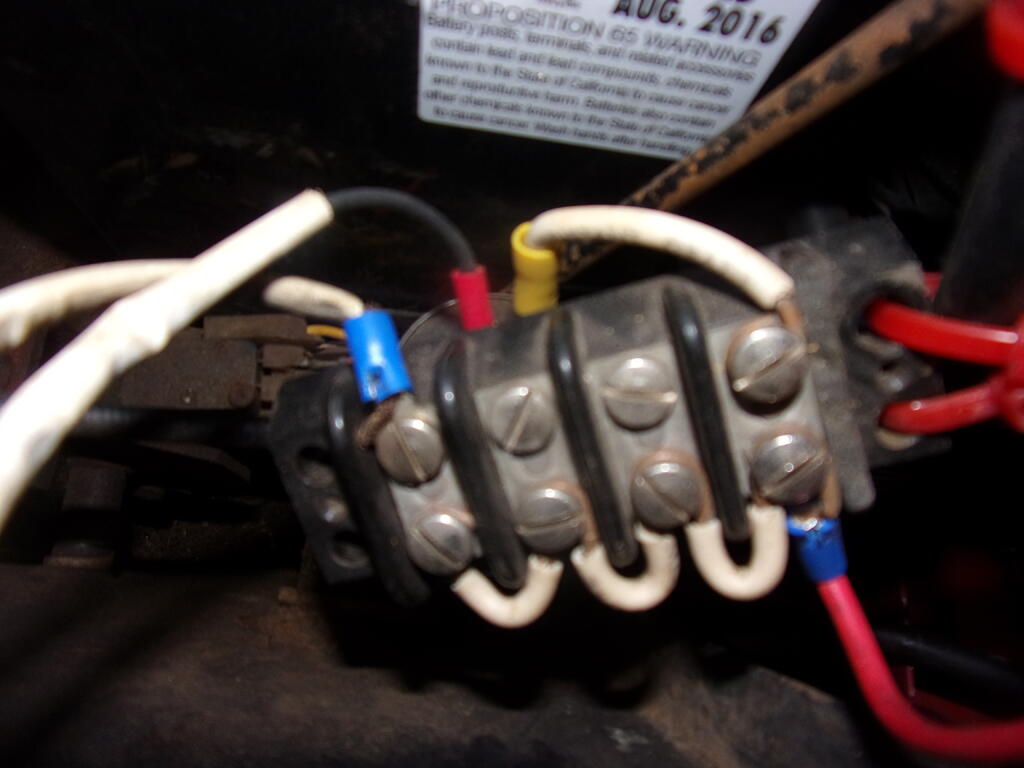

Maxwell-8 4,371 #7 Posted December 30, 2020 (edited) I have a central location where of everything gets + or - but its away from the battery. Fuse-sing everything and hooking up switches is easier and the fuses are all central Edited December 30, 2020 by Maxwell-8 2 Share this post Link to post Share on other sites

Ed Kennell 45,324 #12 Posted December 30, 2020 2 hours ago, Zeek said: You could also use a terminal block if you wanted to run individual ground wires. That way it's neat and you don't have a bunch of wire connected to your battery - terminal. One ground from battery to terminal block and everything get grounded there. Yep, terminal blocks on positive and negative. Makes it easy to add aux lights, bells and whistles to the snow machines. 5 3 Share this post Link to post Share on other sites
R Scheer 510 #13 Posted December 30, 2020 I'd go with a buss bar myself for the ground. For the positive I like the marine switch panels, a bit pricy but gives you fuse holders/ switches/ and is hopefully water tolerant. 3 Share this post Link to post Share on other sites
