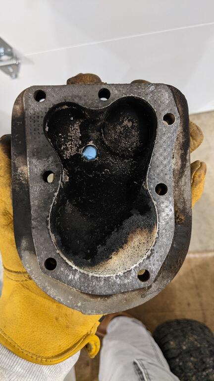

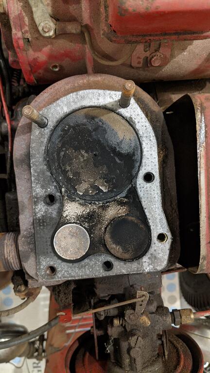

csvt99 173 #34 Posted January 2, 2021 I couldn't wait. Popped the head off this is what I found. This is the first time I've ever had an engine apart so I don't know what I'm looking at other than a lot of carbon, piston and valves? How does she look? 2 Share this post Link to post Share on other sites

oliver2-44 11,816 #36 Posted January 2, 2021 3 hours ago, csvt99 said: How does she look? In the above picture notice the top of the piston is clean in the upper right corner. I believe that is an indication Of ring blow by. Which could indicate the cylinder is out of round. @richmondred01 any thoughts on this 1 Share this post Link to post Share on other sites
richmondred01 2,393 #37 Posted January 2, 2021 8 hours ago, oliver2-44 said: In the above picture notice the top of the piston is clean in the upper right corner. I believe that is an indication Of ring blow by. Which could indicate the cylinder is out of round. @richmondred01 any thoughts on this To do it correctly yes, a cylinder bore needs to be utilized to determine how far the cylinder is out of spec. Then of course the crank journal needs to be measured with a mic to determine its spec and to determine if it needs to be polished or ground. Be careful who you use as a machinist. Additionally, my supplier and most I’ve seen, can only get .010 under rods for the k161 and k181 and I only have 5 or so .020 NOS ones left. (They are used only for special customers) Happy New Year and all the best. Share this post Link to post Share on other sites
csvt99 173 #38 Posted January 2, 2021 So it sounds like the best thing to do is take the motor to be inspected by someone who knows what they are doing. We do have several reputable machine shops in the area plus a multigenerational original wheel horse dealer that still works on them. Any tips for cleaning the carbon off the head, piston, and valves? Can I use carb cleaner? Share this post Link to post Share on other sites
ebinmaine 81,139 #39 Posted January 2, 2021 7 minutes ago, csvt99 said: Any tips for cleaning the carbon off the head, piston, and valves? Can I use carb cleaner? I've not been into a Kohler engine further than changing a head gasket. The times I've done that I put it to TDC and use a wire brush. There are chemicals that can help break down the carbon some. Share this post Link to post Share on other sites
richmondred01 2,393 #40 Posted January 2, 2021 (edited) Razor blade on 45% angle and brake cleaner at TDC. However, it’s kinda a moot point because it needs to come out anyway and replaced after it’s bored. Even if you get lucky it will still need to come out to be honed and the crank polished/ground. Also, something that is over looked is valve guides. I typically replace them too during the process. Additionally valves in the k161 and k181 aren’t adjustable. After being resurfaced or replaced the stems need to be ground to fit. (valve stem grinder required a bench grinder can’t cut them 100% flat) Edited January 2, 2021 by richmondred01 1 Share this post Link to post Share on other sites

csvt99 173 #47 Posted January 6, 2021 I talked to the dealer today. He told me he could do a complete rebuild for $900-1000. However he recommended installing oversized rings that are 3/1000s over standard size. He said he could do this, clean up the motor etc. (can't remember exactly what he said) for $200-300 and that should take care of 80-90% of the smoking. However....he cannot find the rings anymore without buying the whole piston ring set for $184, which would up the cost to closer to $500. He too recommend considering finding another motor. Do you think anyone on this website would have the oversized rings? Share this post Link to post Share on other sites
richmondred01 2,393 #48 Posted January 6, 2021 Tell us what he’s going to do? 80-90% what’s that? if he’s only going to just put rings in that then yes 80-90% for a few hours then back to smoking if it needed to be bored. Share this post Link to post Share on other sites
ebinmaine 81,139 #49 Posted January 6, 2021 (edited) Ok 2 things. 13 minutes ago, csvt99 said: However....he cannot find the rings anymore without buying the whole piston ring set for $184 You should be able to find a ring set for WELL less than half that. Maybe 50 to 70 bucks. @richmondred01. Any thoughts? 13 minutes ago, csvt99 said: recommend considering finding another motor No engine builder is telling me that for something I'm restoring. Edited January 6, 2021 by ebinmaine Share this post Link to post Share on other sites
richmondred01 2,393 #50 Posted January 6, 2021 1 minute ago, ebinmaine said: Ok 2 things. You should be able to find a ring set for WELL less than half that. Maybe 50 to 70 bucks. @richmondred01. Any thoughts? No engine builder is telling me that for something I'm restoring. after market or Kohler? .030 over? Share this post Link to post Share on other sites
