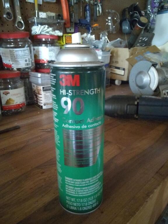

ebinmaine 81,048 #3 Posted December 29, 2020 We have a 3M spray adhesive at home of some sort. I can get you the number in a bit. What is the decal made of and what are you trying to stick it to? Share this post Link to post Share on other sites
"Manic-Mechanic" 1,486 #5 Posted December 29, 2020 It's a vinyl Toro 111312 danger decal from Terry. Enamel Painted Metal on my 312-8. I "think" I may have some of that 3M, maybe spray it and burb it, then apply? I thought someone had used similar, but want to do this once, "hopefully", lol! Been wicked of late as my enthusiasm has decreased a bit, albeit It's moving along....... 1 Share this post Link to post Share on other sites
ebinmaine 81,048 #6 Posted December 29, 2020 You may want to give Terry a ring just to make sure that's going to be compatible. Was it me I would put a pretty light coat on a sticker like that and then maybe try to apply it right down the center and spread to the sides... 1 Share this post Link to post Share on other sites

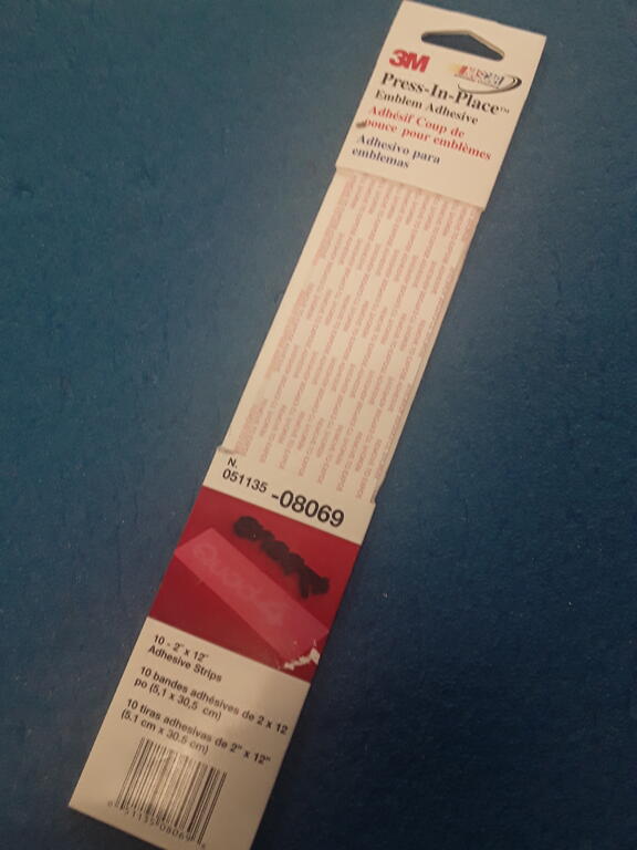

76c12091520h 4,291 #14 Posted December 29, 2020 None of the spray products will lay down flat on a decal. Take your old decal, lay it face down and clean off all the old adhesive using some type of wax and grease remover, rubbing alcohol, etc. Once it's clean and dry press it onto this transfer adhesive. When you remove it from the adhesive strip, the adhesive will stick to your decal and you're back in business. 3 1 Share this post Link to post Share on other sites
"Manic-Mechanic" 1,486 #15 Posted December 29, 2020 I really like this product, going to look into that. However, Terry did call back! He is still swamped but doing well again, Thank God! 1 Share this post Link to post Share on other sites
