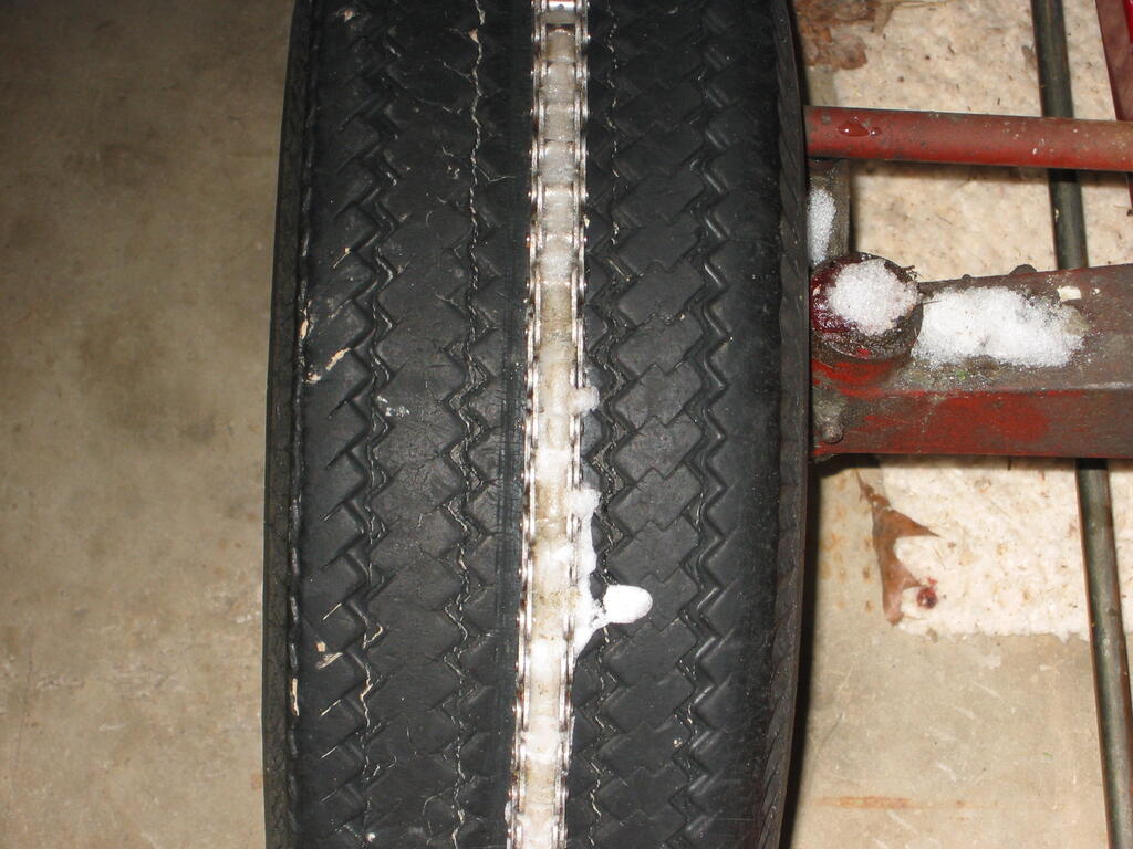

JoeM 8,463 #11 Posted December 28, 2020 (edited) I can, with a little bit of work,wiggle my assembled #50 chains on the tire when deflated. You can see the chain is just a link smaller than the tire diameter. Normal tire inflation. Edited December 28, 2020 by JoeM 1 1 1 Share this post Link to post Share on other sites

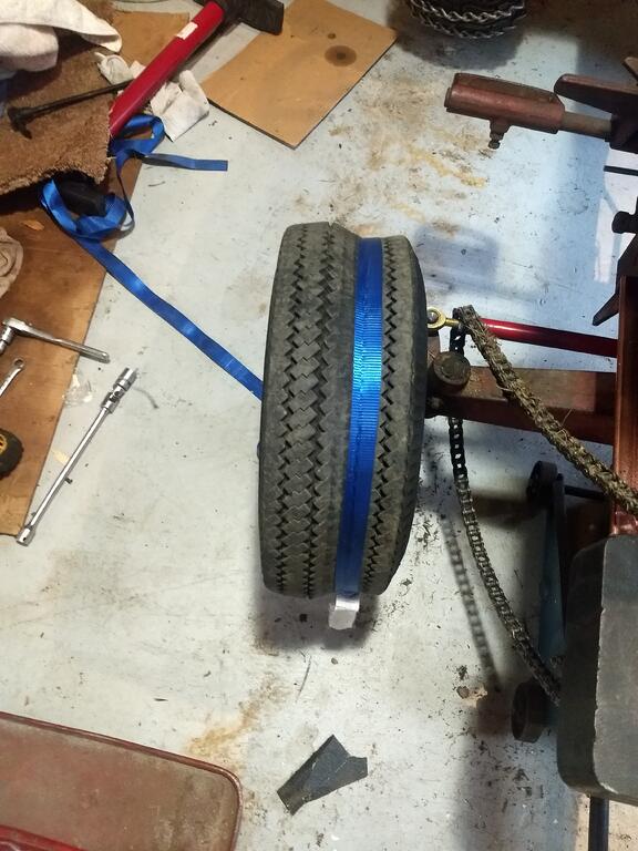

ebinmaine 73,236 #12 Posted December 28, 2020 28 minutes ago, JoeM said: You can see the chain is just a link smaller than the tire diameter That's something that was different... Mine are a link smaller than the MIDDLE of the deflated tire on a saw tooth type that rounds slightly higher in the middle. I'm thinking I may need to whip out a ratchet strap and shrink the center more. As @Tractorhead said the rubber is aged and stiff which obviously isn't helping. 1 1 Share this post Link to post Share on other sites

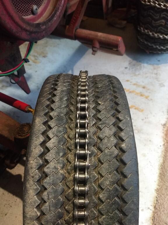

JoeM 8,463 #14 Posted December 28, 2020 1 hour ago, ebinmaine said: Mine are a link smaller than the MIDDLE of the deflated tire on a saw tooth type that rounds slightly higher in the middle EB this pic may show better how much indentation of the chain is on the tire. 1 Share this post Link to post Share on other sites

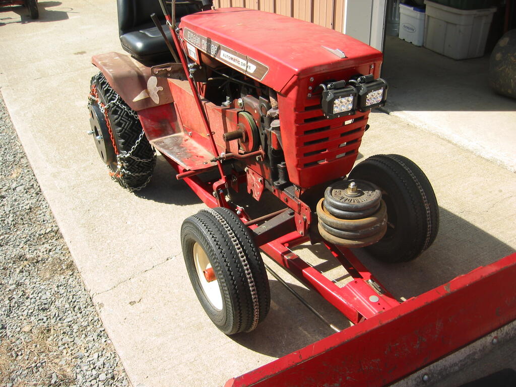

pfrederi 18,749 #15 Posted December 28, 2020 (edited) Well I have it on my principal plow tractor and they are the original 50+ year old tires, and they are the narrower 5.50 tires. Let all the air out adjusted the length till I couldn't get it on the tire went back up a half link and reinflate I run about 20. Hasn't moved in 3-4 years now. (She is on permanent snow duty once you get yours tight I would just swap the front tires if I was running it year round) EDIT: Just realized one of the pictures was from 2015 so the chains have been on 5 years.... Edited December 28, 2020 by pfrederi 2 2 1 Share this post Link to post Share on other sites

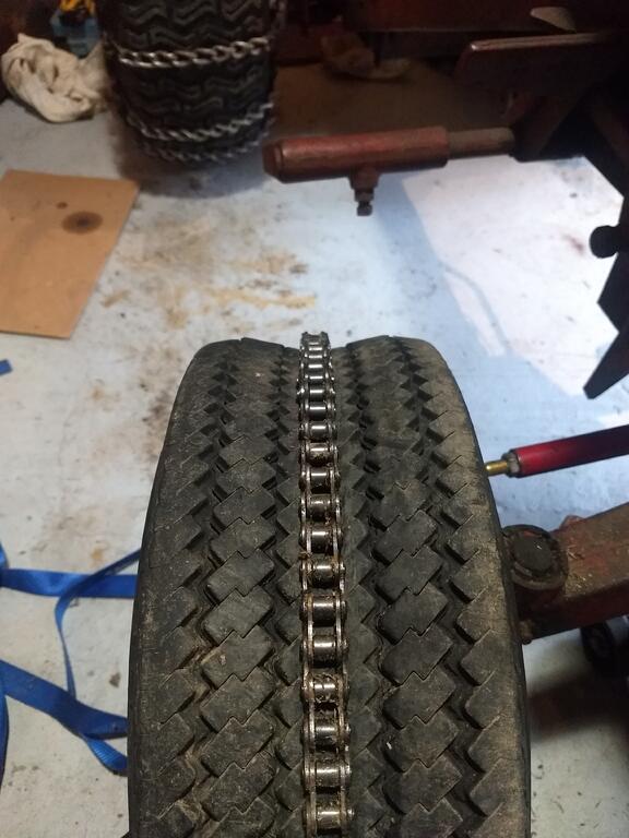

ebinmaine 73,236 #18 Posted December 29, 2020 @pfrederi @JoeM I shortened up the chains a couple links by using a ratchet strap to squeeze the tire. Worked great. Now we'll get The Paint Department some seat time and see how it does. I'd really like to leave the chains on year round because traction on wet ground and leaves has been an issue for her. Here's a before. Note the tire is not indented. And after. Note the contour next to the chains. 4 Share this post Link to post Share on other sites
rjg854 12,301 #19 Posted December 29, 2020 Sure can slip off, when it looks like that. As long as you have good chain contact, I'm sure it should work. 1 Share this post Link to post Share on other sites
