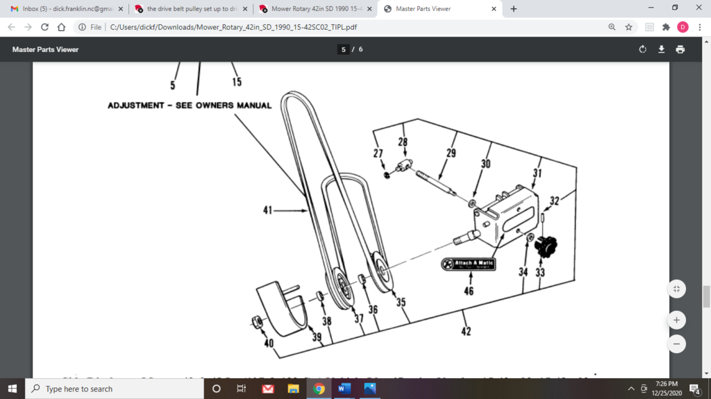

953 nut 64,332 #4 Posted December 26, 2020 The component that ties the engine PTO to the deck via a V Belt is called a Mule Drive. If you don't have one some of our members like @daveoman1966, @A-Z Tractor or @Ed Kennell can probably fix you up. Here is an exploded view of what it looks like. 1 1 Share this post Link to post Share on other sites
