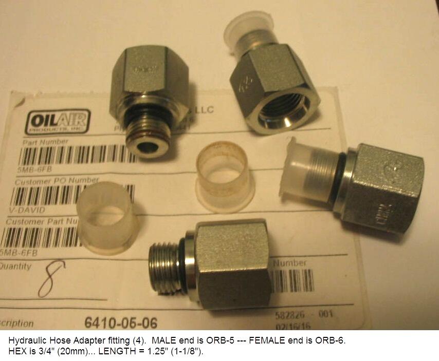

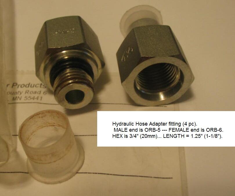

daveoman1966 3,884 #3 Posted December 24, 2020 Older Hydros (pre 74 or 75) had Hyd hose with ORB-6 ends. (ORB = O-Ring Boss). After '75, the hose fittings were ORB-5. ((ORB-6 is for 3/8" ID hose---ORB-5 is for 5/16" hose)) A few years ago, I was able to find ADAPTER fittings for a project I had....still have 4 of them NEW. $7 each. + 3 ship ( for 1 or all 4). Here is a pic or two. These adapters are :FEMALE ORB-6 to MALE is ORB-5. (3/4 Hex...1-1/8" Long) 1 1 Share this post Link to post Share on other sites
ebinmaine 81,156 #4 Posted December 24, 2020 6 hours ago, daveoman1966 said: Older Hydros (pre 74 or 75) had Hyd hose with ORB-6 ends. (ORB = O-Ring Boss Excellent. Thanks Dave! Share this post Link to post Share on other sites
