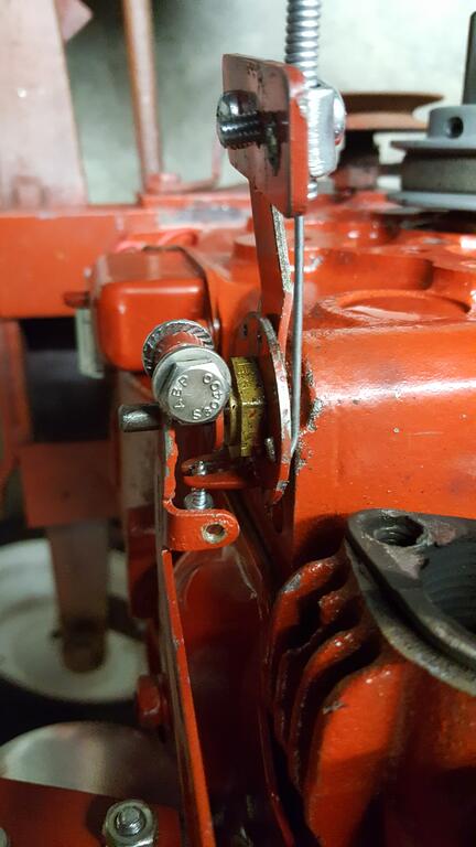

Greentored 3,220 #1 Posted December 23, 2020 Yeah yeah, I know this subject has been beat to death, resurrected, answered and beat again, but this is a bit unique....I think? On these smaller K series, the flyweights act against/overcome the torsion spring for proper function, correct? On my little 701, there is no way the governor will provide enough pressure to overcome that spring and control things. The 'flag' is intact on the governor shaft, and when running the throttle by hand, the arm DOES provide force when revved up, but nowhere near what would be necessary to move that spring. Everything is adjusted correctly by the book. If the spring were a solid link, thats basically the function I have. Am I missing something here? Do the governor gears ever stick, or perhaps throw only one of the two flyweights, therefore being functional but at 50% of the required force? Gosh I hope I don't have to open this little booger up, she is a little 'puffy' but runs SO nice! Thanks in advance! Share this post Link to post Share on other sites

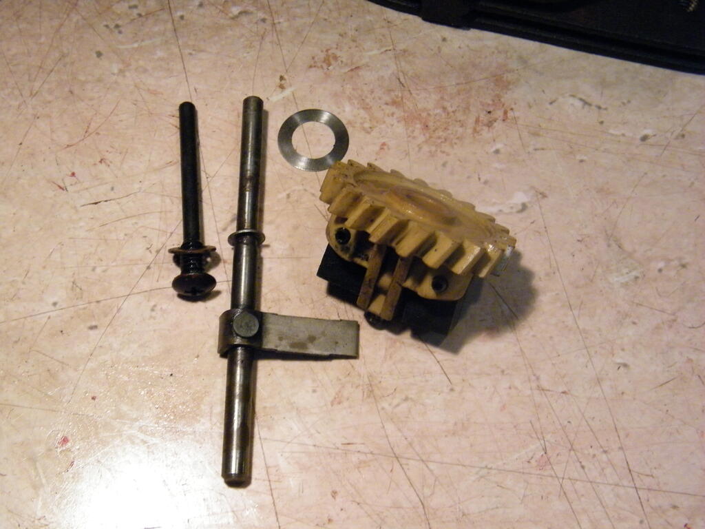

stevasaurus 23,617 #3 Posted December 23, 2020 If you think you have to take it apart, the governor is the last thing to come out...just sayin'. Those weights just fall in and out. Check out these pictures from a K-181. I think it is the same as your K-161. 1 1 Share this post Link to post Share on other sites

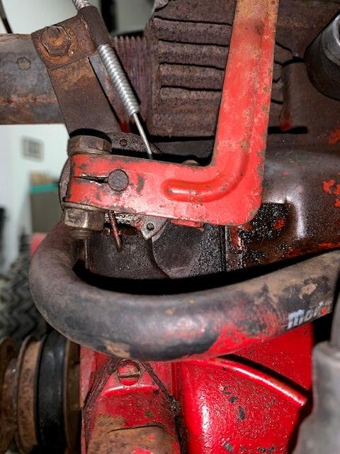

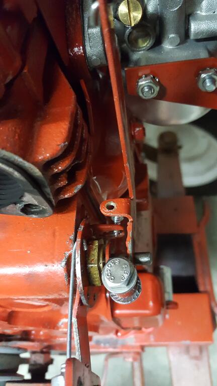

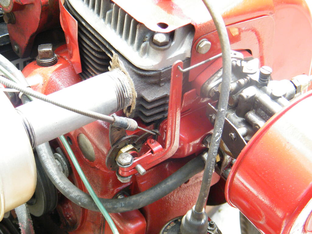

Greentored 3,220 #7 Posted December 24, 2020 Really appreciate the help fellas, here ya go: Share this post Link to post Share on other sites
oldredrider 2,553 #8 Posted December 24, 2020 It appears in the 1st pic, your disc is broken at the bottom. Nothing there to hold the governor arm spring in position. 3 Share this post Link to post Share on other sites

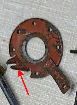

rmaynard 16,869 #9 Posted December 24, 2020 (edited) This is what the disc should look like. The arrow points to what appears to be missing on yours Edited December 24, 2020 by rmaynard 2 Share this post Link to post Share on other sites

Greentored 3,220 #11 Posted December 24, 2020 Terrible pic angle. Its there and spring is located correctly in tabs. Share this post Link to post Share on other sites

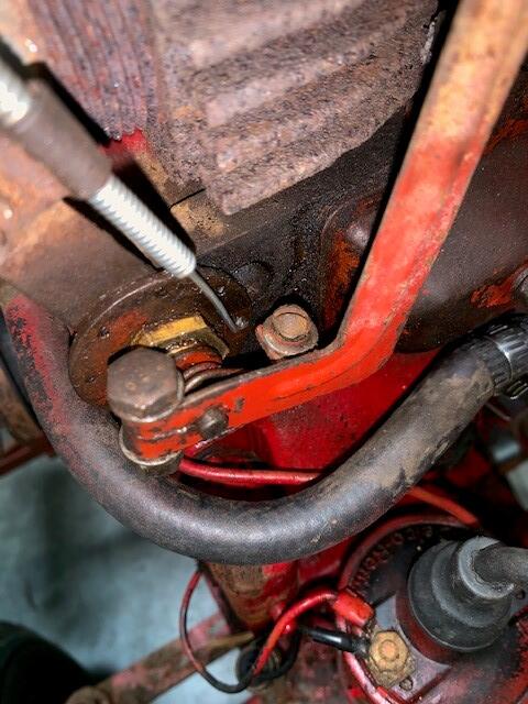

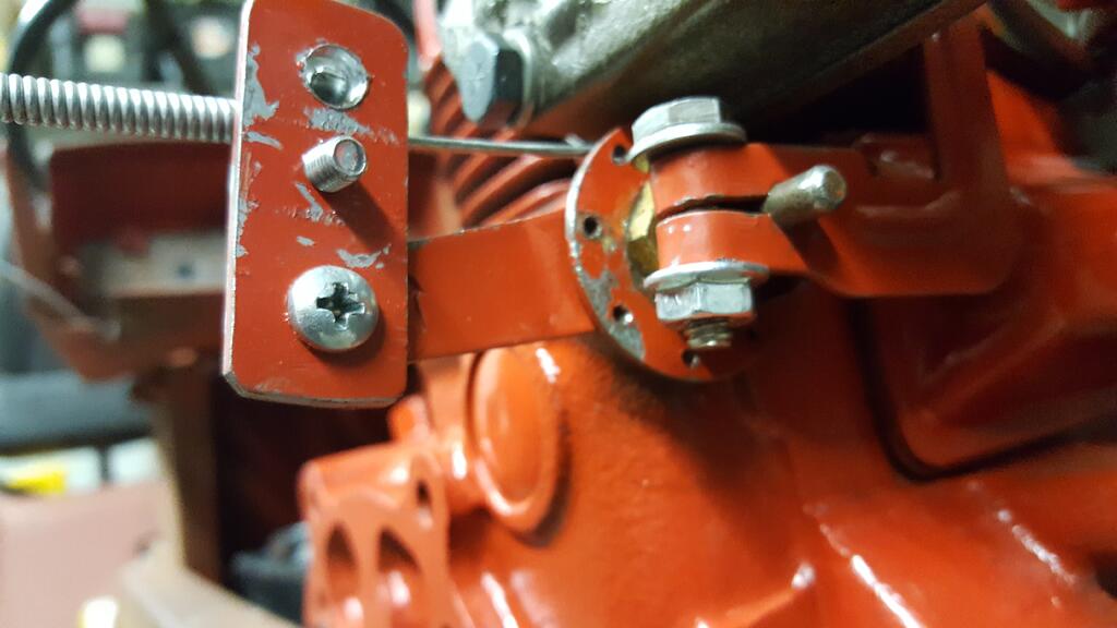

stevasaurus 23,617 #12 Posted December 24, 2020 One thing I notice...your throttle cable is in a hole in the ring itself. Do you have the angled tab like in Maynard's picture?? Looks like this. And shouldn't the spring be attached under that screw. 1 1 Share this post Link to post Share on other sites

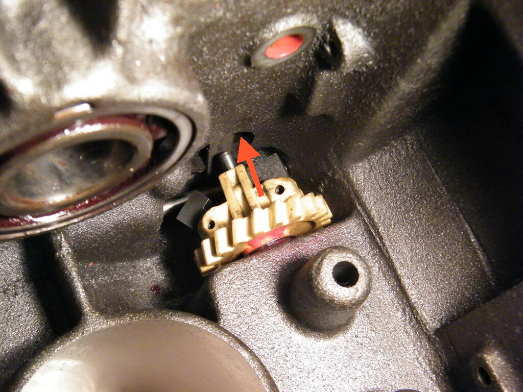

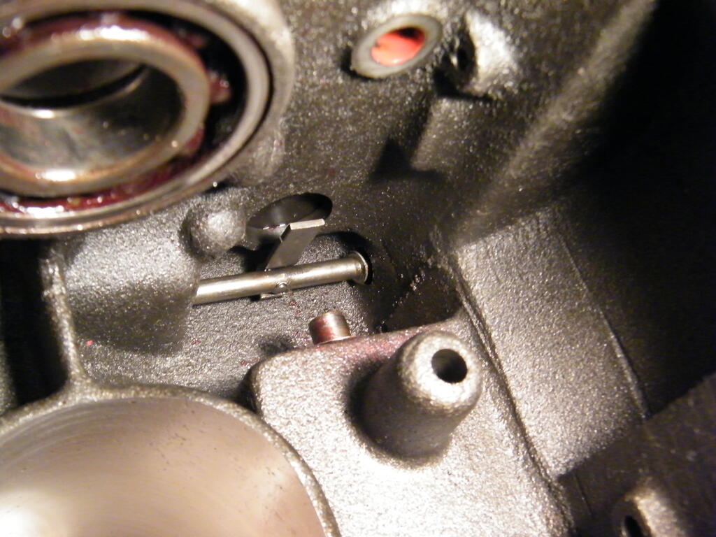

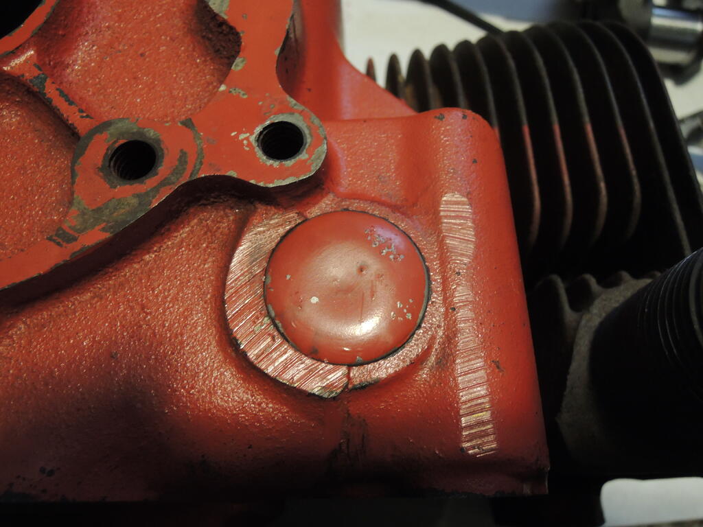

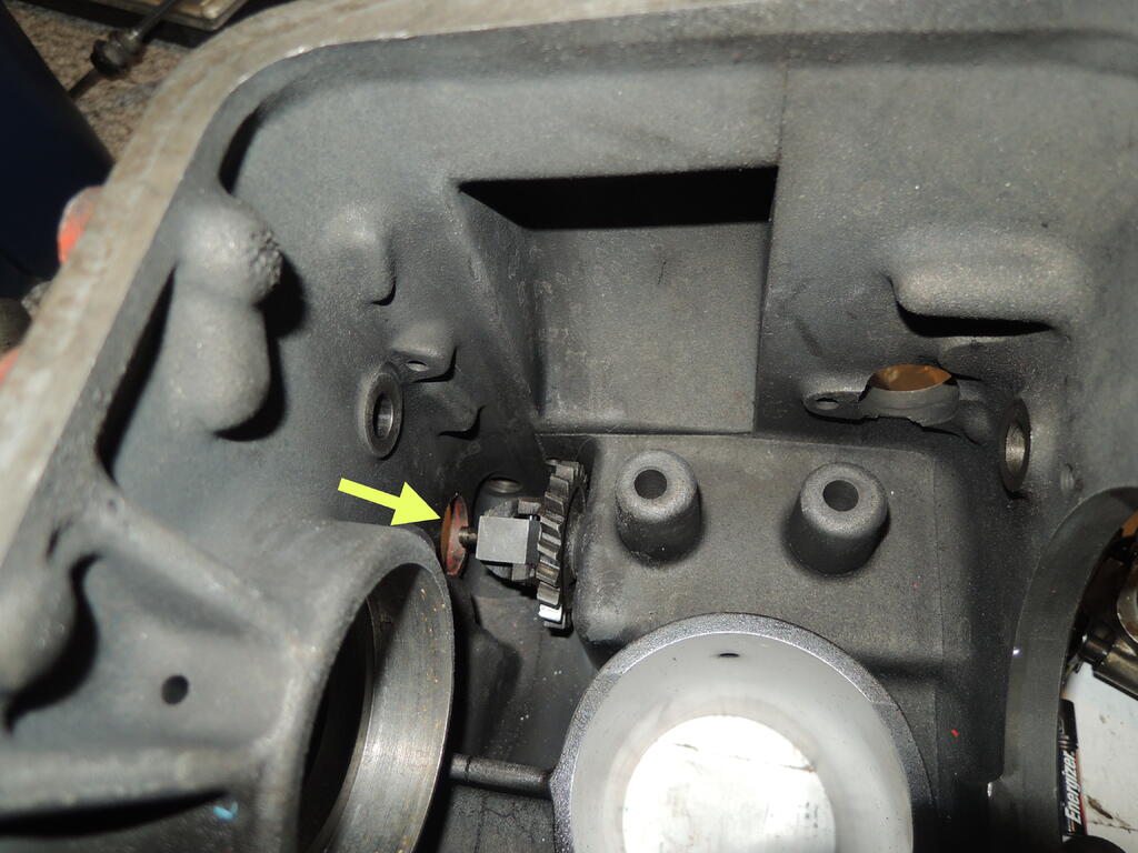

rmaynard 16,869 #13 Posted December 24, 2020 So, assuming that you have everything connected correctly, there is a way to view inside without doing a deep dive. In the picture below courtesty of @stevasaurus the arrow points to the back side of a Welch plug. The next image is the front side of that plug. You can pry that out and view the governor gear and fly weights. It's a tight view through that hole and around the governor shaft, but you will be able to see if anything is missing. 2 Share this post Link to post Share on other sites
stevasaurus 23,617 #14 Posted December 24, 2020 Excellent Bob...thanks and Merry Christmas Mate. 1 Share this post Link to post Share on other sites
wallfish 19,323 #15 Posted December 24, 2020 10 hours ago, rmaynard said: The arrow points to what appears to be missing on yours Weird, I thought the same exact thing and obviously others did as well. I stared at that pic for a while trying to figure out what was going on. Once acknowledged it was there with a different pic, now go back to the first pic and you can easily see it 1 1 Share this post Link to post Share on other sites
rmaynard 16,869 #16 Posted December 25, 2020 13 hours ago, wallfish said: Weird, I thought the same exact thing and obviously others did as well. I stared at that pic for a while trying to figure out what was going on. Once acknowledged it was there with a different pic, now go back to the first pic and you can easily see it Looking at the picture on the tiny screen of my phone is a lot different than looking at a 24" monitor on my desk. 1 Share this post Link to post Share on other sites
oldredrider 2,553 #17 Posted December 25, 2020 One other thing to check; the pinch bolt on the governor arm may not be holding it tight enough to the cross shaft. Maybe filing the slot opening will provide a more secure fit... 2 Share this post Link to post Share on other sites
richmondred01 2,333 #18 Posted December 25, 2020 Those 161-181 disc governors are a pain to adjust. Not to beat a dead horse here but your disc obviously needs to be replaced. I suggest you start with that. I have several of them. PM me if I can help you out. all the best. 2 Share this post Link to post Share on other sites

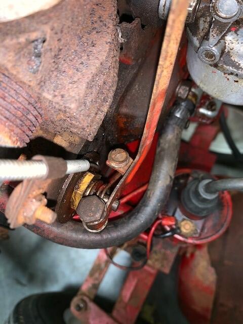

Greentored 3,220 #19 Posted December 28, 2020 Appreciate all this, guys. The cable tab on the disc is missing, so I hooked it directly into the disc. This should still function, but would be much more sensitive to throttle control, correct? @stevasaurus in your pic, the looped side of the spring is secured with that screw, maybe I have mine upside down? My loop is in the lower slot. Governor arm is tight on the shaft. @richmondred01 do these discs 'wear out', or are you saying I should replace due to the tab missing? Should there be any friction between these parts when snugged down? There is very little on this..... 1 Share this post Link to post Share on other sites
richmondred01 2,333 #20 Posted December 28, 2020 (edited) Not wear out as much as yours is broken. they need to be free, hooking them directly up to the disk will most likely cause it to bind. wheel horse has a better design with the tab opposed to the cadet version. And no the shaft shouldn’t be tight.. Edited December 28, 2020 by richmondred01 1 1 Share this post Link to post Share on other sites

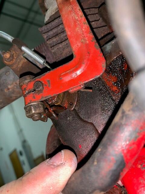

Greentored 3,220 #24 Posted February 6, 2021 Been awhile but finally got back on the 701. Started over from square one and the first thing I noticed was the governor arm movement way much more than it used to be. I set everything at this new found position and we have perfect function! However, once running, it ‘goes back’ to a position which will not allow me to pull the throttle fully open (as in, rev it up). If I shut it off and work the throttle by hand, the governor arm stops about half throttle, then will suddenly move fully as it supposed to. See the video. I am using a firm amount of pressure, you can see it stops short, then if I roll it over, it goes back to ‘normal.’ Sticky from sitting for ages? Really hope I’m not gonna get the answer I’m fearing.... IMG_2354.MOV Share this post Link to post Share on other sites
