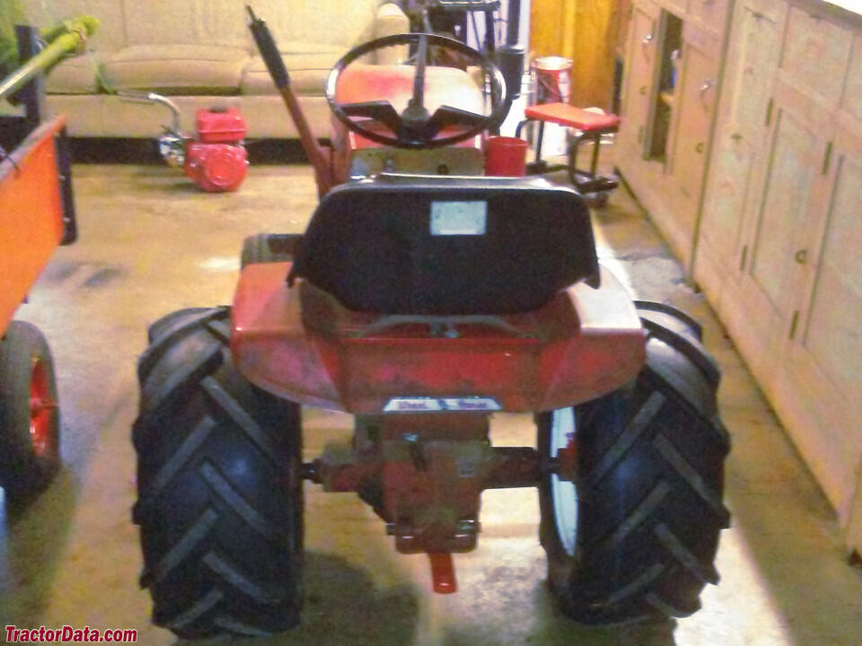

bizon 30 #86 Posted December 28, 2020 On 12/22/2020 at 1:08 PM, pullstart said: I’m one of those guys, I could look at that thing all day! Wich adjustments did you make to fit them? 1 Share this post Link to post Share on other sites
Maxwell-8 4,371 #87 Posted December 28, 2020 (edited) 5 minutes ago, bizon said: Wich adjustments did you make to fit them? You got to lift the fenders,seat. sometimes, even stretch the WH by moving the trans backwords. So a post somewhere, with a pic of the brackets. And when you run 12 inch wide tires, you will need wheel spacers. Edited December 28, 2020 by Maxwell-8 Share this post Link to post Share on other sites
ebinmaine 80,005 #88 Posted December 28, 2020 35 minutes ago, bizon said: Wich adjustments did you make to fit them? As you can imagine it depends on the tractor. On the older ones they were built with smaller wheels and tires so you need to account for things a little differently. Also, the one that @Skipper has in the pictures is a c195 I believe so the wheels and tires are larger in the first place. Maybe around 28-in diameter? On many of the Wheelhorse tractors you can't go much bigger in outside diameter but you can go infinitely wider with the correct rims. If you check out the thread on my Colossus project you'll find that I had a friend of mine build a 7-in long adapter that goes between the frame and transmission. I went with that length simply because it was the same as the width and I wanted the symmetry. Share this post Link to post Share on other sites
Pullstart 70,964 #89 Posted December 28, 2020 1 hour ago, bizon said: Wich adjustments did you make to fit them? that one is skipper’s. Check it out here.... Share this post Link to post Share on other sites
DennisThornton 4,773 #90 Posted December 28, 2020 On 12/21/2020 at 8:24 AM, Achto said: Did some one ask for big ags? I have tractors with 6-12, 23x8.50 & 23x10.50 ags on the back. All of them serve their purpose. The 26x12's pictured above are mainly for a cool factor, but the tractor does pull a plow pretty nicely with them. Care to share a brand and source? What size rims? You widen them? 1 Share this post Link to post Share on other sites
Achto 32,216 #91 Posted December 28, 2020 7 minutes ago, DennisThornton said: Care to share a brand and source? What size rims? You widen them? I'll have to look at the tires tonight to get you the brand name. I'm sure they were an purchase. The rims are 11 1/2" wide. I took four 7.5" wide rims to make them. 1 Share this post Link to post Share on other sites
DennisThornton 4,773 #92 Posted December 28, 2020 1 minute ago, Achto said: The rims are 11 1/2" wide. I took four 7.5" wide rims to make them. Holy Cow! They are neat! 1 Share this post Link to post Share on other sites
Achto 32,216 #93 Posted December 28, 2020 43 minutes ago, DennisThornton said: Holy Cow! They are neat! Here is a side view. They have a lot of dish to them. 2 1 1 Share this post Link to post Share on other sites
RandyLittrell 3,944 #94 Posted December 28, 2020 56 minutes ago, Achto said: The rims are 11 1/2" wide. I took four 7.5" wide rims to make them. I did the exact same thing for my puller I used to have. I actually put them on the tractor, fired it up and let the wheels turn while I used a cutoff wheel in a grinder. They came out almost perfect! Randy 2 Share this post Link to post Share on other sites
ebinmaine 80,005 #95 Posted December 28, 2020 25 minutes ago, Achto said: Here is a side view. They have a lot of dish to them. I like the balloon look too. 1 Share this post Link to post Share on other sites
ebinmaine 80,005 #96 Posted December 28, 2020 14 minutes ago, RandyLittrell said: I did the exact same thing for my puller I used to have. I actually put them on the tractor, fired it up and let the wheels turn while I used a cutoff wheel in a grinder. They came out almost perfect! Randy Neat idea. Powered turn and Straight cut. 2 1 Share this post Link to post Share on other sites
Achto 32,216 #97 Posted December 28, 2020 36 minutes ago, RandyLittrell said: I actually put them on the tractor, fired it up and let the wheels turn while I used a cutoff wheel in a grinder. They came out almost perfect! That's the same method that I used. Ended up with less than 1/16" difference in width from one side to the other. 2 1 Share this post Link to post Share on other sites
Pullstart 70,964 #98 Posted December 28, 2020 2 minutes ago, Achto said: That's the same method that I used. Ended up with less than 1/16" difference in width from one side to the other. Good enough for the girls Uncle Jim goes with! 4 Share this post Link to post Share on other sites
