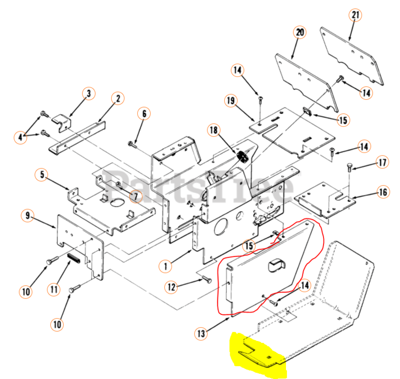

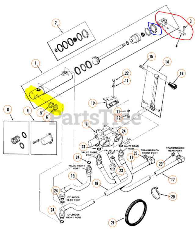

Alex175 785 #11 Posted December 18, 2020 First thing you need to do is access where the cylinder is. On the below picture you will see the side panel #13 circled in red, that needs to come off. I also highlighted the front of the foot board because the front of the cylinder is mounted to the bar that the foot board is attached to, so later on you will need to unbolt that as well to slide the cylinder off. Next step further below... The cylinder naturally has two connection points, the highlighted yellow section is where the previously mentioned rod is slid through, so you that will be the final step to taking it off. Before that you will need to remove the pin from the other end #4. I found that the cotter pins (#3) on mine were a PITA. I had to grind mine off in order to get the pin out, and then had to drill out the holes after. Hopefully yours isn't quite as stubborn. In the blue circle you will see a snap ring, this is what is removed after the cylinder is off in order to disassemble the cylinder itself to rebuild. I would also agree with @ebinmaine, while you have it apart now is the best time to replace the hoses as well if they are in need. 2 Share this post Link to post Share on other sites
