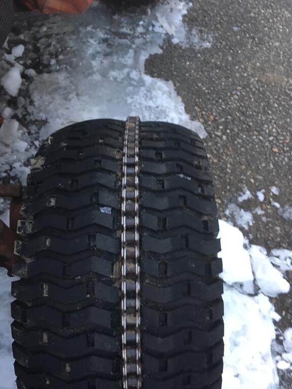

wallfish 20,679 #2 Posted December 17, 2020 35-40 lbs ? Don't know about the exact weight of them but I run #40 roller chain on the fronts without any weight for steering traction. 6 Share this post Link to post Share on other sites
briankd 833 #3 Posted December 17, 2020 17 minutes ago, wallfish said: 35-40 lbs ? Don't know about the exact weight of them but I run #40 roller chain on the fronts without any weight for steering traction. i was going to do this on my 857 i have the chain to do it but I have washer fluid in the tires makes a mess and a hassle to deflate then inflate the tires to make chain tight Share this post Link to post Share on other sites

ebinmaine 80,955 #5 Posted December 17, 2020 20 minutes ago, briankd said: i was going to do this on my 857 i have the chain to do it but I have washer fluid in the tires makes a mess and a hassle to deflate then inflate the tires to make chain tight Could you squeeze the tire enough if you Put a ratchet strap beside where you want the chain? 1 Share this post Link to post Share on other sites
briankd 833 #6 Posted December 17, 2020 Just now, ebinmaine said: Could you squeeze the tire enough if you Put a ratchet strap beside where you want the chain? i have them narrower tires and they are stiff 1 Share this post Link to post Share on other sites
ebinmaine 80,955 #7 Posted December 18, 2020 27 minutes ago, briankd said: i have them narrower tires and they are stiff Ahhh.... I know what you mean. Might be worth the time and mess to get the chains on. ...... (Said the guy who hasn't done it on his yet either) 2 Share this post Link to post Share on other sites
