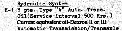

gwest_ca-(File Mod) 12,511 #2 Posted December 15, 2020 Dry capacity from the Lubrication Chart 1 1 Share this post Link to post Share on other sites
